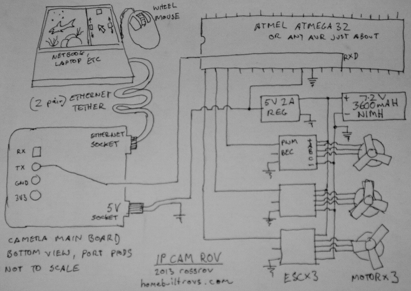

Three items needed for viewing and control:
1. IP camera ($60 purchased from large online retailer in Australia), warranty voided and two wires soldered on.
2. Microcontroller board with VERY simple program (Atmel M32 programmed in BASCOM, alternatively use Arduino or any similar) to receive serial out from the cam board and convert it to thruster speed control PWM signals.
3. PC running browser to view camera, and to send ROV commands from a simple HTML file on the PC ($200 ASUS netbook works well)
Typical command structure http://169.254.233.196/comm_write.cgi?port=0&baud=13&bytes=6&data=%ff%ff%ff%0f
Note that with this setup the only feedback I have at present is video, with the possibility of encoding very low speed data onto the alarm and mic inputs. Compass bearing etc could be displayed on LCD in edge of camera view. The camera's built-in webserver lets your PC record video, so you could have at least a visual log.

Microcontroller:
The camera's serial port sends status messages every once in a while that need to be ignored or "filtered out" by the microcontroller. These are at a higher baud rate, but the camera is forced to send at lower baud that the micro can receive properly each time you want to send something. Some dummy characters (the FFs) are sent by the control webpage to indicate the start of valid data. The program reads and discards these, then reads and uses the motor speed data. Program can be easily changed to control more than 1 motor.

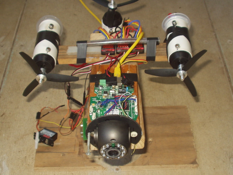

Answering my own question I decided to have a go at learning some Javascript, as plain HTML wouldn't support the mouse wheel for the vertical thruster. So far so good, I will develop further if using the mouse is a usable alternative to joystick.
Probably the biggest test will be how the Ethernet cable works underwater. Working on the "electronics bottle" and getting the ESCs/motors behaving properly for now.
For anyone interested in the IP camera approach you can copy the code below into a new notepad document and save it as cam.html and have a look by opening the document with Internet Explorer. Works in IE8, don't know about others.
Pic attached is the bench test rig. camera still works with the pan and tilt motors simply disconnected. Under the timber is an ATMEGA32 micro in a board with RS232 out that helps when getting things without an LCD going. Gets it's power from same 5V source as the camera. The micro only picks up data coming out of the camera's auxilliary port and turns that into PWM for the ESCs, nothing else.

Diagram of the electronics.
- ip cam rov diagram.jpg (243.91 KiB) Viewed 18385 times
Re: IP camera for video and control
I love it when people go old school and draw schematics, it takes me back. Do you know how to change the PWM on an Arduino Uno?

Thanks Chuck. After over 600 views on this thread nice to get a comment! Short answer is no, I don't know how to do it in Arduino - never done any C programming.
Just did a quick search a moment ago and saw people using 400Hz for their Arduino-based quadcopter ESCs, though for different reasons. There's also a fair bit on how to use timer interrupts for the Arduino too. I have only used the Trackstar 18A ESCs so far, so can't comment on whether other ESCs will be helped or indeed work at all by changing PWM to 400Hz.
