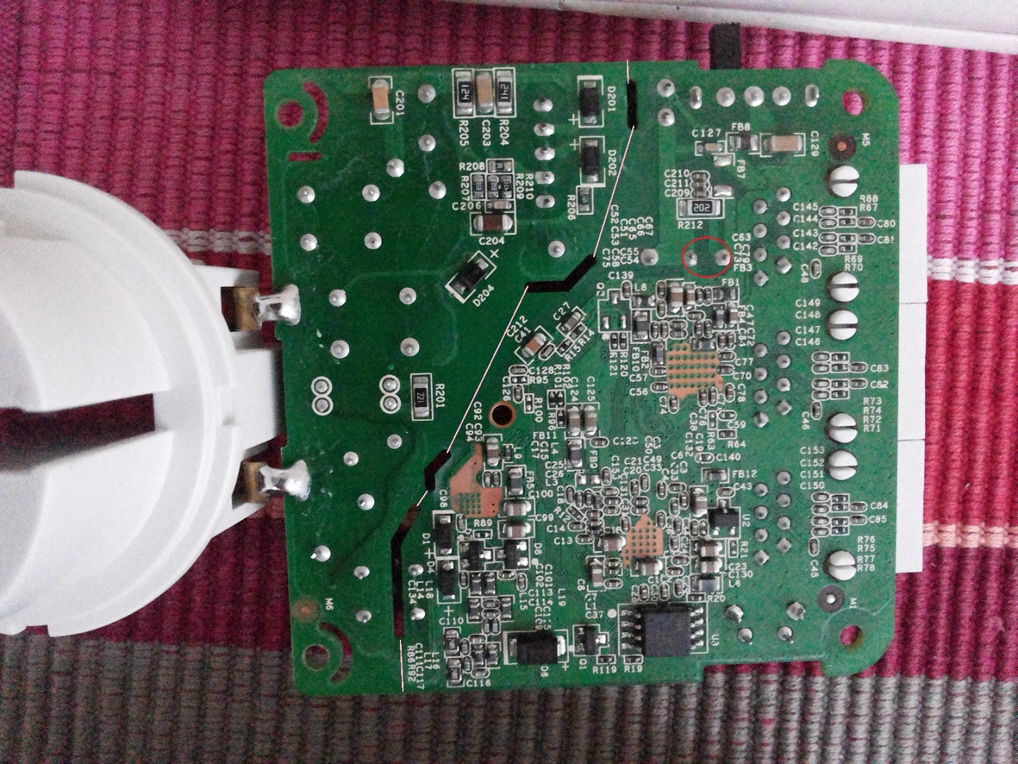

So here are the insides:
Insides with powerstuff
The two red circles are the location of the powersocket. The print is up side down to show its guts.
The blue circles are the connectors for 250V (Europe) to the main board.
The yellow square is the hart of the operation the Atheros AR7420 chipset.
detailed view
detailed view
The same unit in more detail, the purple line looks like the divider between high voltage 250 and the lower voltage stuff.
Above the red bar are markings about the board model: PI699E2.8P51A rev 1.0 the first bit is a common find on google, seems the board is rebranded a lot.
Anybody knows for certain which voltage is used by the AR chipset? I hope it is 5V that would be rather nice since I have a 5V powersource here.

Oke managed to pry it a bit more appart. And measured the voltage across the capicator I exepect I need to replace with my own accu. It is 11.8 Volt was hoping for something easy like 5V or 3.3V :(
