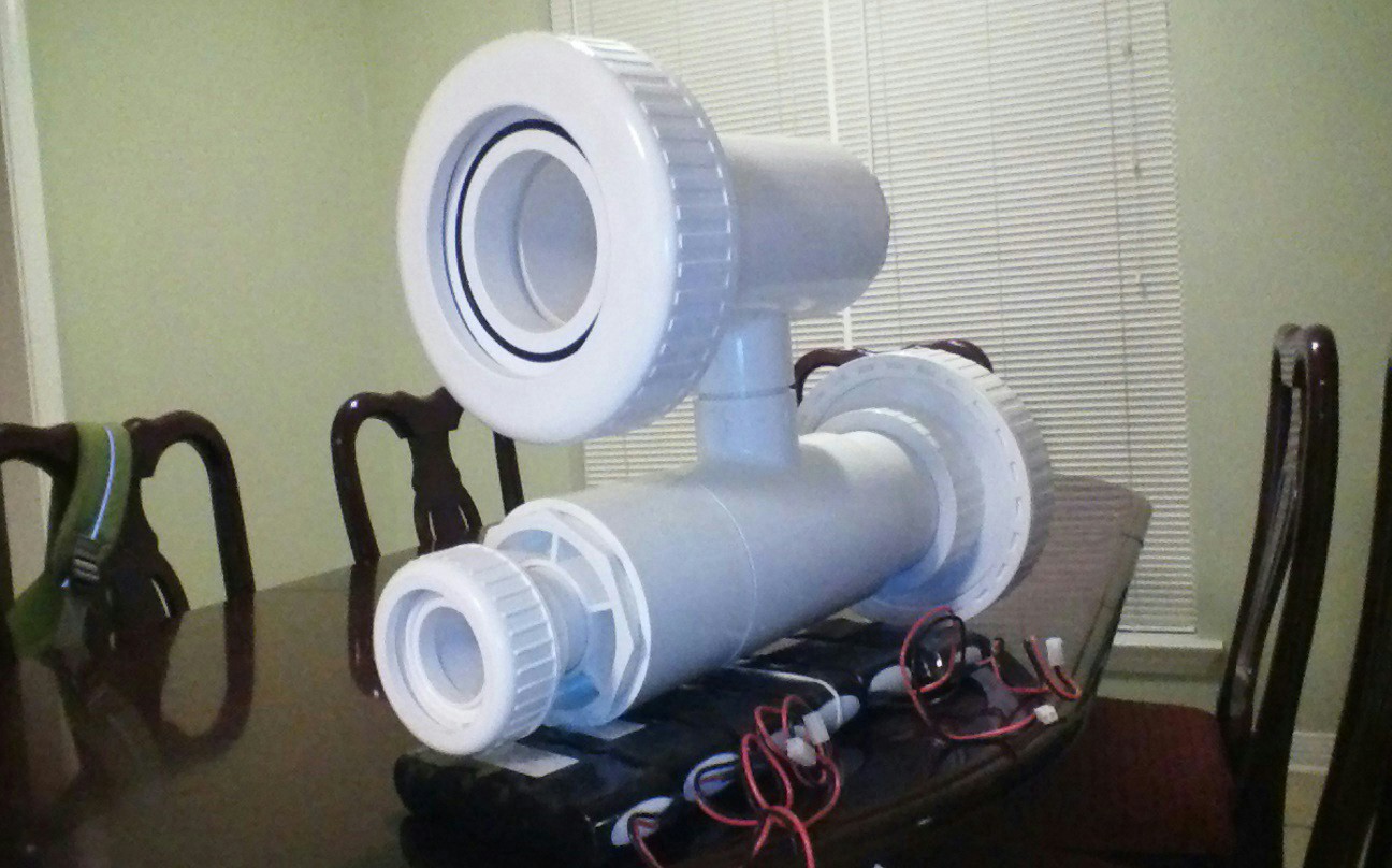

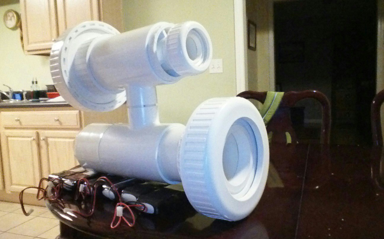

So I got my pvc in the other day and got my basic hull design mocked up...
Camera and electronics in the top, batteries and a light in the bottom.
I have yet to mock up the framework to which the thrusters will be attached.
