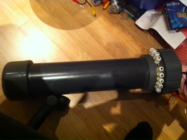

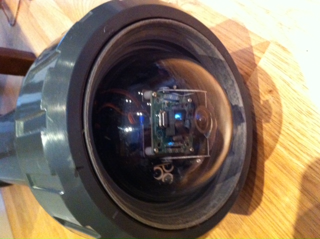

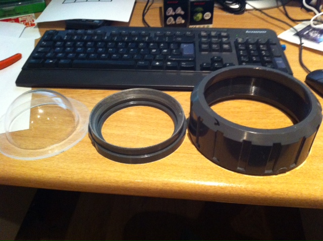

I made my WTC by using 110mm pipe with a cap on one end and a union on the other.
Link to Ahlsell product catalog: http://np.netpublicator.com/netpublication/n68201057
End cap page: 190
Union page: 188
Pipe page 194

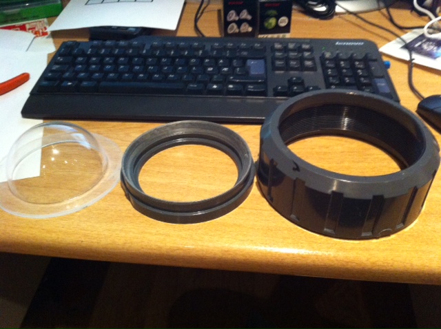

I have bought a plastic dome from http://www.ukplasticfabrication.co.uk/A ... domes.html

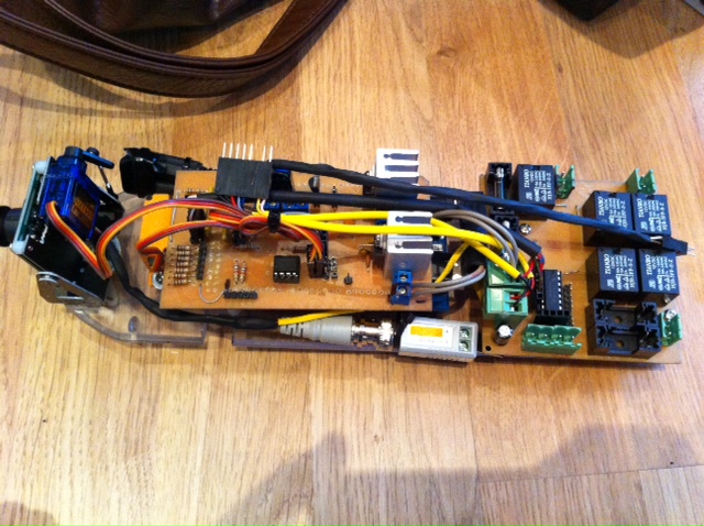

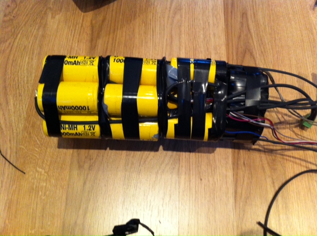

In my WTC I have the following equipment:
Arduino Mega with homemade overlay card
Relay and fuse board

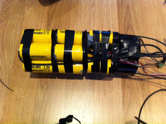

20 ea 1,2V D-cell Ni-MH battery
10 ea 1,2v C-cell Ni-MH battery
camera and two servos for control of camera

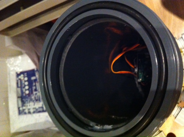

Lets see if i get you right, you have glued the O-ring part of the union on the 110mm pipe, then got a dome fitting the unio o-ring part and threaded the "nut" over it. About depth you got any "info" again? :P
And the back end is that also possible to open? How did you e.g. do the cable exits and light? :)

I have only tested it to 13 meter by just lower it 13 meter in water. I have not found a place near me where there is deeper water. That was before I drilled holes for the connectors. I have not tested it after. But I have tested the connectors to 3 bar without any leak Was not able to test to highet pressure since the water pressure is only 3 bar where I live.
Back end is not possible to open. My plan is to push the batteries in and then connect all the cables through the connectors. If I need to remove the battery pack then I have to remove all the cables.
Picture of the union with all parts:
bilde 3.JPG (114.56 KiB) Viewed 11528 times
The relays shown on picture is not for thruster and/or light control, they are to turn ROV on/off and to change where the power from the different battery is going to.
Board on the ballast housing have mosfet for controlling thrusters(connected to a digital port on the Arduino Mega, so these are only on off) and light control with use of PWM

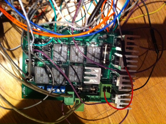

Picture of relay board for the ballast, thruster and light control.

Just a quick question before i leave (I'll read rest of the post tomorrow just saw the images now) but do i really need that much cooling for the mosfets at 3.5-4 amp / 12v ?
Re: Need WTC Ideas!
Posted: Jan 26th, 2013, 12:40 pm
by Kjetil
About the cooling. I do not know. I have tested them when running the bilge pumps with out any load. The mosfets did not get hot. The only reason why I have used these is since this is the only ones I had available.
