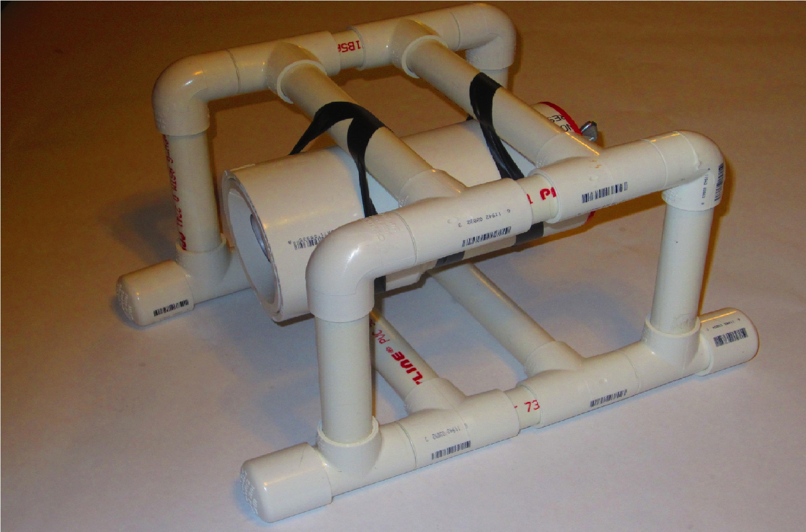

This is my first rov project and I'm very excited! this is really all i have so far, but i'm going to add motors and flotation. for thrusters I'm using 4 500gph bilge pump cartridges. and for the cameras im using a radio shack web cam. by the way the "d" in D-ROV is short for "W" for wilder's rov.

- reality. the tape is only temporary while i figure out where to mount every thing

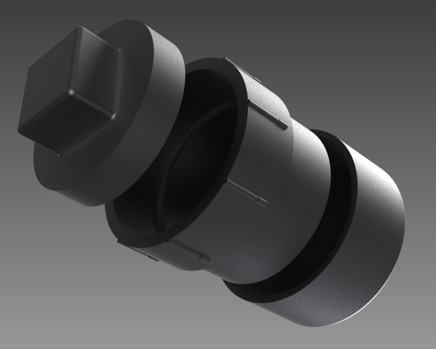

- the autocaded model of my finished rov (hopefully)

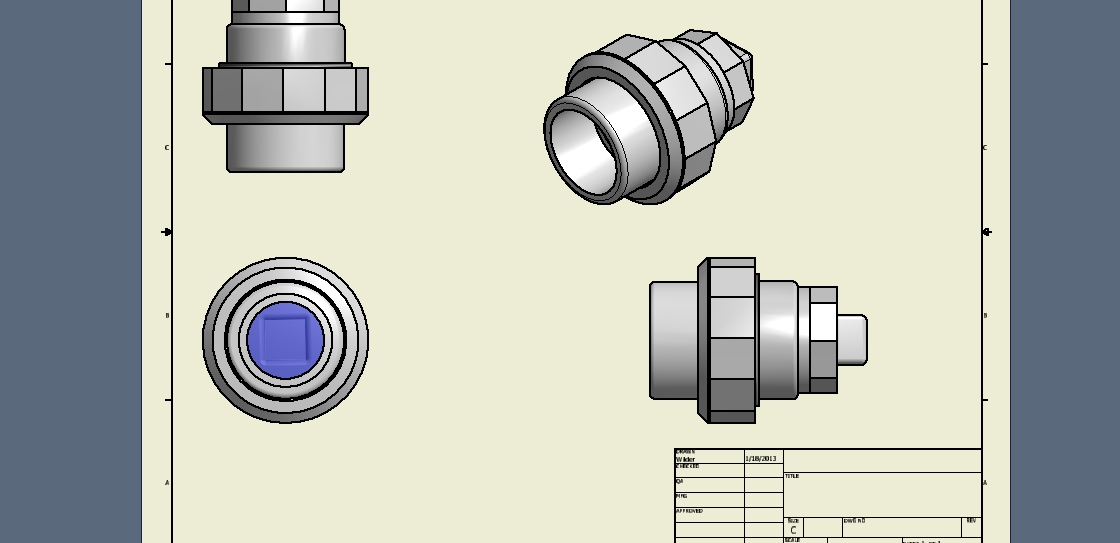

I have redesigned the camera housing because my original was too leaky. I don't have any pictures yet but I do have a PDF drawing file that is pretty applicable for any housing.
camera housing 2.pdf- (232.51 KiB) Downloaded 918 times

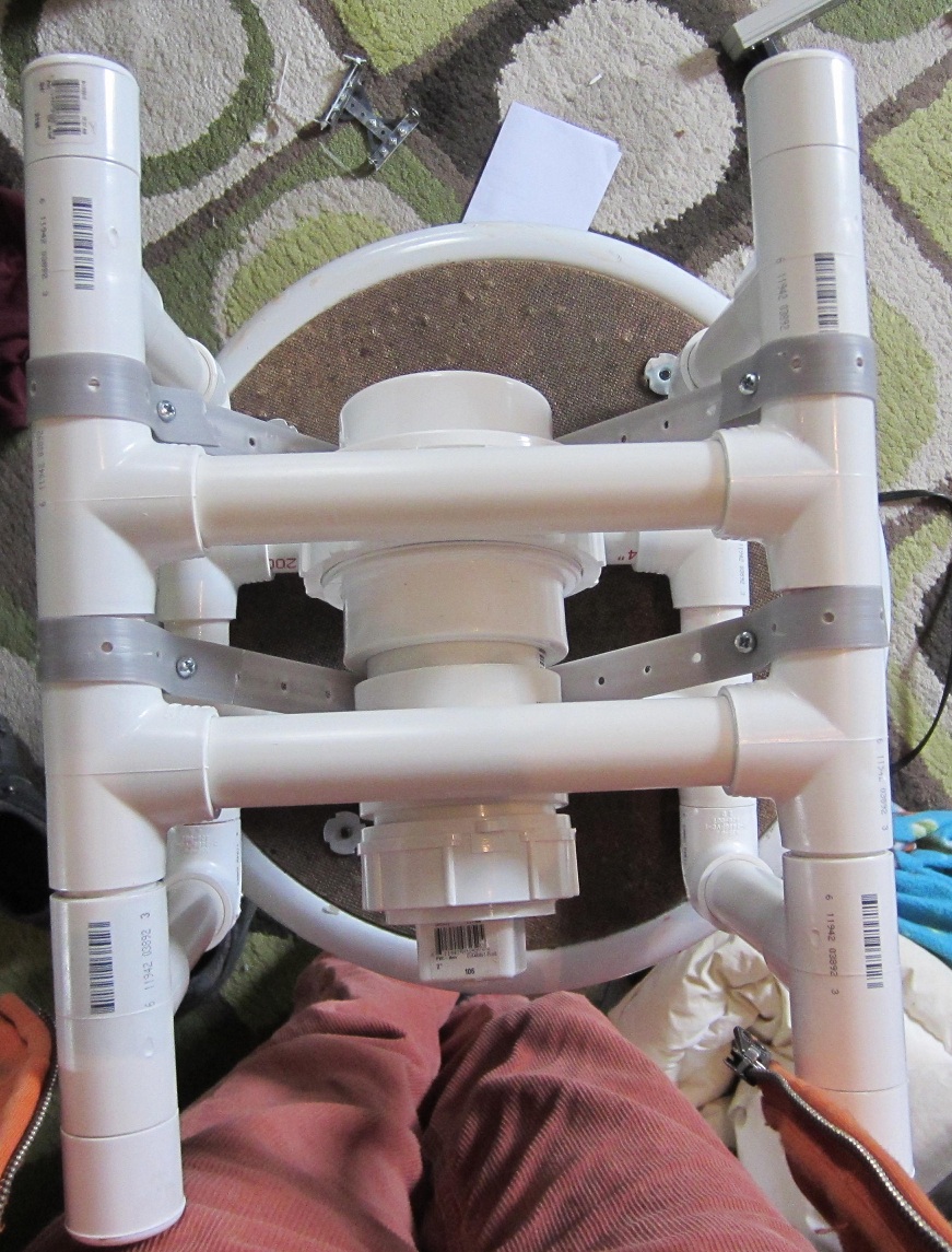

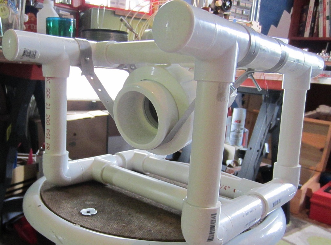

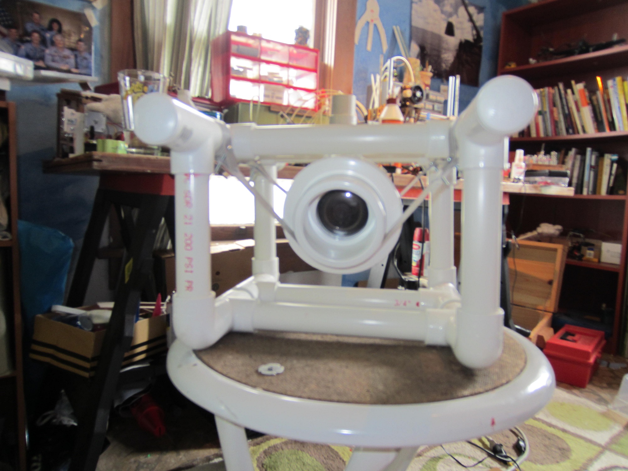

I've changed the orientation of the frame a bit, and changed the housing. the problem with the last housing was that it leaked a lot around the hatch. So This should be better. Hopefully. I've also been working on motors a little (viewtopic.php?f=3&t=1050)
Another thing that I have discovered is the use of Shapelock plastic for my ROV. It heats up and becomes mold-able and then cools and hardens. it really is very nice, especially for water proofing.
Also, I have a friend who is very good at electronics and programming so we decided that we could use serial communication to control the ROV opposed to using switches. It would be excellent to be able to do this in order to keep the tether down to a reasonable size.
