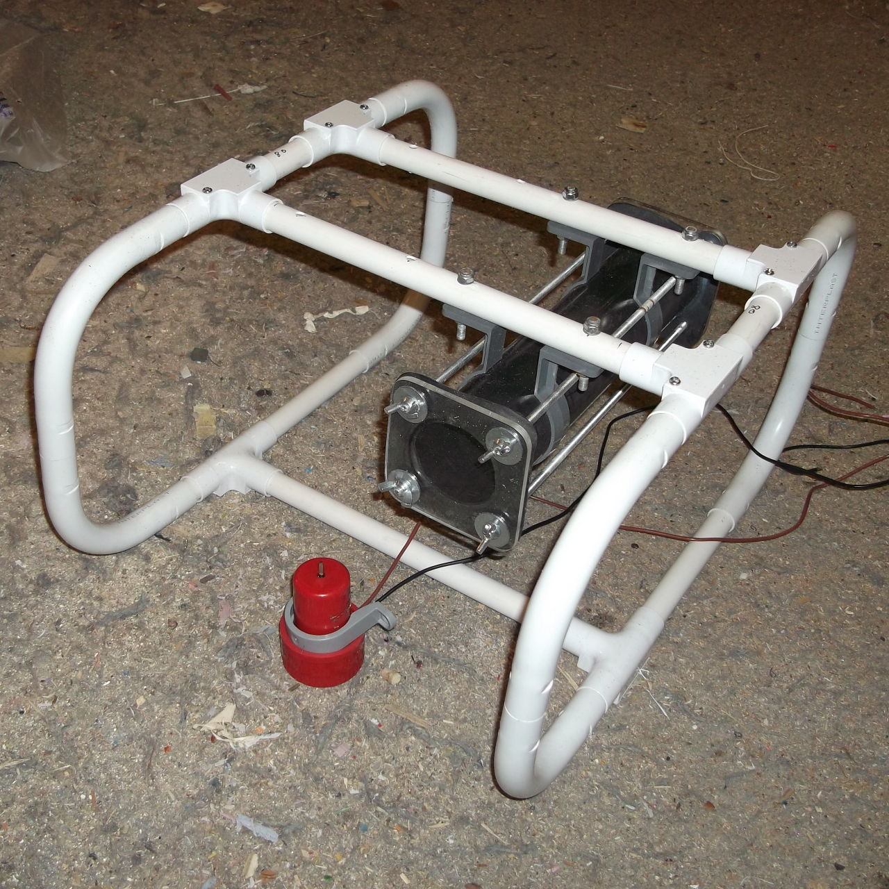

First project is underway. I've opted for:
Construction: PVC electrical trunking and plumbing parts
Propoulsion: 3x propeller converted 350GPH bilge pumps
Control: Wii nunchuk.
Processor: Microchip PIC or Arduino Mega
Max depth: Initially targeting 5m depth.
20121216 uROV1 01.JPG (354.82 KiB) Viewed 12778 times
You can see the shape of the chassis. The black tube at the top is one of two. They are watertight with acrylic sheets clamped to them. Inside, I plan on putting a USB camera in one and a 50W light in the other. For now they also form the most part of the buoyancy. One part converted motor sits in the foreground.
After a rough calculation, buoyancy is going to be a problem. I reckon my configuration weighs around 2.8kg and my buoyancy compartments displace only 1.6kg of water. I've assumed no buoyancy from the PVC chassis: I've read many posts confirming my suspicion that these tubes are virtually impossible to make watertight. I plan on filling them with expanding foam. Has this been tried?

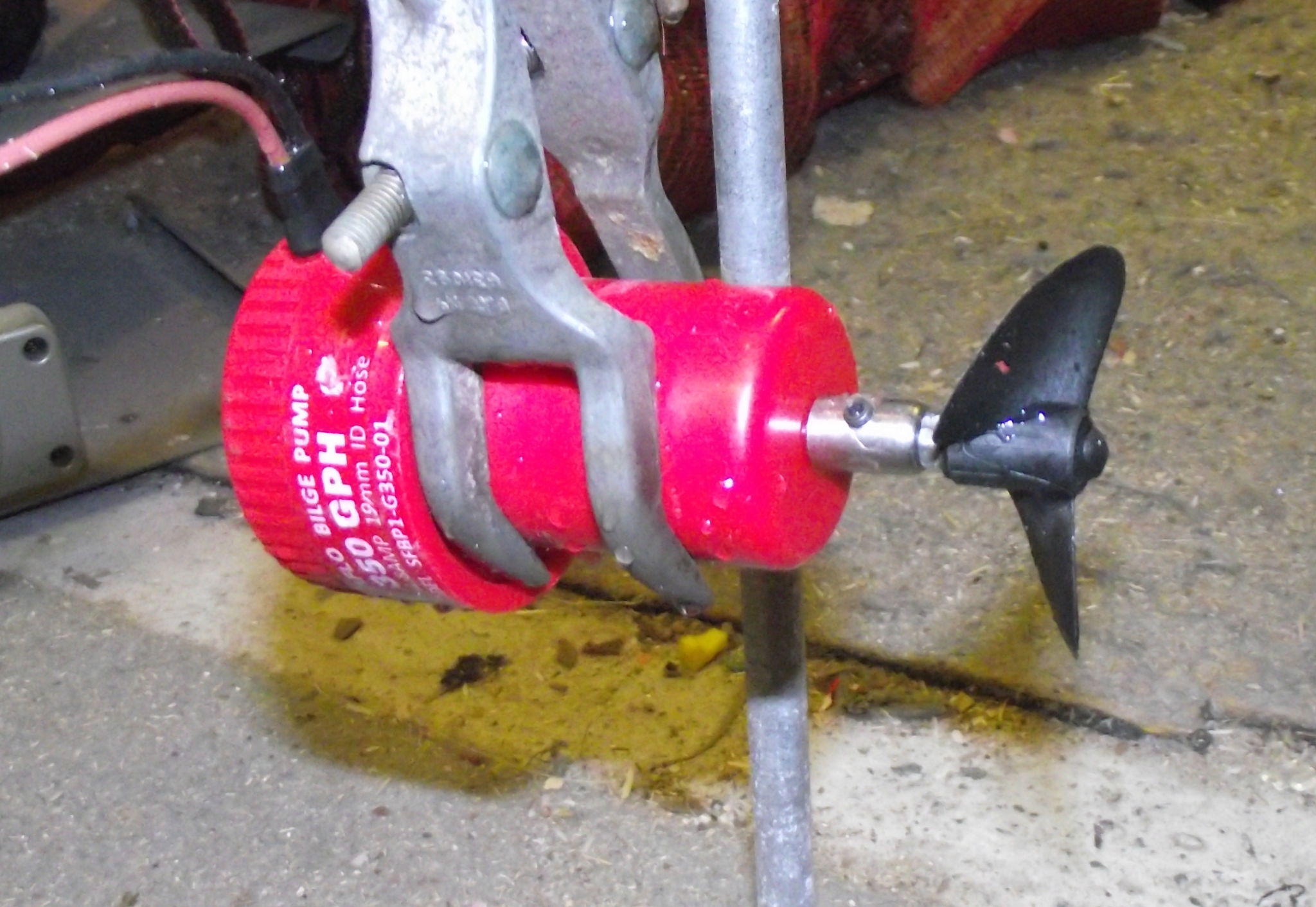

I have some test data from my 350GPH Seaflo bilge pumps converted with 50mm two blade props.

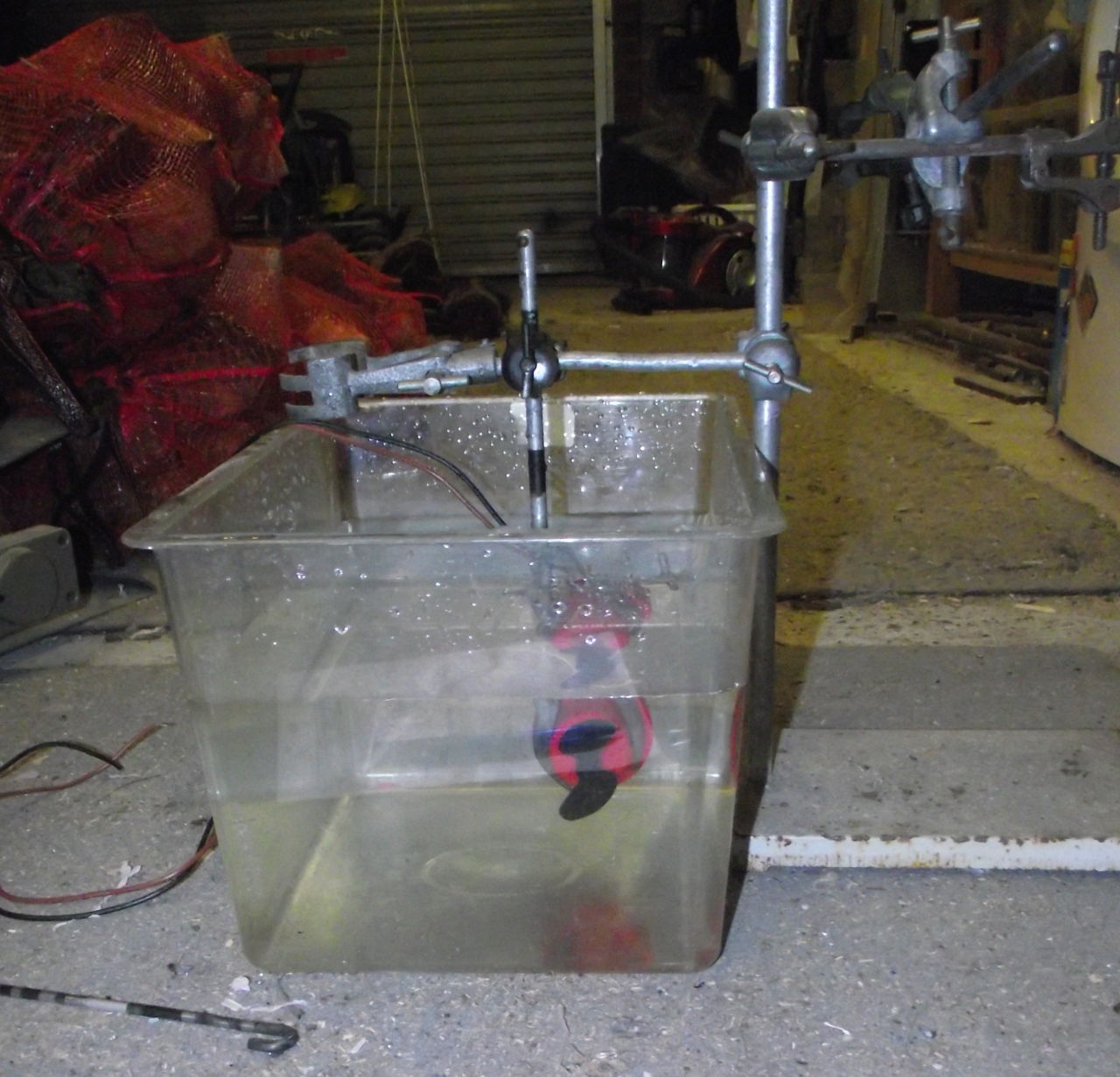

I used a test rig as close as I could to that seen elsewhere.

The current appears to increase quite linearly with the Voltage, although the reverse current is typically about 100mA lower.
Assuming the relationship between voltage and thrust is linear, forward thrust (in g) seems to be around 8 times the Voltage and reverse thrust seems to be around 6 times the voltage (assuming all the required current is there).
Thrust for Power.JPG (41.12 KiB) Viewed 12743 times
It's difficult to be upset with figures like that.
Max measured current was 1150mA at 14V, but that was sucking down a lot of air in my little test tank. The pump was originally rated at 1800mA.

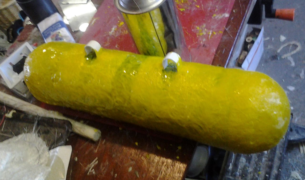

That means I need bucketloads more buyoancy. The buoyancy chambers I made are fibreglass filled with expanding foam. There are two of these. Each weights 450g and displaces 3.1L.

Two of the above canisters made in fibreglass. They each displace 3833g of water and their mass 700g each. That's a truckload of bouyancy.
