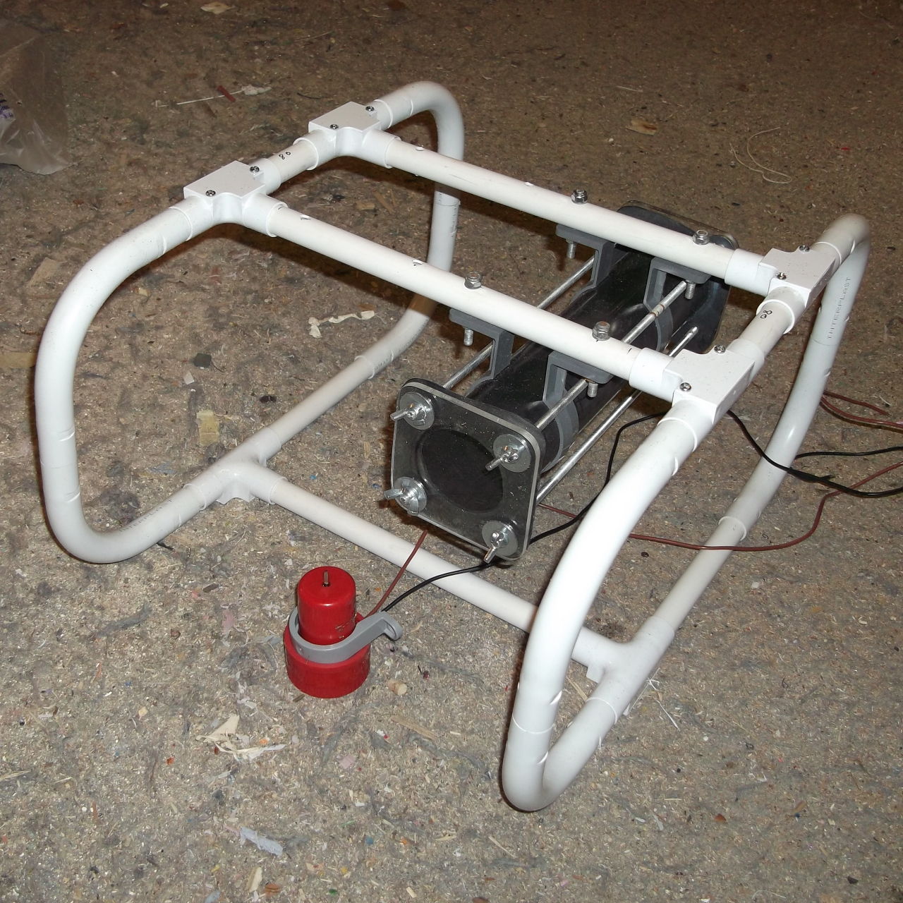

You can see the shape of the chassis. The black tube at the top is one of two. They are watertight with acrylic sheets clamped to them. Inside, I plan on putting a USB camera in one and a 50W light in the other. For now they also form the most part of the buoyancy. One part converted motor sits in the foreground.
After a rough calculation, buoyancy is going to be a problem. I reckon my configuration weighs around 2.8kg and my buoyancy compartments displace only 1.6kg of water. I've assumed no buoyancy from the PVC chassis: I've read many posts confirming my suspicion that these tubes are virtually impossible to make watertight. I plan on filling them with expanding foam. Has this been tried?

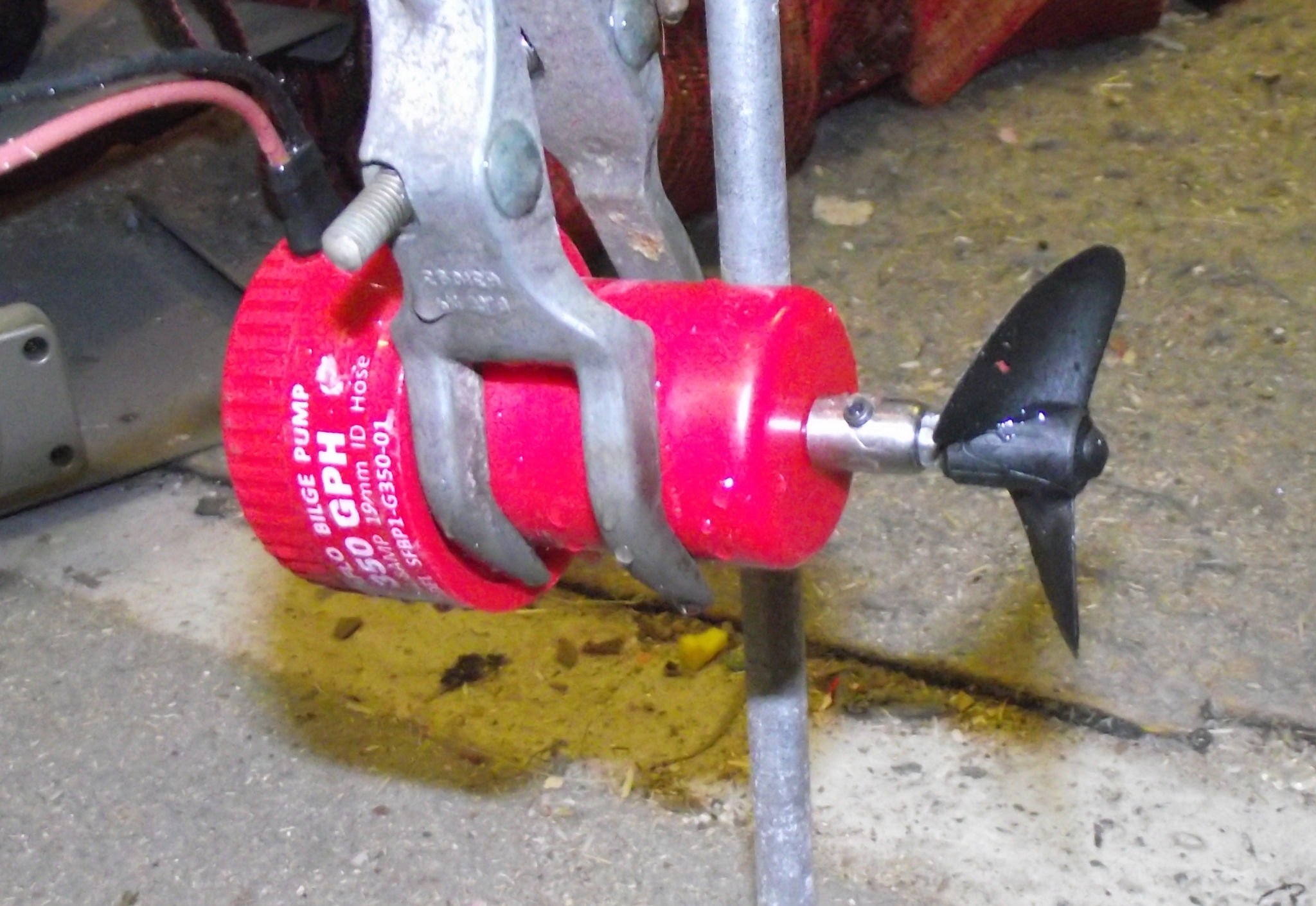

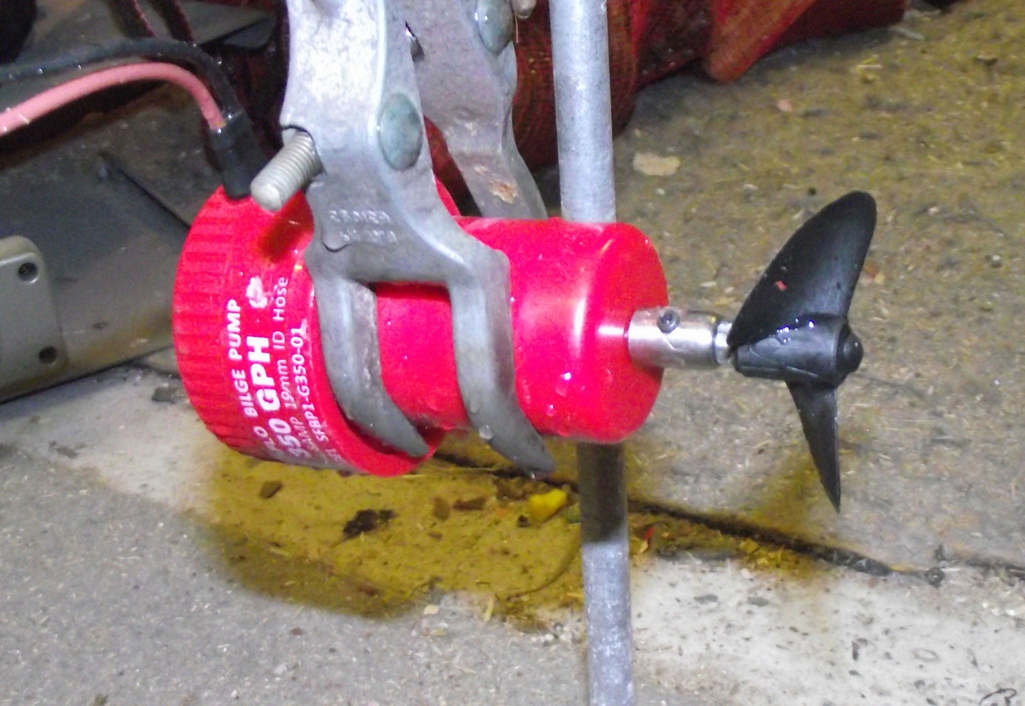

I have some test data from my 350GPH Seaflo bilge pumps converted with 50mm two blade props.
20121217 Motor.JPG (323.69 KiB) Viewed 12732 times

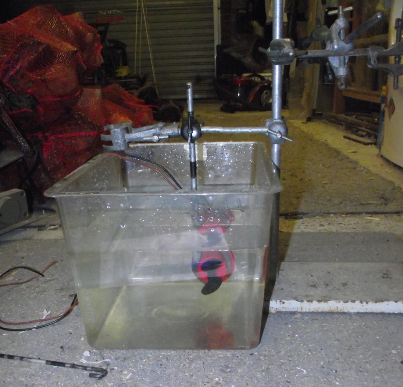

I used a test rig as close as I could to that seen elsewhere.
20121217 Motor Test.JPG (204.28 KiB) Viewed 12732 times

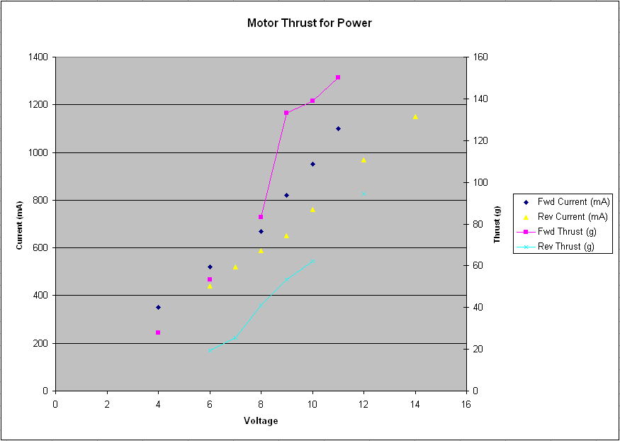

The current appears to increase quite linearly with the Voltage, although the reverse current is typically about 100mA lower.
Assuming the relationship between voltage and thrust is linear, forward thrust (in g) seems to be around 8 times the Voltage and reverse thrust seems to be around 6 times the voltage (assuming all the required current is there).
Thrust for Power.JPG (41.12 KiB) Viewed 12732 times
It's difficult to be upset with figures like that.
Max measured current was 1150mA at 14V, but that was sucking down a lot of air in my little test tank. The pump was originally rated at 1800mA.

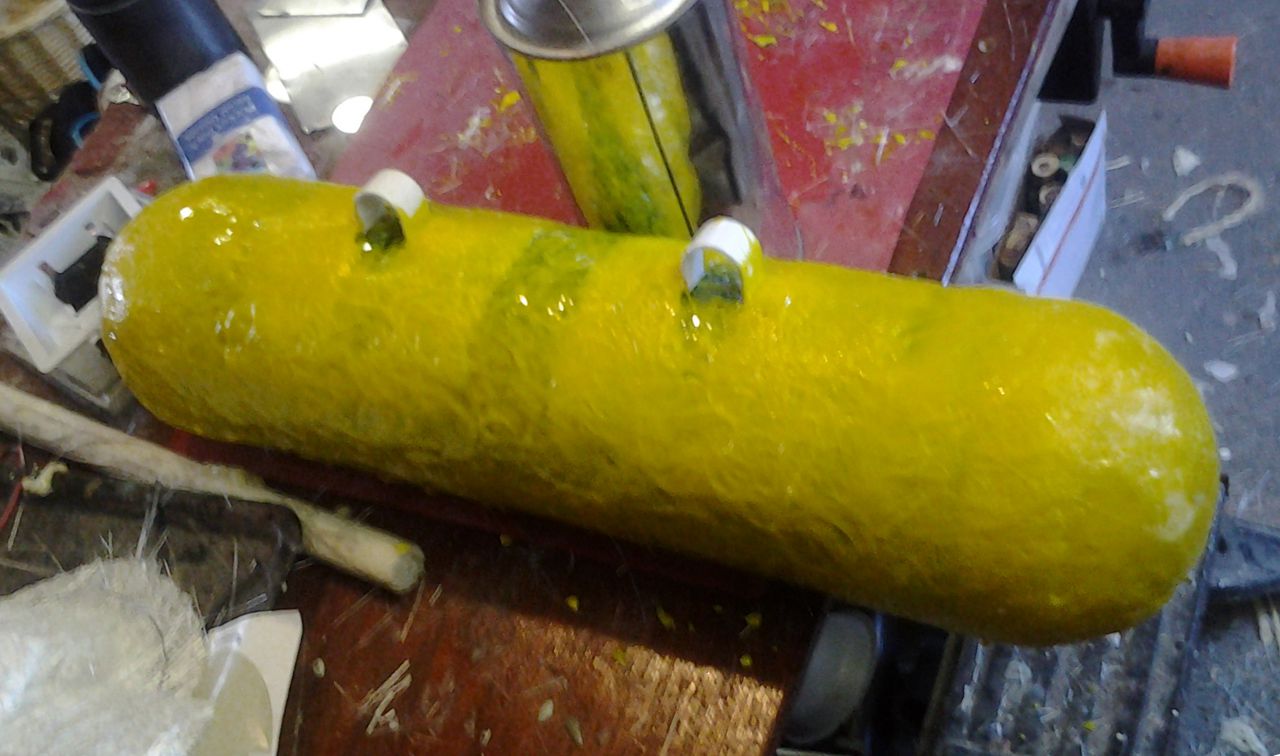

I decided I was going to be more adventurous and go deeper, but didn't want to run 10 Amp cables in the umbilical. Pretty sure this means I've got to submerse the battery, too. I'm thinking a couple of sealed lead acid home alarm batteries ought to suffice.

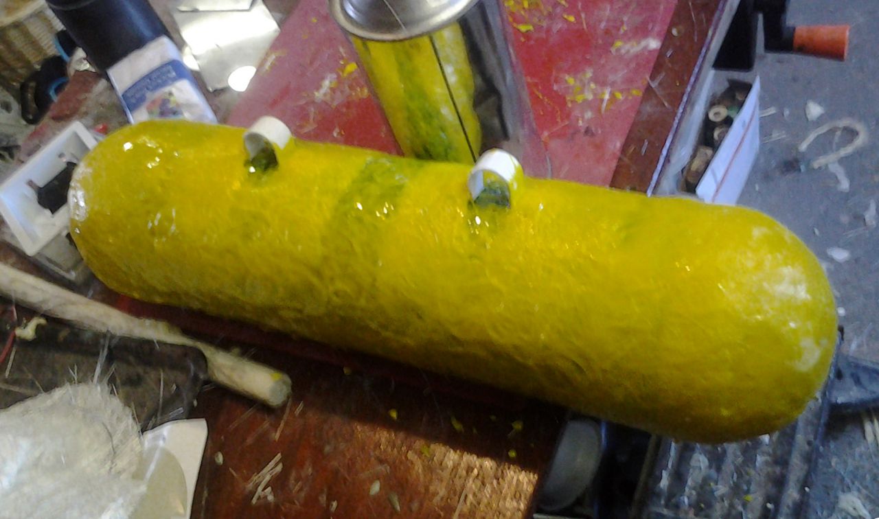

That means I need bucketloads more buyoancy. The buoyancy chambers I made are fibreglass filled with expanding foam. There are two of these. Each weights 450g and displaces 3.1L.

Two of the above canisters made in fibreglass. They each displace 3833g of water and their mass 700g each. That's a truckload of bouyancy.
