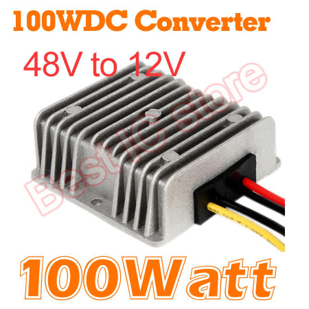

1500 to 2000 Watt voltage regulator at 40 Amps will be quite large. If your 48V DC supply is top side you will have to calculate the voltage drop, depending on the conductor size used and tether length. Lets say for example you end up after losses with 40VDC Then I suppose you could use these DC to DC converters on the ROV, one per thruster to get your optimal voltage to each motor. http://www.ebay.com/itm/DC-DC-Converter ... 56438121a9
