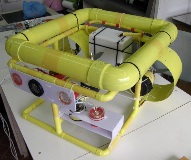

Some things about the ‘hardware’:
- Copper-pipe Ø22mm frame
- PVC-pipe Ø75mm buoy
- Three L1600gph Johnson Heavy-duty bilge pumps (12V/24V)
- Two 8x4 APC airplane model props for Left/Right motors
- One 9x5 APC airplane model prop for Lift
- 12V Motorcycle Battery (14Ah) mounted on the frame
- 6 DPDT-relay control system for motor control
- Two 650TVL HD 1/3'' SHARP CCD Starlight 0.001Lux Color Board Camera with a 2.1mm lens
- Three LED headlights
- 100m tether consisting of two 8x0.22mm2 (24 AWG) cables, one for cameras/lights and one for relay control.
- Overall dimensions: 65cm x 50cm x 35cm
- Weight: Approx. 15kg
The design is quite robust, but I preferred to pot everything in order to be as waterproof as possible. It is not the best practice I know. If something goes wrong it is difficult to replace, but during field work I have to be as ‘damage-proof’ as possible.
The battery is potted in wax along with the fuses for the motors, in order to be easily accessible for charging or replacement of the fuses. Everything else (cameras, lights, relays) is permanently potted in ‘liquid glass’ a transparent epoxy material. All boxes and the camera/lights bases are made from plexi-glass. The control box is still quite primitive, but as I had it almost ready from the first ROV I decided to make some adjustments and not build a new one.

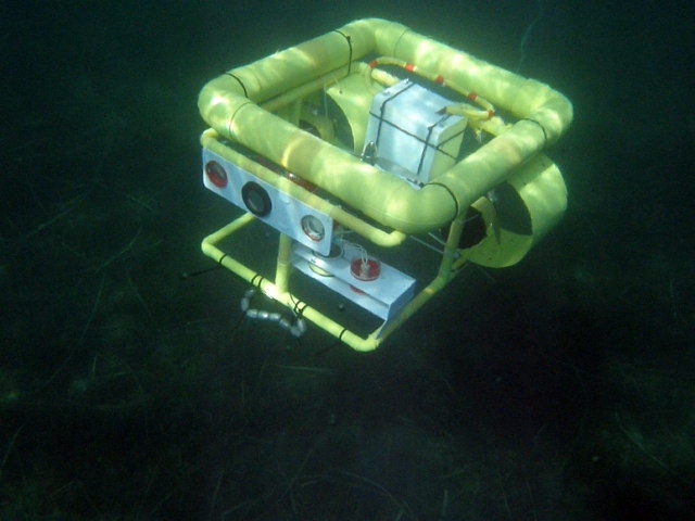

The first test dive was great. I will also post two small videos in the ‘Mission Footage’ section of the forum.

- At last in the water!
- Triton_first_dive.jpg (153.73 KiB) Viewed 5584 times
- Triton assembled and ready to dive!
- Triton.jpg (116.24 KiB) Viewed 5584 times

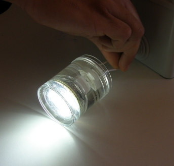

- Potted LED light test...
- ROV_Headlight.jpg (63.72 KiB) Viewed 5584 times

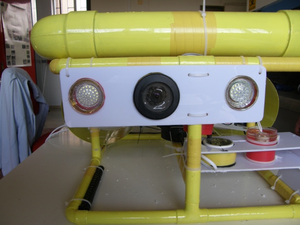

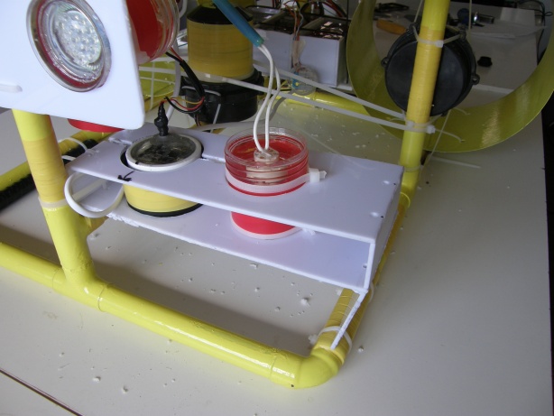

- Front camera and lights
- Front_camera.jpg (81.34 KiB) Viewed 5584 times
- The camera and light for seabed view
- Down_camera.jpg (81.25 KiB) Viewed 5584 times

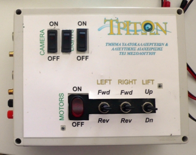

- The control box
- Control_box.jpg (93.12 KiB) Viewed 5584 times

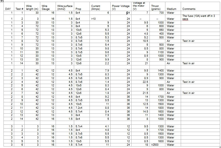

The props are fine. The bollard test I made gave about 1.6kg of force for each motor which is quite adequate to manoeuvre it.
I made a lot of tests during the summer and you can see my results in the file (I can't attach excel and word files in the forum, is this normal?).
I had good results with the 8x4 props when chopped by 1cm on each side.
I haven't chopped the mounted ones yet, since the differences were not so high.
I'm planning to test 2 things in the near future:
1. Make some speed measurements to see how fast I can move underwater
2. Try some boat props to compare with the plane props.
I'm planning to push it a little to see its limits.
- Bollard test data
- Bollard_Test.jpg (272.23 KiB) Viewed 5564 times

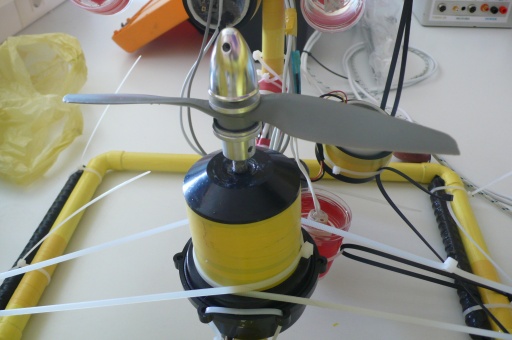

Great info! Lots of tests!
Any issues with the prop adapters coming loose when spinning "backwards?" Have you secured these using any sort of glue or thread lock?
Ryan "KR2_Diving"
Ryan "KR2_Diving"
Re: Triton Project
Yeap! They are getting loose sometimes on reverse, even with 2 nuts on the adapter. Haven't yet fixed the problem permanently, but it seems that if you tighten the 2 nuts and the front part of the adapter it's ok. I'm planning to try some "secure" nuts (these with the plastic coating inside.
Alex (Triton)
