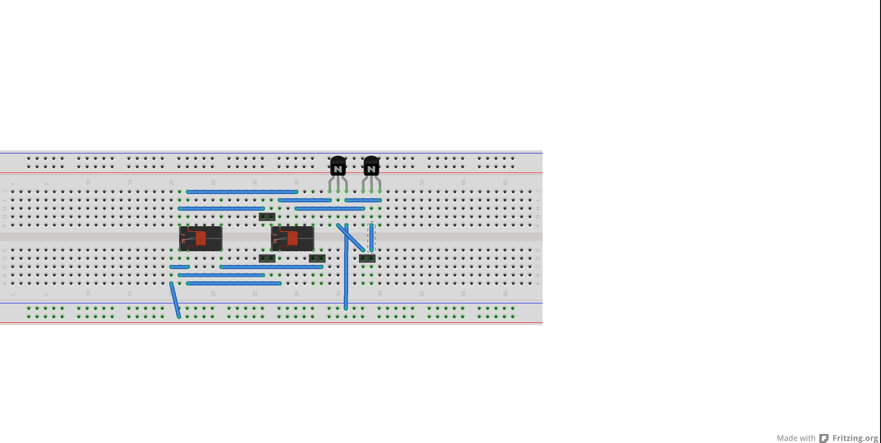

I would suggest a circuit like this, which is what i'm going to use.
sorry for the bad wiring (first time using it).
- camera selector.jpg (573.46 KiB) Viewed 10453 times

Re: Two cameras wired through relays??
Thanks.
My limited knowledge makes it hard for me to follow the breadboard layout but i can take it into someone i guess..
Does this circuit, cut the power, cut the video feed or cut both?
Thanks
Darren
Thanks
Darren
it is designed to switch power or video but it depends on how you wire it really, i'm hoping to switch the video feed with it
