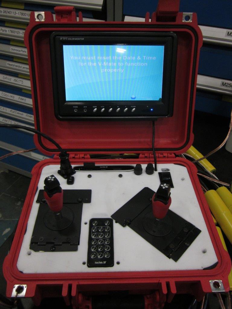

I had a hard time trying to find an enclosure big enough to house the joysticks but also not obnoxiously huge. I was running out of time and realized a large 3-ring binder was just big enough to hold them. A little rough, but it worked!

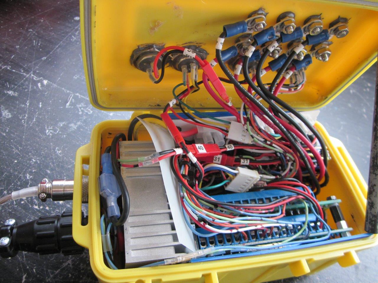

For electronics, I decided to just bite the bullet and go with relays in a project box covered in wax. I was too ambitious the first time and once the relays are working, you don't have to mess with them much anyway.

Overall this setup worked pretty well except I left it sit in the sun too long one day and some of the wax melted out. I didn't notice this until later but enough had escaped that water was able to get into the relays.

Lucas, I absolutley LOVE your control box!!!!! Simply GENIUS :D

Wiring up the relay box (again!)

Unfortunately something happened with the electronics again after this run - guessing one of the relays heated up enough to melt some wax and let water in, or something similar. I lost motivation but after visiting there again a couple weeks ago the bug hit me again! Think I'm done with this control method though, already dusted off the Arduinos and PS2 controller :)
