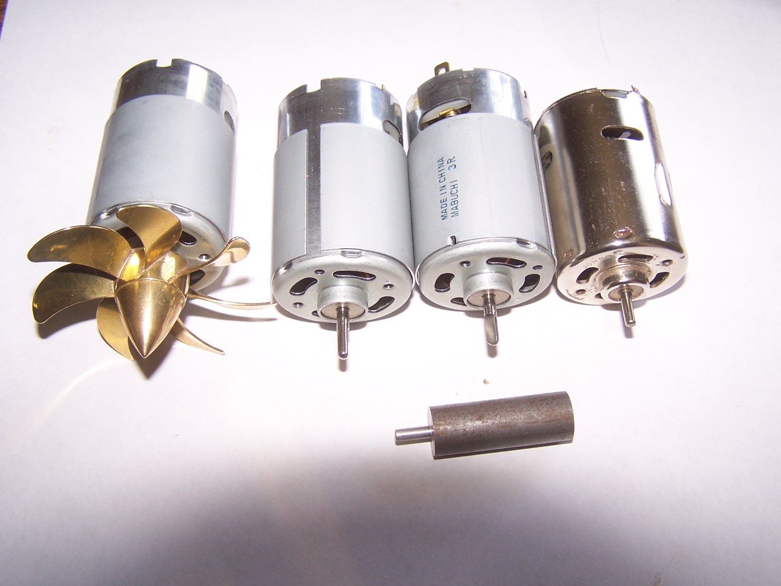

Well i got some stuff in the mail the other day for my thruster build, 3 550 motors and a propeller. I probably screwed up with my choice of propellers, i thought it was a little different when I saw it online, but after seeing it in person I dont think its what im looking for. the other problem is that the shaft is a little too loose in a .125" reamed hole so I am going to order a .001" under reamer and try it. If that doent work then ill make it up as a collet type coupling (time consuming to make it that way though). These thrusters will be a sealed design and should hit 500' with out issues. Ill post more as I get things done. Anyway here is a pic of the 550 motors and a 540 motor from an r/c car for size comparison.

Cool looking props. You should do some wet testing when you get the prop adapters done to see what kind of thrust they will produce.

Motors look pretty sweet...prop does look a little too beefy from my perspective but I am no expert.
