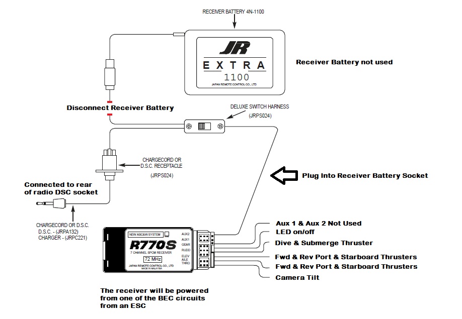

Looking at your video, and If I understand your concept, your going to leave the receiver topside and send your signals on cat5 to the ESC's below? That will work but on a lot of extra wires. By using just the PPM data stream and sending it to a receiver onboard everything is controlled over a single twisted pair. Smaller tether = less weight and less drag.
There are two idea's for you to look at.
Option 1 - tether must be connected via the trainer plug ( if your radio has one ) or DSC ( Direct Servo Control ) and use the PPM data to drive a receiver that is DSC capable onboard. Option 2 - Use a coax to extend the TX signal down to the ROV. Never tried Option 2 personally. If you search the forums for RC control you will find all the information on how it's been done.

You are correct. On a single CAT5e you can send your control data down to the ROV on one pair, your video feed to the surface on another pair. The remaining conductors could be used to feed audio to the surface to monitor a leak sensor on board or sensor data etc..
A lot of the older computer radios that operated on 72MhZ came equiped with a DSC port on the Tx and the receivers were designed to link with a DSC connection. DSC was incorporated to eliminate possible interference with other fliers on the field if you were testing your servos, flaps, throtle and other controls on the ground. It actually by passes the RF portion of the radio completely. All the newer 2.4GhZ radios today do not cause interference to other operators so most do not have a "DSC port".
On another thread we got way off topic but if you read through the thread there is a little more detail on DSC setup.

Cat 5 is more than enough for conductor to drive a PPM signal to the receiver on the ROV. To get the stick inputs on your radio to do what you want for motor control its all in the radio programming menus.
For example in my JR XP6102 72MHZ FM TX using DSC this was the basic programming parameters.
I will explain it best I can. I went into the Mix menu and for MX1 selected AIL to ELE. I set AIL to -100% ELE to -100% SW was set to ALWAYS ON
Then in the mix menu for MX2 I selected ELE to AIL and set ELE +100% and AIL +100% SW was set to ALWAYS ON.
With these settings the AIL channel mimics the ELE channel so pushing the stick up, both motors will run forward, pushing the stick down both motors run in reverse.
Now MX2 being programmed exactly opposite in settings as MX1 when pushing right on the stick the left motor runs forward and right motor in reverse turning the ROV right. Stick to the left makes the right motor run forward and the left motor run in reverse turning the ROV to the left.
Another cool thing when going in a forward direction and for some reason i.e. water current is present and I am drifting to the left or right, I can feather the control either right or left slightly to apply more speed to one or the other thrusters compensating for drifting. When reversing the controls it also allow you to feather left or right with the same results. Each stick movment on any of four diagonal positions operate the motors independantly either forward or reverse.
