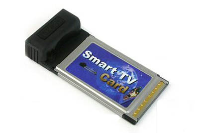

To plug the camera into the laptop you just need a video capture device. I use a Smart TV PCMCIA Video Capture Card (seen below) but the device is going to depend on your laptop. I think most of the newer capture devices are USB anyway so they should work with most laptops. If your camera has RCA plugs it should connect up to most Capture devices but if your camera uses something like BNC connections you may need to find a adapter to make the connections. Most of the capture cards should come with the software to record (which may vary) but I use WinDVR.

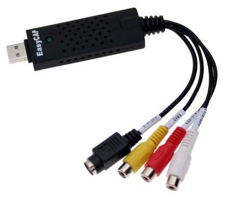

This is an example of a USB capture device with RCA connections

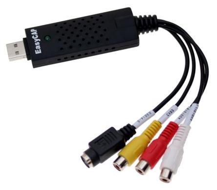

I'm using the EasyCAP software.
Finding the driver for windows 7 was a bit of a hassle, but other than that, it's very, very simple to use.

I have been looking at that EasyCAP thing too, and I found a pretty good video on installing the drivers correctly:
http://www.youtube.com/watch?v=Zbdz4HNt ... re=related
Hope this helps, I haven't tried it yet..
cheers
*edit*
I did get this to work on windows 7!
