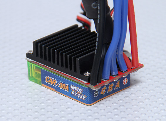

Hi nomore, Hobby King also has these...
http://www.hobbyking.com/hobbyking/stor ... duct=11742
These are the ones I just purchased for my 750kv brushless outrunners. $14.99 ea and 10 in stock.

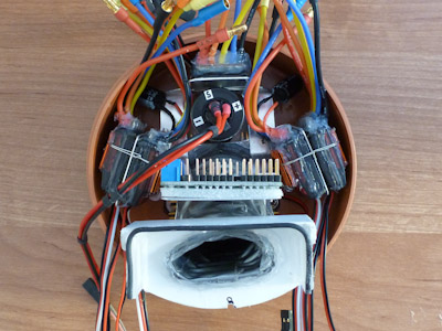

MaPe
Posts: 3
Joined: Aug 8th, 2011, 8:22 pm
Re: New thrusters with ducted fan unit
Post by MaPe »
Also this one has reverse. http://www.hobbyking.com/hobbyking/stor ... _ESC_.html. Already tested.
001 P1010514001.jpg (96.94 KiB) Viewed 7809 times
bikerbones1968
Posts: 374
Post by bikerbones1968 »
nomore wrote:Thanks for the reply. The reason why I kind of skipped that ESC is the lack of reverse programming information. If if goes straight into reverse or if you need to brake first, then go back to neutral, and then reverse. Like some car ESC's works.
But when I check the comments I see that this question has been asked and answered, but perhaps you could confirm this as well? :)
Nomore, the esc's arrived today. They are completely programable and only a quick pause from full forward to full reverse. I had to change the default reverse setting to 100% it was 50% by default and I reduced the brake force also. It was easy to program with the "key" button from the manual I downloaded.

bikerbones1968
Posts: 374
Nomore, when you get the ESC's also program the running mode to the mode "two" It comes default mode "two 2" and requires a brake, full stop, then neutral, before reverse. In mode "two" it quickly goes from forward to reverse witha milisec pause.
