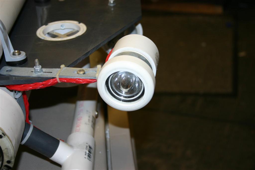

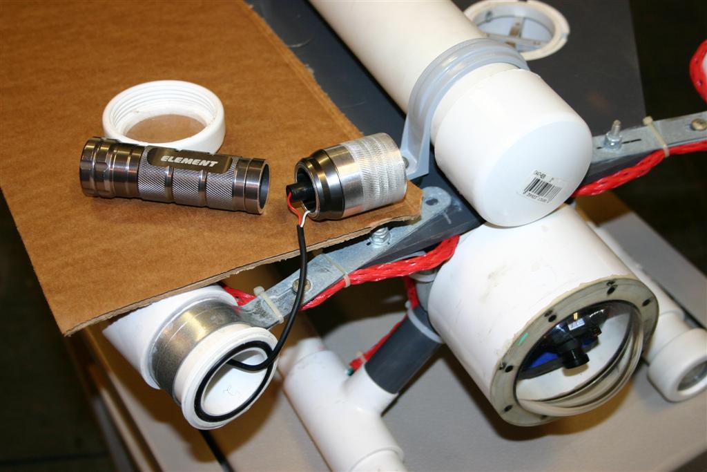

Yes, we are using 3 watt LED flashlight like the URL you posted.
We chucked the flashlight up in the lathe and cut off the back end of the flashlight, connect wires to the lamp and ran them off of the PWM lighting control inside the ROV.
The flashlights where then slid inside of a 1" PVC pipe coupling with a plexi-glass lens.
They work very well. If they are to bright you can slightly opaque the plastic lens.
We bought the flashlights at Sam's Club. They came as a two pack.

- IMG_0270 (Large).JPG (89.17 KiB) Viewed 7960 times
- IMG_0268 (Large).JPG (55.57 KiB) Viewed 7960 times
