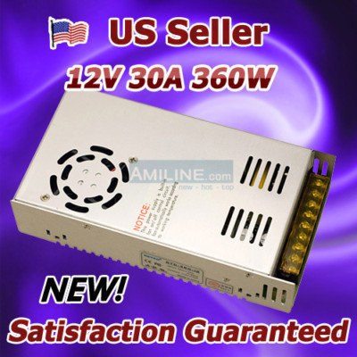

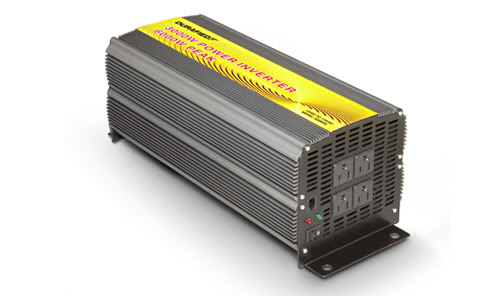

I want to have any opinions about this idea. I think to rise up the voltage in the tethers to compensate the losses (150 feet).
12 volts to 120 volts from the surface and the opposite in the rov. Surface can also be a small fuel generator for 120 volts
this one at the surface:
and this one inside the rov

or heat from that inverter?
