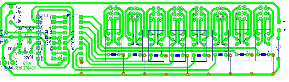

Hello,
Made a pcb for testing, seems to work ok, source is http://www.bitmonster.com/ir/ , from the remote I extend the IR led with some 75 meters cable ....made the remote with the help from a SAA3010 . But you can use a remote from Philips VCR ..
