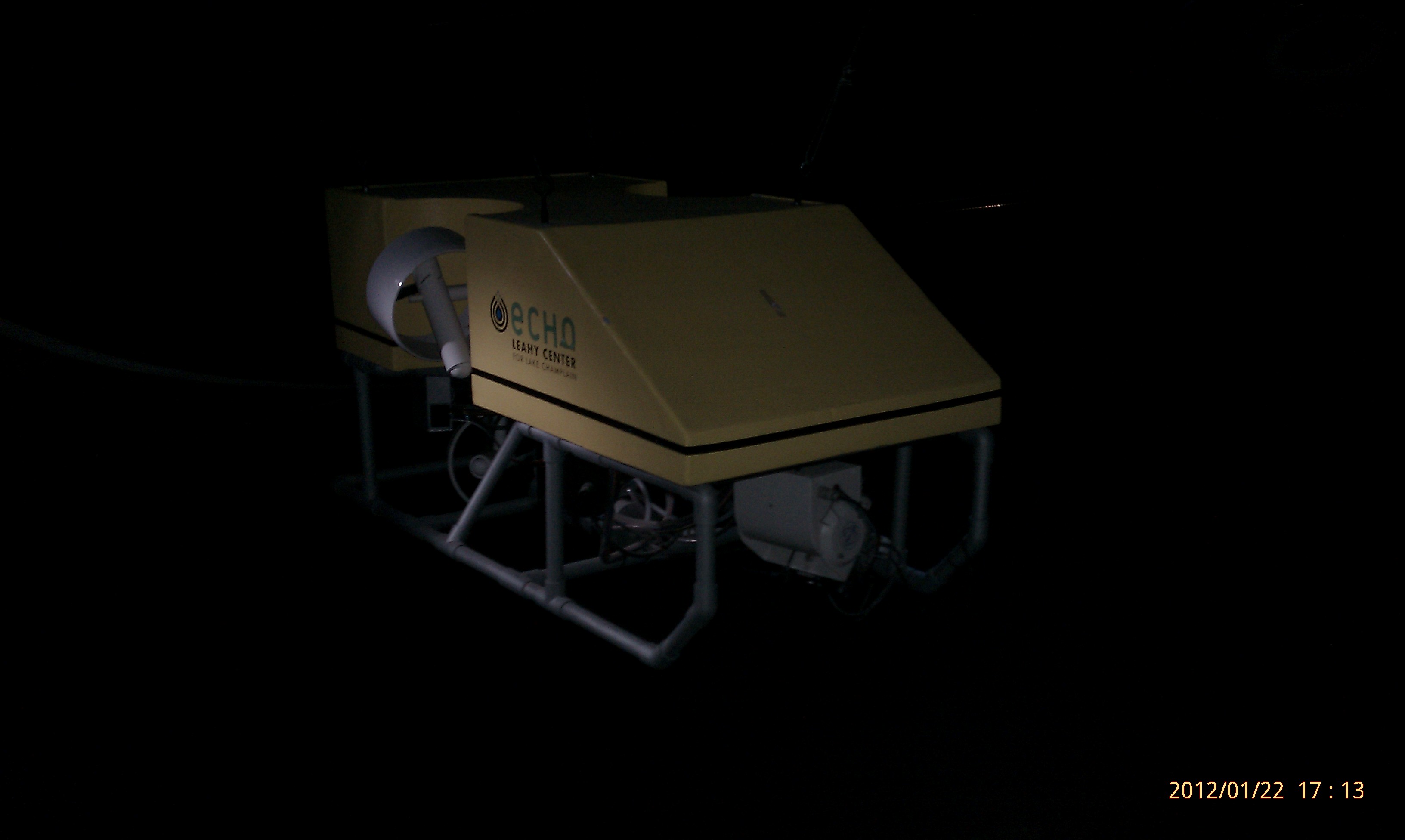

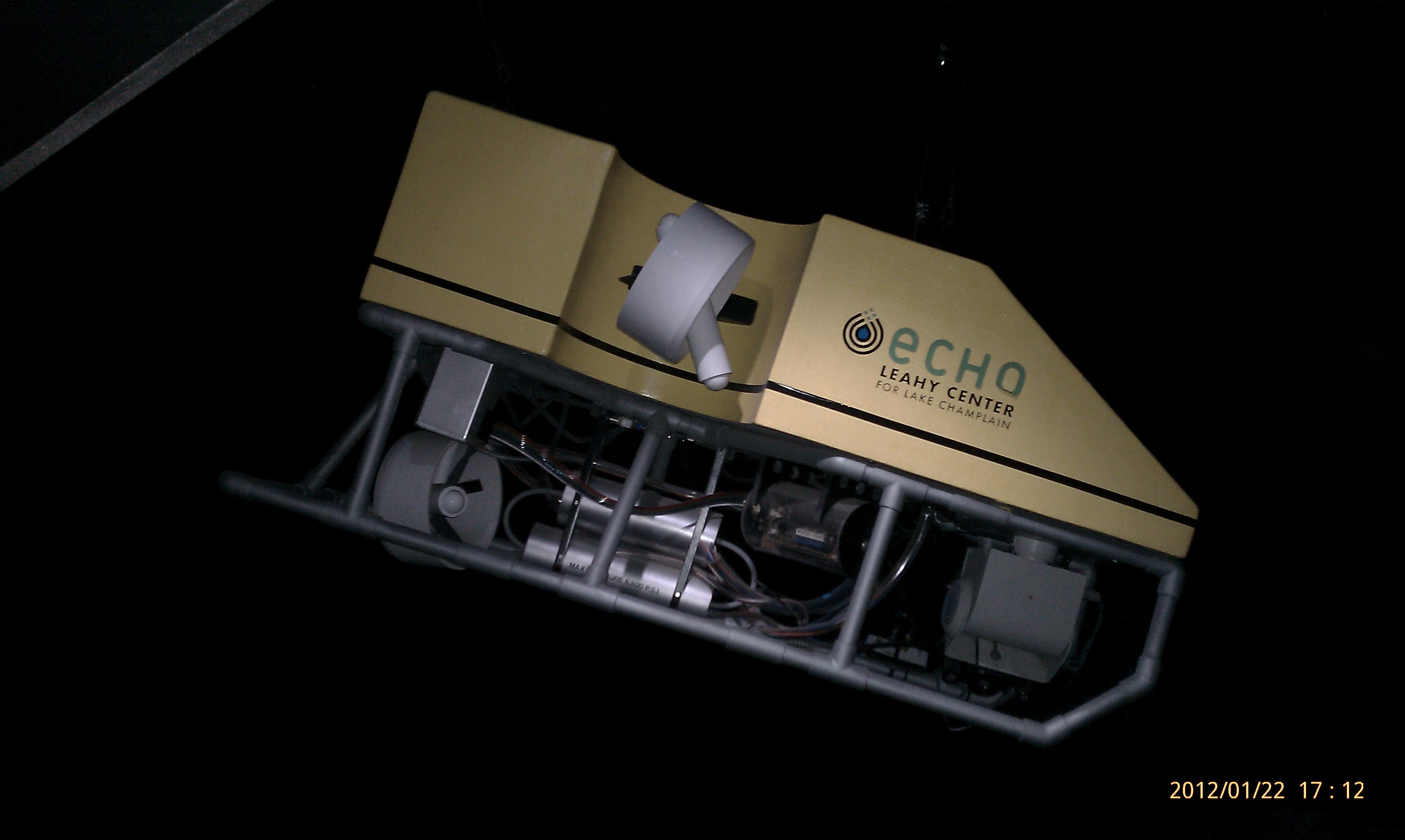

So anyways I'm in charge of maintenace and exhibits at our local aquarium, the pictures attached are of a 15 year old ROV that was used to find the General Butler off of the burlington waterfront on lake champlain. Now for the last 10 years it has hung from a ceiling over a full scale replica of what was left of the gen. butler cargo ship. It is attached to a monitor on the third floor with a joystick control to work the camera and lights on the very front of the rov to give people a look to see what it would be like to actually run a rov over a sunken ship. Unfortunately it is old and is very problematic. The small greyish box hanging from the very front is the two lights and camera, it no longer works. I will be tearing it off to work on it later this week.
My plans are to duplicate the original design, with newer modifications. Echo II, will be the name of the unit, and it will be used to explore other wrecks on lake champlain for teaching purposes and probably a little show and tell at festivals that we have. Hope you all enjoy the pictures.

Something is seriously wrong with that port side vertical thruster, the kort nozzle is way out of kilter and the thruster's position is out of whack also. I'm guessing those aren't the original thrusters and are just mock-ups, right?
What's its size/scale, hard to tell from the photograph. What are your plans for thrusters? That always seems to be the most challenging / most expensive part of the project.

Post by thamlin »
Yeah its been striped of a lot of gear, what you cant see in the pictures, there is a lot of cut wiring, motors missing. Its roughly 30 inches long by out about 18 inchs high. I will be getting all my measurements this wensday when i take it down to work on the camera and lights. It will be interesting to get the top yellow cap off to see what else is inside it. thrusters Im planning on 1100 gph inserts for vertical descent and probably two 800s for forward and reverse, micro camera with tilt on a rotatable axis with servo. Would like a temp sensor with depth sensor also, connected with 100 feet of teather. Plently of wrecks in lake champlain that are not to deep. I will enclose the motors to keep debri out, weeds and such and for more concise propulsion. Trying to find a descent engineering cad program to draw up the plans in 3d once i get the measurements.

Post by thamlin »
Thanks NCUWI, I do believe your correct, the size of this unit in the pictures is huge for a ROV, and from the pictures that i have at work, i now dont believe this is the original unit that found the ship, but a MOCK up of the original used for the aquarium only. I now dont believe this one in the pictures i supplied here was ever in water. The pictures show a very similar style and yellow cover on top, but with close observation, you can see the details and differences. I have decided to stick with the design but much smaller, like you suggest someweres in a 1/2 half scale. Ive got all my measurements now and will be picking up my pvc and lexan tomorrow. Im not using the schedule 40 white pvc, depending on the cost, i think i will be using schedule 80 pvc, which i believe will take banging around wrecks and logs, rocks a lot better than the softer schedule 40 pvc. The lexan I will be using for the "cowl". With a descent heat gun that i use at work we form stuff all the time for exhibits in the aquarium so soft light touches and a heat gun i believe i will be able to form my cowl as a one piece unit to cover the ROV. I have monday thru wensday off, i believe i will work on it then, since the weather has been terrible it will be a nice project for my days off. :!:
