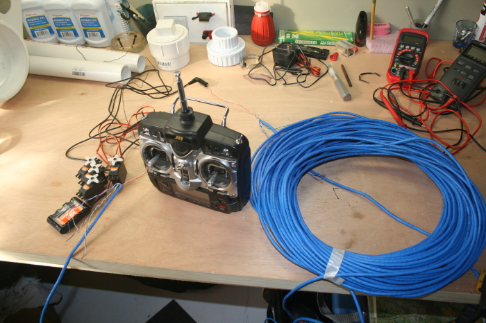

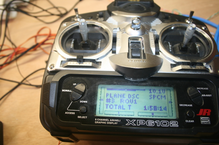

JR 6 channel XP6102 rc radio, on DSC, down 200ft of cat5 on one twisted pair. works great !

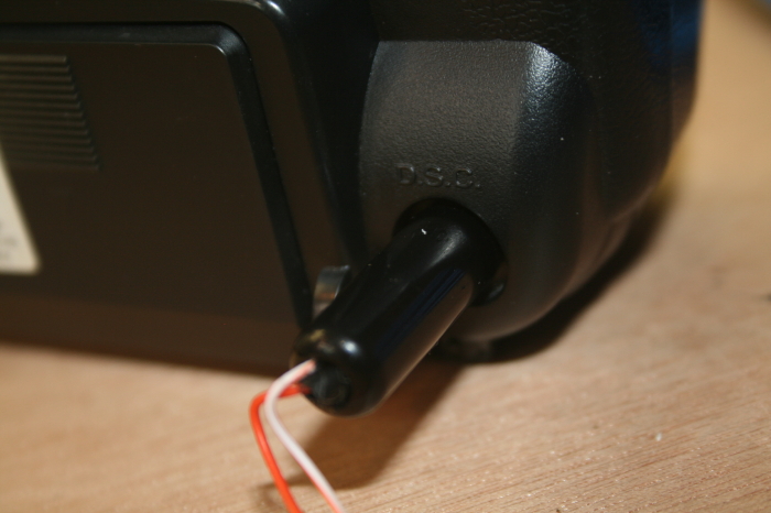

looks like a good system. is there a dsc input on the reciever? how do you interface the twisted pair to drive several servo's?

it is plug and play, the dsc cord that comes with the radio plugs into the charging line at the on/off switch of the Rx, and the dsc port on the back of the radio, I just put a male/female 3.5mm plug/jack on each end of the cat5 cable. to make a 200ft extension cord out of one twisted pair. this is just a dry mock up.
