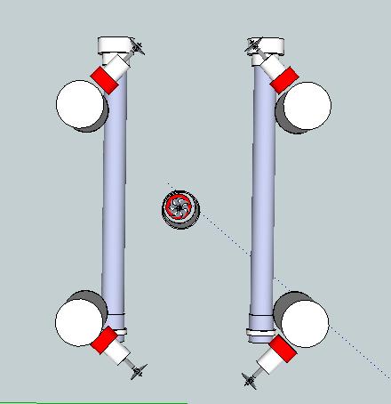

Started planning to build my next ROV. With an arm this time (not shown in the 3D drawing.
There will be a total of 4 ballast tanks to be able to control the buoyancy when I grab something with the arm. All tanks will have there own solenoid so I can control the water level in each tank independent from eachother. I will use a windscreen fluid pump to pump in/out the fluid from the tank.
The two pipes in the bottom of the ROV is two sets of NI-MH battery. 10 in each pipe. A total of 20A /12 V.
Everything will be runned from a onboard Arduino card that is communicating with the surface card over RS-485. I will use normal switches on the surface to control the ROV.

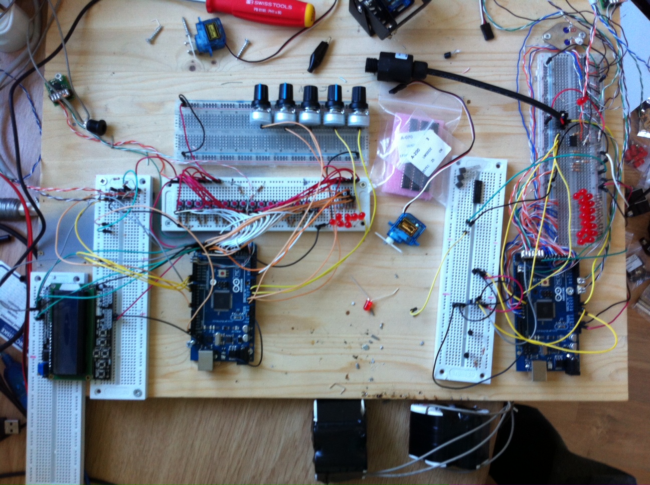

The control system is almost ready.
Communication will be between to Arduino Mega card over RS485 , everythings is tested and OK. All programming is done by a person from India I fond on http://www.freelancer.com
My controll system consist of the following
- 19 switches to controll 19 relay or mosfet
- 7 water detectors
- 5 potensiometer to control 4 servos and one transistor
- 2 compas (0-359 dg) one on ROV and one on surface
- Pressure sensor to calculate depth
- 2 temp sensor, one inside camera housing and one for water temp.
- 2 voltage and amp sensors for two batteries.

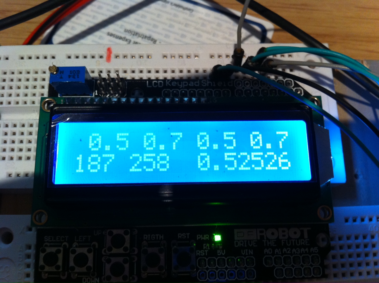

Picture of the test setup. Surface card to the left.
Arduino setup.JPG (585.61 KiB) Viewed 11839 times

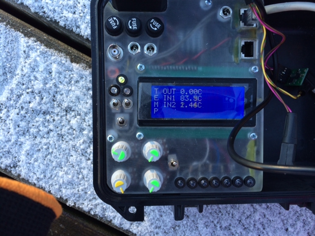

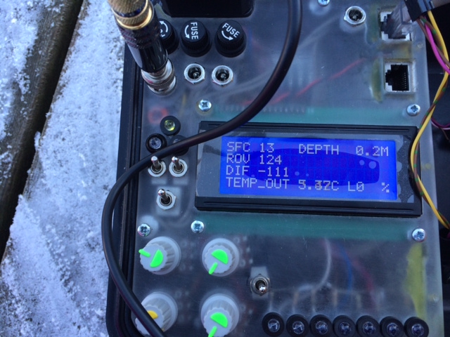

Surface LCD
Top line from left:
Voltage battery 1
Amp battery 1
Voltage battery 2
Amp battery 2
Bottom line from left:
Compas surface
Compas ROV
Depth of ROV
Temp sensor inside camera housing ROV
Temp sensor outside ROV

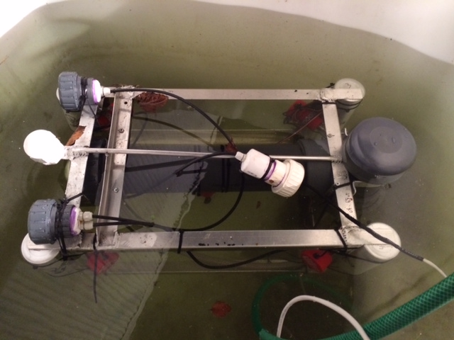

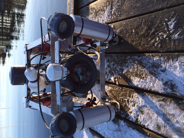

Finaly completed my ROV project. With ballast system.
Controlled by Playstation 2 controller, arduino and RS485
