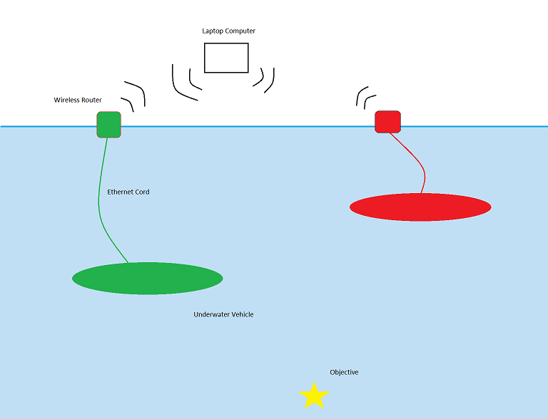

Hey,
I'm a grad student working on a collaborative AUV project. We've just started ordering some parts, so hopefully there will be something to show off in a couple of weeks.
Our basic system design looks something like this (pardon the MS paint):
The current plan is to have each underwater vehicle tow a wireless router in a buoy. Each vehicle will have a network camera connected to the wireless router, sending video footage back to a base station for analysis. The wireless router will also be connected to an arduino on board the vehicle. The arduino will read sensor measurements and relay them back to the base station. It will also recieve commands from the base station and drive the thrusters accordingly. Much of this architecture is based off of the wifi rc car found here.

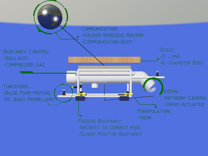

For thrusters, we're planning on having 2 thrusters for forward/backward and turning, and another 2 thrusters for depth and pitch. Our initial design looks something like this:
(PS: I know the thrusters on top don't actually provide thrust in that configuration, this was the marketing picture :twisted: )
We're planning on 1000GPH bilge pump cartridges all around, powered by an onboard SLA battery.

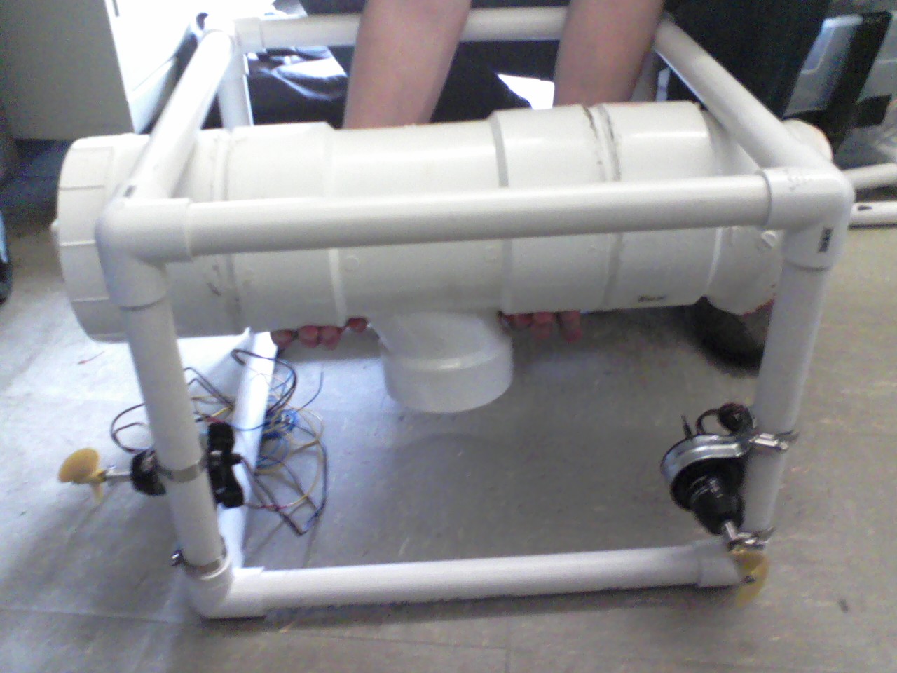

And... I'm back! In the past couple weeks we've gutted our boat and started turning it into a AUV. We've got a hull made of 6" PVC pipe with a camera dome in the front. (Shown below)
hull
hull
It needs to be cleaned a little, but you get the concept. We've also got a mockup of the frame that will allow us to mount thrusters, ballasts and weights.
frame
frame
We came up with a pretty neat system of hose clamps and pipe straps that allow us to easily move the motors around so we can find the optimal position for them. I highly recommend it.

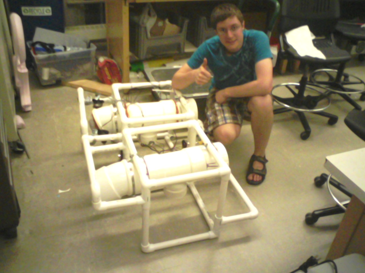

Well, its been a while. Here's a quick update and some picture.
We've tested the first ROV int he water. We're having some trouble with our sensors, but we hope to have that figured out by the end of the week.
The first ROV:
ROV1
ROV1
2
2
The pipes at the top were the mockups of our ballast tanks. Unfortunately, due to time constraints we won't be able to get working ballasts on our robots.

We're also working on making our second vehicle. At this point the hull is ready to be pressure tested. After that, there's just a little bit of work left with the electronics until the second vehicle is ready to be put in the water (in ROV form, we're still working on sensors).
The second robot after paint:
