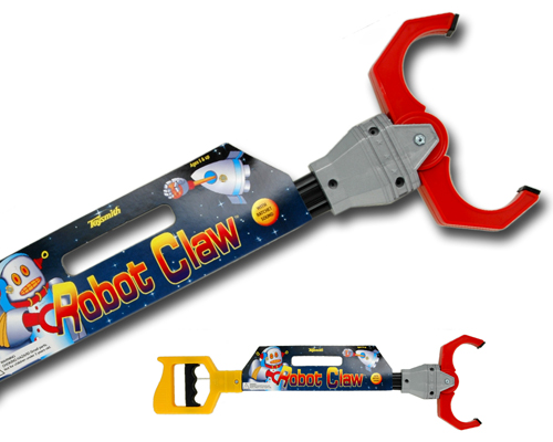

I use a simple geared motor in a PVC housing and seal the shaft exit with a small motorcycle oil seal. There are some simple toy robotic arms out there that people have been known to convert for single function manipulators such as something along these lines...
