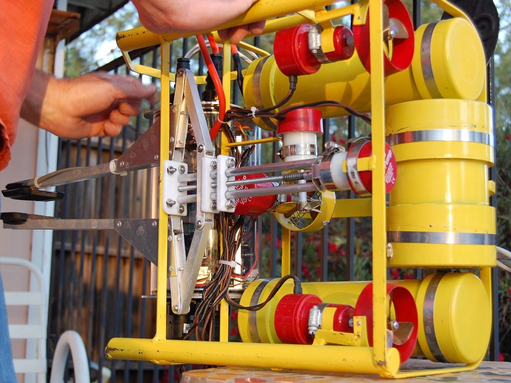

Here are two examples that we've made. The one on the yellow ROV uses a lead screw directly attached to the motor shaft to run a linkage. The lead screw in this case is actually a long threaded rod. Given the small motor we used, this gripper didn't have a lot of clamping force and sometimes got stuck. It's not a very smooth mechanism, but it works.

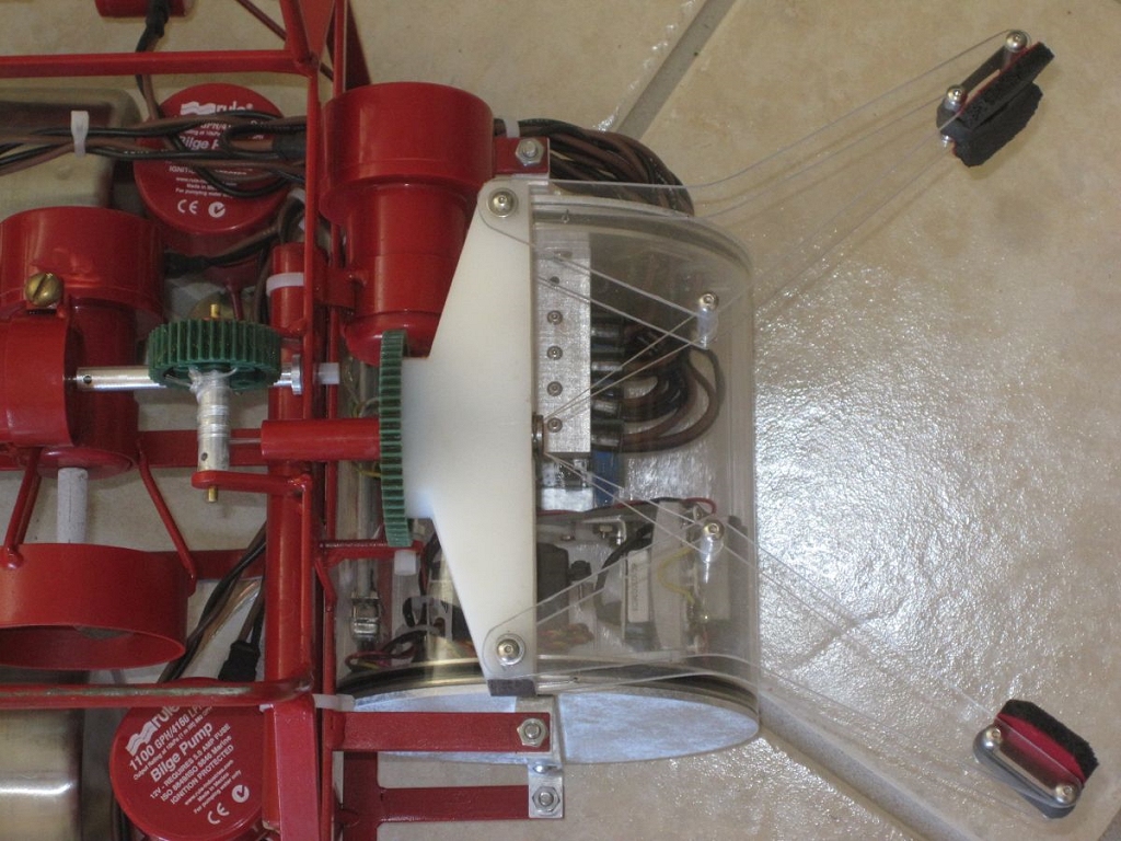

The claw on the red ROV has an extra degree of freedom; it can rotate as well as grip. Two bilge pump motors drive it, each attached to a worm gear that turns one of the green gears. The small green gear acts as a winch and pulls the fishing line in, while the other bigger gear is used to rotate the claw. It has a surprising amount of gripping force... we measured it with a small scale to be approximately 40 newtons.

Simple gripper on 'notBob'
Gripper on 'Babs' with two degrees of freedom
