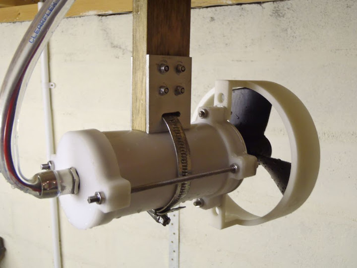

It's starting to look a bit like a real ROV thruster now ..... sort of :)
Thruster with nozzle 1.jpg (80.49 KiB) Viewed 21040 times

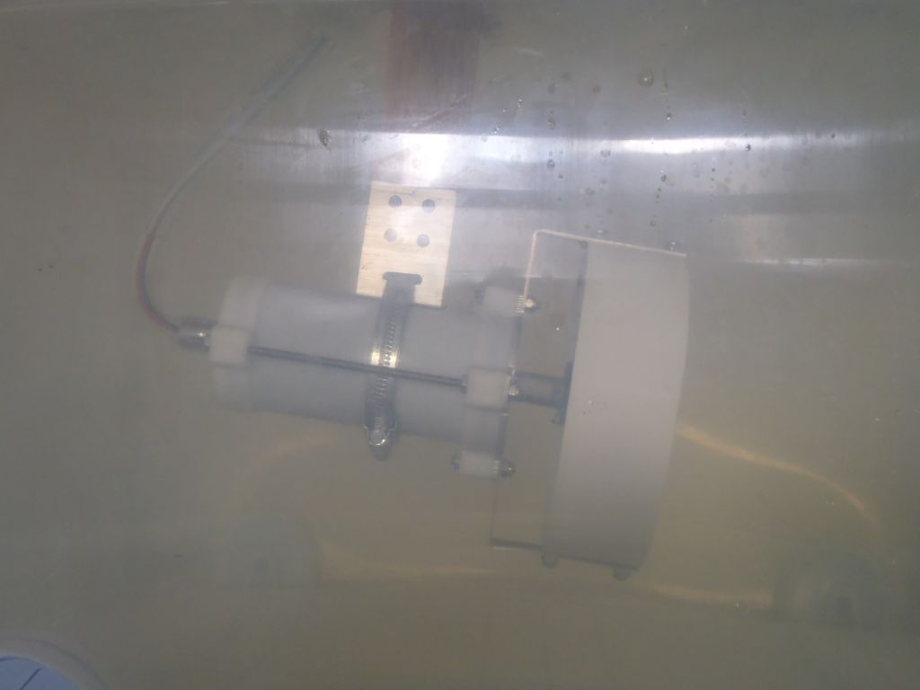

24VDC, 80 watt brushless DC motor and controller built into the unit. My intention is to oil fill on my ROV and pressure compensate so there are no problems with depth. So far about 750g of thrust in quite a small tank so I would probably expect about 1kg in a real situation.
Thruster with nozzle 2.jpg (43.57 KiB) Viewed 21040 times
My intention is to make a vectored ROV with two vertical thrusters so I'm looking at ways of making the parts for all the thrusters as economically as possible (I already have the motors), aswell as the main control PCB and control box, again oil filled and also the frame/buoyancy.
Still lots to do but I thnk the hardest part on an ROV is the thruster design, we'll see ........ 8-)

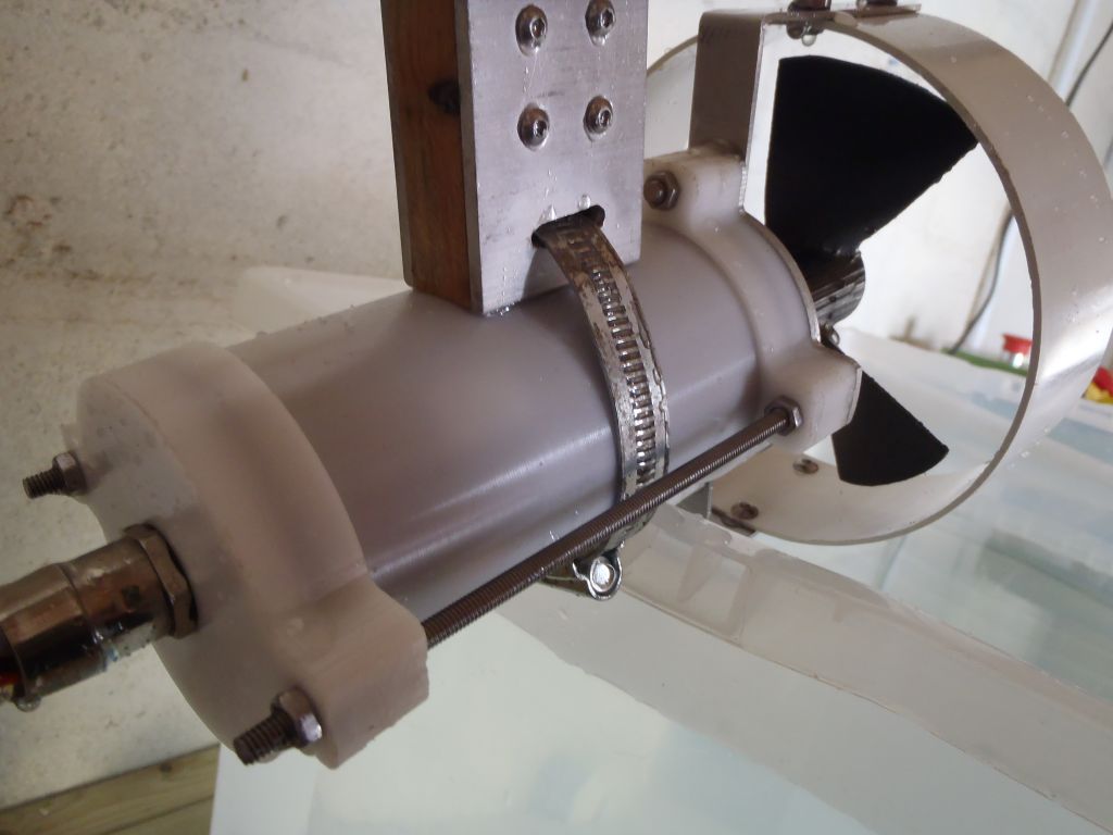

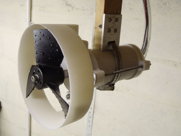

It's looking even more like a "proper" ROV thruster now with a Kort Nozzle and a bit more thrust into the bargain :D

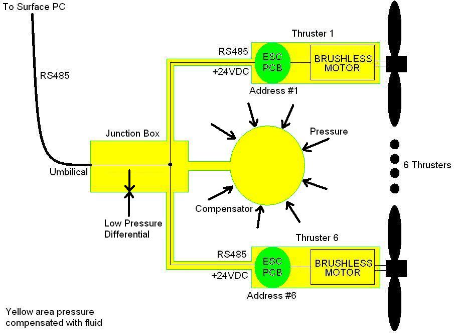

Quick question!
It looks as though your power feed for the motor is contained within a hose connected to the back of the thruster. Is the "atmosphere" inside the thruster housing the same as the one inside the hose?
I'm lacking the ability to think of the right words this morning... need more coffee probably...
Re: My new BLOG
Posted: Jan 16th, 2013, 11:02 am
by martinw
Hi,
Yes the 'atmosphere' is the same (fluid).
My intention is to take all the hoses from the thrusters back to a central point (junction box), connect then together, then take in my tether/umbilical from the surface to the same junction box, probably through a gland.
ROV Propulsion.JPG (51.5 KiB) Viewed 20635 times
The intention is then to make the yellow (in the drawing ;)) fluid pressure equal the water pressure using a compensator (probably an oil filled balloon of sorts).
This means the differential pressure on the motor shaft seal, motor housing, hose and junction box remain the same (and low) no matter what the depth.
That's the plan as it stands today anyway :)
Martin
