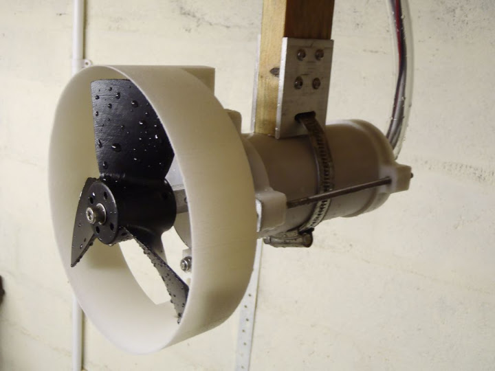

It's looking even more like a "proper" ROV thruster now with a Kort Nozzle and a bit more thrust into the bargain :D
New Kort Nozzle Front.jpg (52.25 KiB) Viewed 20634 times
New Kort Nozzle Rear.jpg (63.26 KiB) Viewed 20634 times
Martin

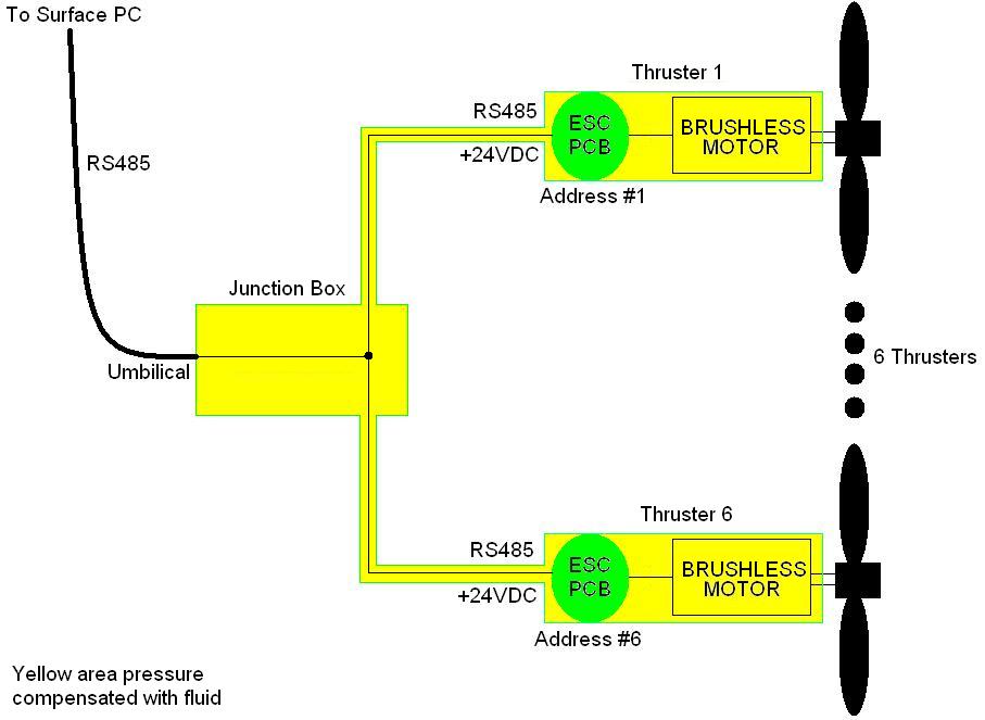

Re: My new BLOG
Quick question!
It looks as though your power feed for the motor is contained within a hose connected to the back of the thruster. Is the "atmosphere" inside the thruster housing the same as the one inside the hose?
I'm lacking the ability to think of the right words this morning... need more coffee probably...
martinw
Posts: 91
Location: Aberdeenshire
Re: My new BLOG
Post by martinw »
Hi,
Yes the 'atmosphere' is the same (fluid).
My intention is to take all the hoses from the thrusters back to a central point (junction box), connect then together, then take in my tether/umbilical from the surface to the same junction box, probably through a gland.
ROV Propulsion.JPG (51.5 KiB) Viewed 20624 times
The intention is then to make the yellow (in the drawing ;)) fluid pressure equal the water pressure using a compensator (probably an oil filled balloon of sorts).
This means the differential pressure on the motor shaft seal, motor housing, hose and junction box remain the same (and low) no matter what the depth.
That's the plan as it stands today anyway :)
Martin

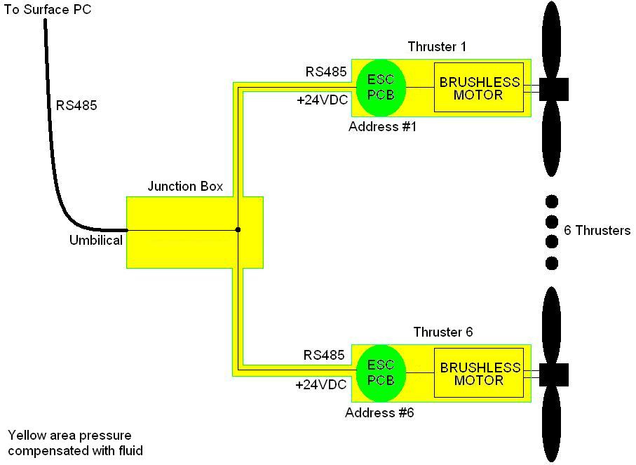

This isn't my idea by the way, it's been used on ROVs for a long time (although they don't use balloons ;))
ROV Propulsion Compensator.JPG (62.06 KiB) Viewed 20623 times
Basically the balloon (being made of rubber) transfers the pressure from the water, to the fluid, meaning all the green lines in the picture (boxes, tubes etc.) can be made from relatively thin material and the shaft seals on the thrusters aren't being constricted by external pressure and drawing more current/wearing out faster.
The down side is anything in the junction box or thruster etc., i.e. the ESC must be designed to be able to withstand the pressure, which it is ;)
I hope this makes things a bit clearer.
