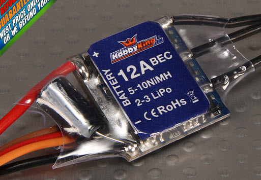

I bought a HobbyKing 12A BlueSeries Brushless Speed Controller in hopes of using it to control my up and down thrusters, two standard bilge pump motors. I was kind of hoping that once it got here I would be able to figure it out...no such luck. Will this work to control these thrusters? If so, then I have two important questions:
1) There are three output wires but obviously only 2 wires for my motors. By switching polarity I plan to control up and down from one controller. How do I wire this end?
2) What do I need to control the ESC itself? I was hoping for some sort of mechanical control but now it looks like I am going to have to use a RC controller.
I would really appriciate it if I could get some guidence on this. Thanks!

I think you need brushless motors (thrusters) for brushless ESC. Top side you need some kind of RC control. Also in order to reverse you need a reverse capable ESC (don’t think the one on your pic is) Think it’s easier for you to go with a relay setup and there is really brilliant people here able to help.

brushless escs will only operate brushless motors. you need a brushed esc like this one to control a bilge pump:

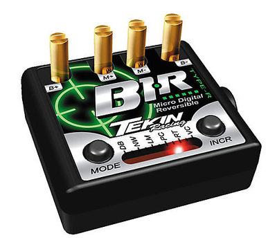

This is a proper reversible brushed ESC. They are getting harder to find these days as brushless motors are far more popular than brushed motors. And they are not cheap either.

as noted, that esc you pointed to is for brushless motors. bilge pumps are brushed motors.
as a general guideline, if an esc has 3 wires for the motor, it is for a brushless motor. brushed escs have two motor wires.
