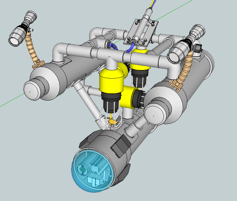

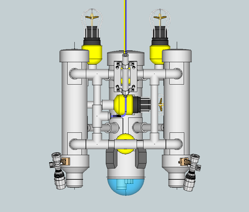

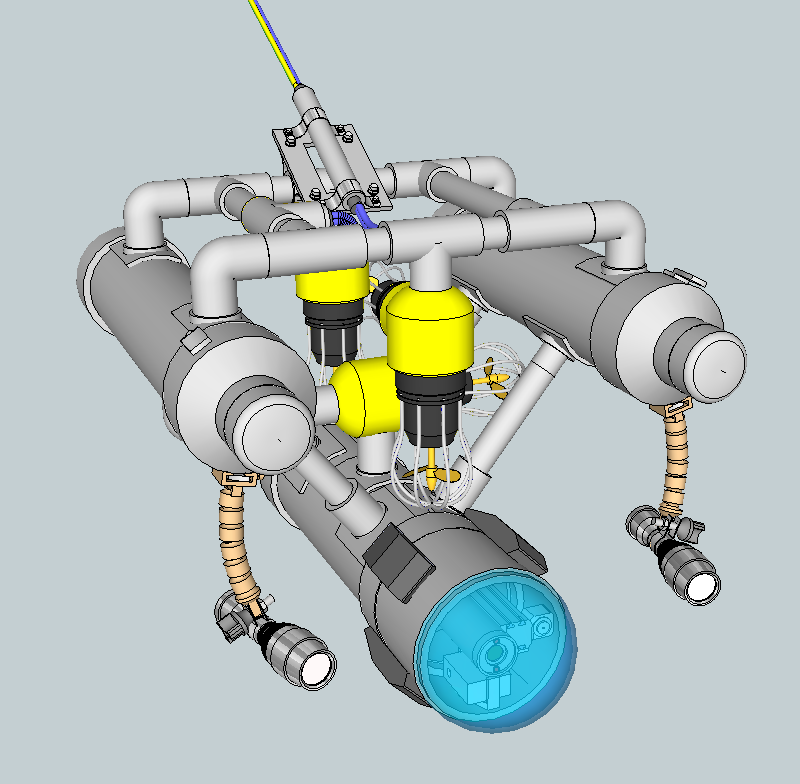

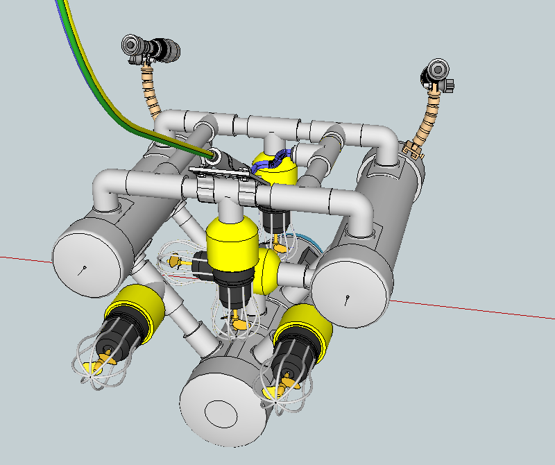

1. Someone on this forum mentioned they were using 2 vertical thrusters, the faster to dive to depth and to resurface. This struck me as a fine idea, and I incorporated it in the attached project. I have a little trepidation about it. I'm not sure I've located the vertical pair of thrusters such that the lifting or diving workload is divided equally between them. I imagine if it's not equally divided the whole thing may veer off this way or that. We'll see. I think I have them located to be pretty equal.
2. Another change is switching from the Rule thruster motors to the Johnsons. The Rule's wires emerge from the side of the motor housing; The Johnson's wires emerge from the rear of the motor housing. The big difference this makes is the Johnson wires can be kept entirely dry, and require no hull penetrations. It requires cutting those funny fins off the Johnson, and grinding off the raised lettering on the otherwise flat shoulder at the rear of the housing. Then, a short piece of 2" PVC sch. 40 fits nice and snug on that shoulder, ready for a good epoxy glue job. On its other end, standard fittings can be used to neck it down to integrate into the frame.
I really like having all the motor wiring completely internal. Now the only hull penetration is for the tether cables. The risk of leaks is greatly lessened.
3. Before, I was planning on using a large threaded plug at the aft end of the main hull for access to the battery packs and relays. That plan made it both difficult to work on and in serious danger of leaking. That plan also envisioned the cameras in their own housings, outside of the hulls.
The revised plan puts the cameras inside the main hull, capped with a 3/16" thick "optical" acrylic dome that fits snugly over the 4" (nominal) straight connector (5" OD) at the fore end of the main hull. There is a special adhesive for bonding acrylic to PVC. Access to the main hull is now a lathe-turned fitted joint that uses both the thickness of the pipe hull and the thickness of a straight connector over it to accomodate an O-ring seal that is drawn tight with 4 adjustable draw clamps. The joint is located to provide easy access to the cameras, the tilt servo, the relays, and the charging wires for the battery packs.
Well, I've already rattled on enough to put you to sleep. You can track these changes in the following illustrations:

derelicte, thank you for your kind words.
The 3D model was created in SketchUp, a FREE Cad program from Google. All of the images except the one with black background are screen shots taken in SketchUp. The rendering (first image) was made in Kerkythea, also a FREE program. Kerkythea has a SketchUp plug-in that creates a file of the SketchUp model that the Kerkythea program can use. These two programs work together very nicely. They both have a bit of a learning curve, but they also have good Help and tutorials.
About the motor mounts, assuming you understood the explanation of how to attach a short piece of 2" PVC to the back end of the motor, the next step (in my case) is to reduce the 2" down to 3/4". There is a type of bushing (called "Spigot x Slip") which slips inside the 2" pipe, and has a hole at its center that receives a 3/4" pipe. These are available at http://www.plumbingsupply.com/pvc.html#bush. I'm still working on how to create the little dome shape I've shown, but it is just for improved hydrodynamics and irrelevant to the structural connection.
[8/24/2011 edit: I've just received the "spigot x slip" fittings. I had misunderstood the description. The fitting does not fit inside the 2" pipe, but rather is the same OD as the 2" pipe, so a straight connector sleeve is required. It'll work fine . . . just a more weight.]
About the lights sticking up just asking for trouble, in most underwater environments they will be no problem. The reason they stick up is to get as much separation as possible between the cameras and the lights. This is preferred because from the cameras' angle of view, it decreases the amount of "snow" (suspended debris in the water) that is illuminated by the lights, making for much better pics and video. In situations like exploring a shipwreck or a lava tube, the lights can be mounted on the underside of the of the upper hulls, so they hang down and are close to the cameras. These lights have their own internal batteries, so there are no wires to fret over. There are little "z"-shaped clips (not shown) attached to the hulls that hold the light supports. This lower mounting is not near as good a position, but sometimes necessary.
8/20/2011 edit:
The z-clips are now added. Attached shows lights in the lower position for navigating tight places.
8/20/2011 edit:
