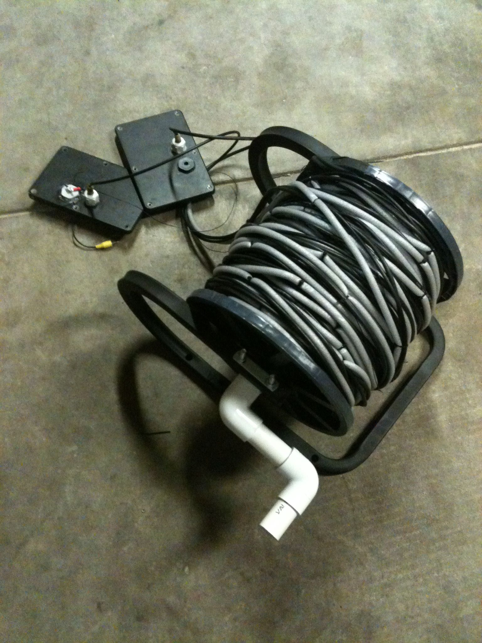

I'm going to try to attach a pic of the tether reel I made to hold the 330ft tether, hopefully that works. Otherwise, it's the frame from a Craftsman scooter chair thing from the garage, a cable reel donated by my local Home Depot, and PVC axle and hand crank.
Not sure where I left off with updates, but the ROV was a success to 130ft, then had a leak at 280ft but got successful video on all dives. Check "Mission Footage" for more info.
