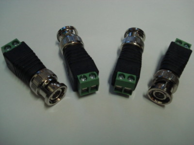

Another question. Are BNC to cat5 baluns as simple as they look? Just plug in BNC and strip and clamp 2 cat5 wires under the screws?

I'm not sure what type of baluns you have, but most require that you put a cat5 jack on the end. Terminating them is pretty easy, and if you havn't done it before there are lot of great tutorials. I've never seen one that only required two wires, but that'd be nice as you could have more than one on the same cat5 wire.

here is a pic of the baluns i ordered i beleive they take only two wires. Correct me if im wrong

Twisted pair baluns, cool!
