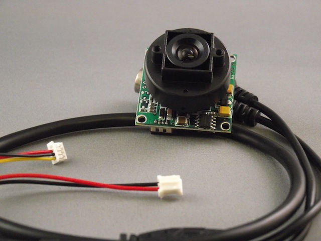

Camera
camera
camera

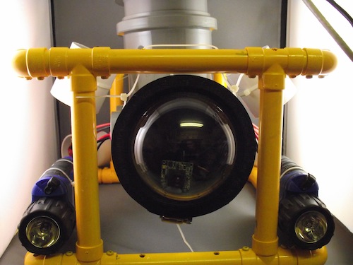

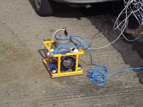

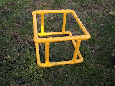

Frame

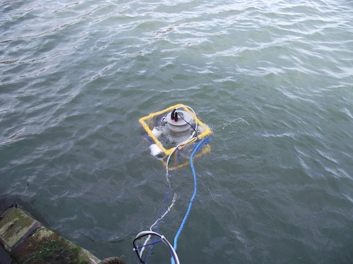

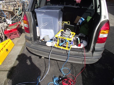

Harbour test

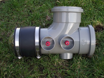

Hull

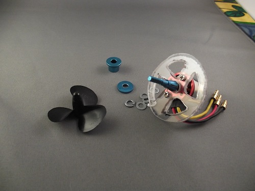

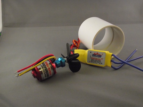

Motor
Motor Assembled

Awesome job!!! So how did the maiden voyage go? Cant wait for you to post some video of your test dives.

How do you interface the motors with the arduino? Do you use motor controllers with PWM, or relays, or something else? It looks very nice, by the way.

I use motor controller with pwm to control the motors, I'm currently working on integrating a digital compass and on screen display, have both working individually but now need to integrate them together.

It's looking great... I'll have to try out the brushless motors one of these days.

How have you found your thruster to preform? My thruster are the same design although my build has stalled completely at present :oops: http://www.rcgroups.com/forums/showthread.php?t=1328054

I copied your motor design from the RC forum ;)
They certainly move some water, I need to do more testing as I have only done a quick run so far. Trying to get the time is the main thing.

On board batteries. Controller is an Arduino, using USB over cat 5 for cabling, can use up to 150 feet away.
