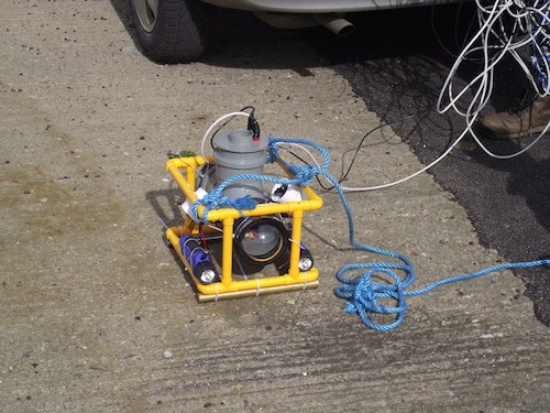

Dunk test
dunk test
dunk test

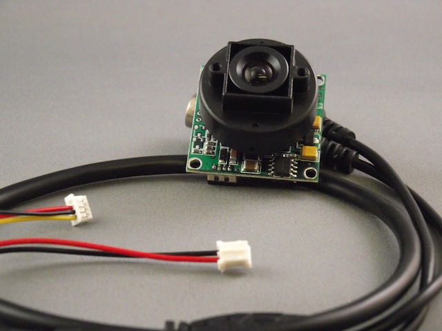

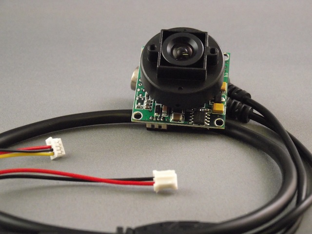

Camera
camera
camera

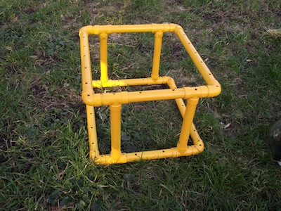

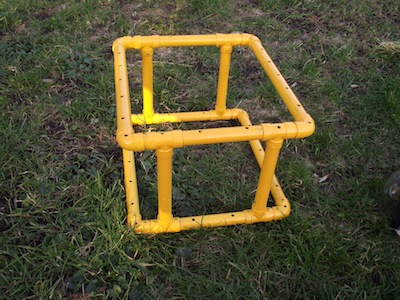

Frame

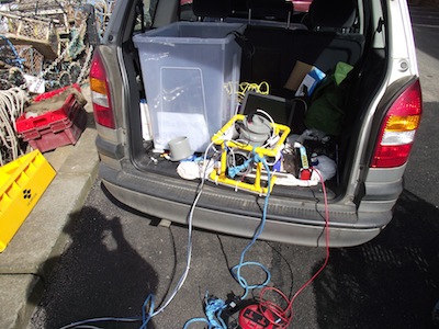

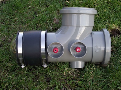

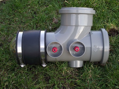

Harbour test
Hull

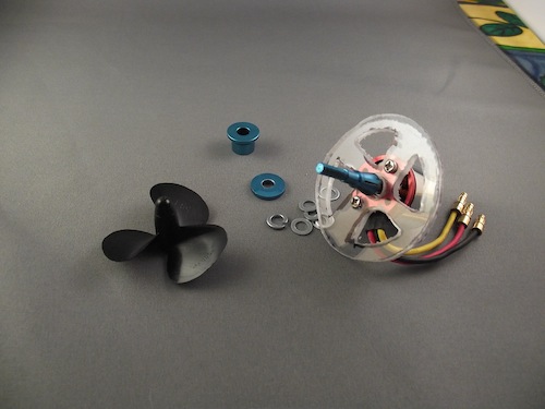

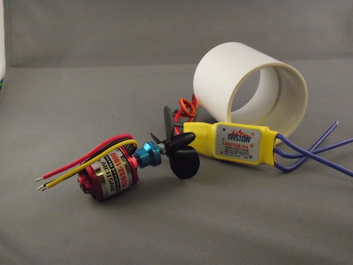

Motor
Motor Assembled

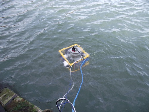

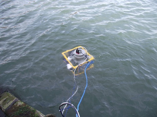

Water maiden voyage

Awesome job!!! So how did the maiden voyage go? Cant wait for you to post some video of your test dives.

I use motor controller with pwm to control the motors, I'm currently working on integrating a digital compass and on screen display, have both working individually but now need to integrate them together.

It's looking great... I'll have to try out the brushless motors one of these days.

Great looking build,
How have you found your thruster to preform? My thruster are the same design although my build has stalled completely at present :oops: http://www.rcgroups.com/forums/showthread.php?t=1328054

I copied your motor design from the RC forum ;)
They certainly move some water, I need to do more testing as I have only done a quick run so far. Trying to get the time is the main thing.
