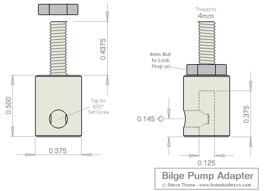

I get asked a lot about the prop adapters I use with the threaded Robbe props that I run. The adapters I use are custom machined on a small hobby lathe to the specs shown below.

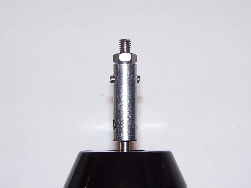

Using a drill press and a vise (with a v-block to keep the coupler vertical) I start buy drilling out one side using a 1/8" drill bit (or what ever size fits your motors shaft)
Next the coupler is flipped over and the other side is drilled and then tapped to fit a 4mm threaded rod. (or what ever size your prop is) if you can't find threaded rod, you can just cut the head off a 4mm bolt.
The threaded rod is then screwed into the hole you just tapped and is held in place with the one or two of the setscrews.

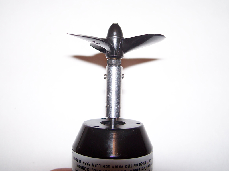

After that, screw on a 4mm nut, then your prop, then lock the nut back against the prop. (this will keep it from spinning of when you go in reverse)
You can then slide the adapter onto you motor/pump and lock it on with the other set screw.
(See pictures for reference.)
(Note - The prop shown in this picture is not the normal Robbe that I run.)

Some treadlock on those set screws would be a good idea.
The little buggers like to come out!

If you are using the Robbe propellers with the 4mm threaded holes and a motor with a 1/8" shaft, like the Mayfair bilge pump motors, you can use the Grand Wing DS003 3mm to 4mm propeller adapter if you can find them for sale anymore. One end is a 3mm hole with two set screws on either side and the other end has a shaft with 4mm threads. There is about 1/2" of unthreaded shaft ahead of the threaded part, but that can be easily cut off. I believe that adapter is made out of SS. I bought the last two at BP Hobbies and they do not expect to get anymore in unfortunately.

What motor are you showing in your pics? Thanks.
Randy
Re: Making Threaded Prop Adapters
Those are 750 GPH Mayfair Bilge Pump Replacement Motor Cartridges made by Johnson Pump. They use to be a cheap way to make thrusters but the prices have gone up in recent years.
