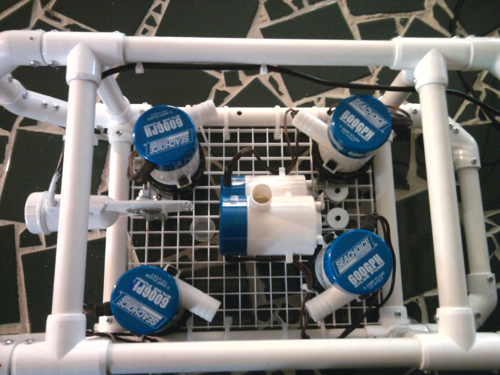

This is my rov that is almost most complete. The tether is 60 feet long. The movements are as follows... Forward, Reverse, left and right turn, spin left and spin right, slide left and slide right, down thrust and up thrust. The camera is fishing camera that I purchased off of Ebay. I will keep you guys updated on my progress. Thanks for looking at my post.

Wow.
that is a great looking first rov build you got there.
where did you get the "floor" on it, it looks absolutely amazing
one piece of advice id like to drop off:
Fix the tether center back, so the craft wont drift to one side when moving forward.
Re: My nearly completed Rov
Posted: Apr 17th, 2011, 8:37 pm
by soulreaper
Thanks lobster2b. The floor is Florence light diffusion panel. Home depot sells it. $10.00 bucks for a pretty good size panel. Thanks for the advice on the tether.. Will post more pics soon.
