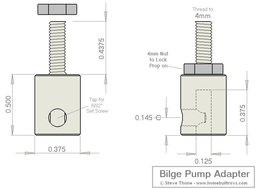

No matter what kind of prop you select you will need an adapter to attach the prop to the motor shaft. Most bilges pumps (at least the few I have used) have an solid 1/8" motor shaft, and then the type of adapter you use will depend on the props you choose, they may either be threaded or just have a hole through them.
For the props that just have a hole through them you can usually find a store bought adapter from hobby shops or places online like Tower Hobbies and they will look something like this.
The adapter would just slide over the motor shaft and be held on with a set screw, the prop then slides onto the adapter and is just held on with the nut.
For props that thread on (such as the ones from Harbor models that I use) you will probably need to make your own adapter such as this
Making your own adapters usually requires the use of a lathe to machine though. If you do have access to tooling these are the specs I use to make mine.
There are ways to make threaded adapters without a lathe but I'll save that for another thread so if you go that route just let me know.
