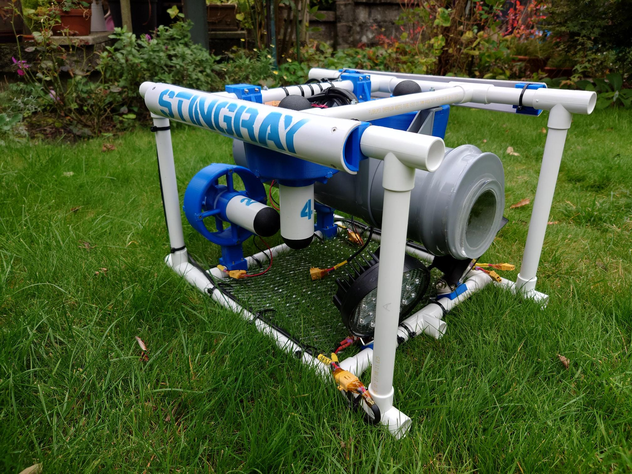

I have only really posted about my thruster design so far, so I think I will start a thread about my ROV itself! The end is in sight now, as I have finished all of the thrusters, pressure tested the whole thing in my nearest lake (living in the lake district is handy) and then installed the electronics in the dry tube.
20221009_153936 compressed.JPG (606.27 KiB) Viewed 104689 times
I pressure tested it to just over 30m, which is more than it will see in service since it only has a 25m tether. I may get a longer tether later on if 25m is too short. Unfortunately a small amount of water (only about a teaspoon) leaked into the dry tube, but this was just caused by some epoxy I spilled on one of the sealing faces.
The frame is just made of PVC pipe, so nothing particularly interesting there. All of the buoyancy comes from the dry tube. The thrusters are mounted using 3D-printed clamps, which can be repositioned as required. It has two cheap off-roading lights from e-bay for illumination, which I waterproofed with polyurethane. There is a 90mm diameter (10mm thick) acrylic window bonded to the front of the dry tube. This is flat, not a dome mainly because it was easier this way. It cost about £1 to get it custom cut, which was much less than I expected. I put some metal mesh on the bottom to give me somewhere to put ballast, and also to stop it from sucking in as much debris from the bottom.
The camera is a wide angle raspberry pi camera. I have it pointing slightly downwards to give better visibility directly in front of the ROV (no pan-tilt here unfortunately).

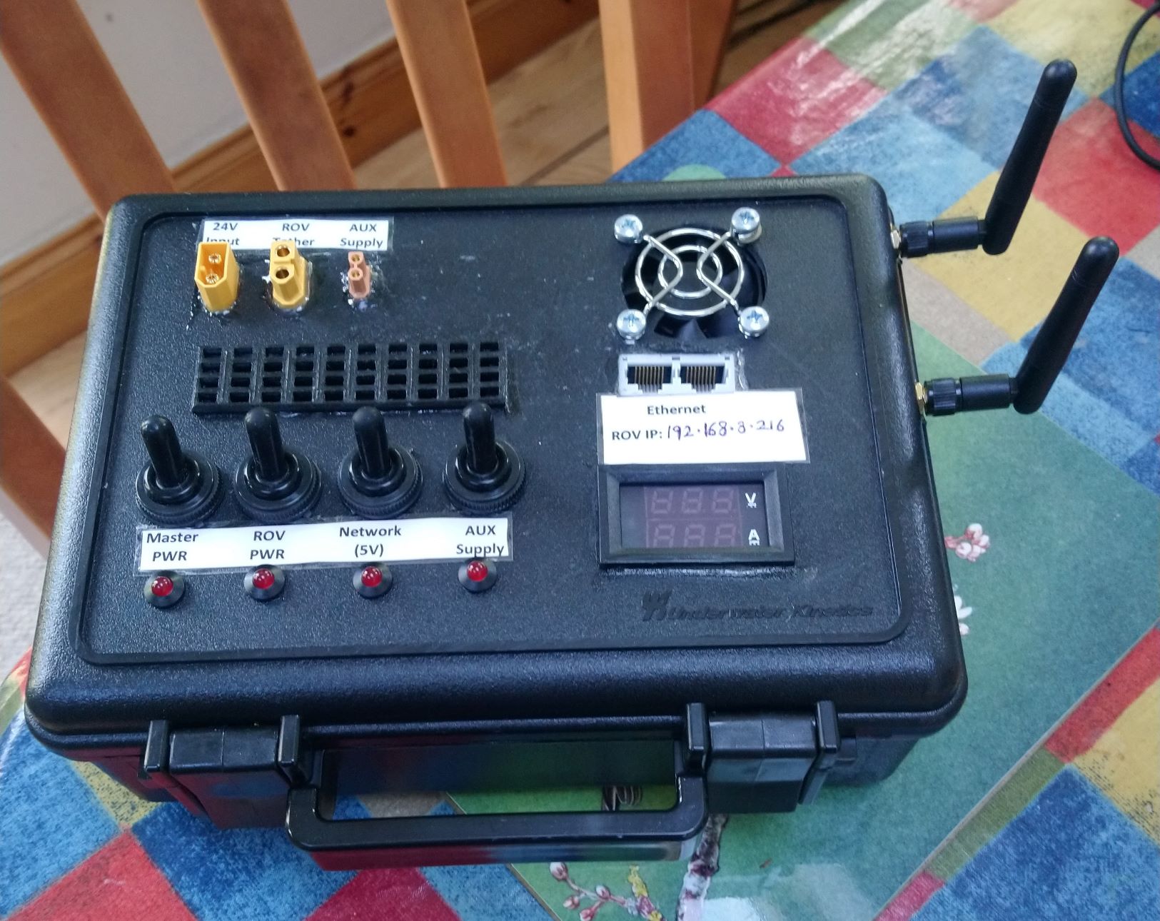

The ROV tether plugs into a box topside. This box contains the remains of a router, as well as a battery meter, fuses, switches and a power supply for charging my laptop. The ROV itself is controlled completely from the laptop. The use of Wi-Fi is so that the laptop doesn't have to be directly attached to the tether. This also means that multiple people can connect to the ROV at once and view the live camera feed using their phones.

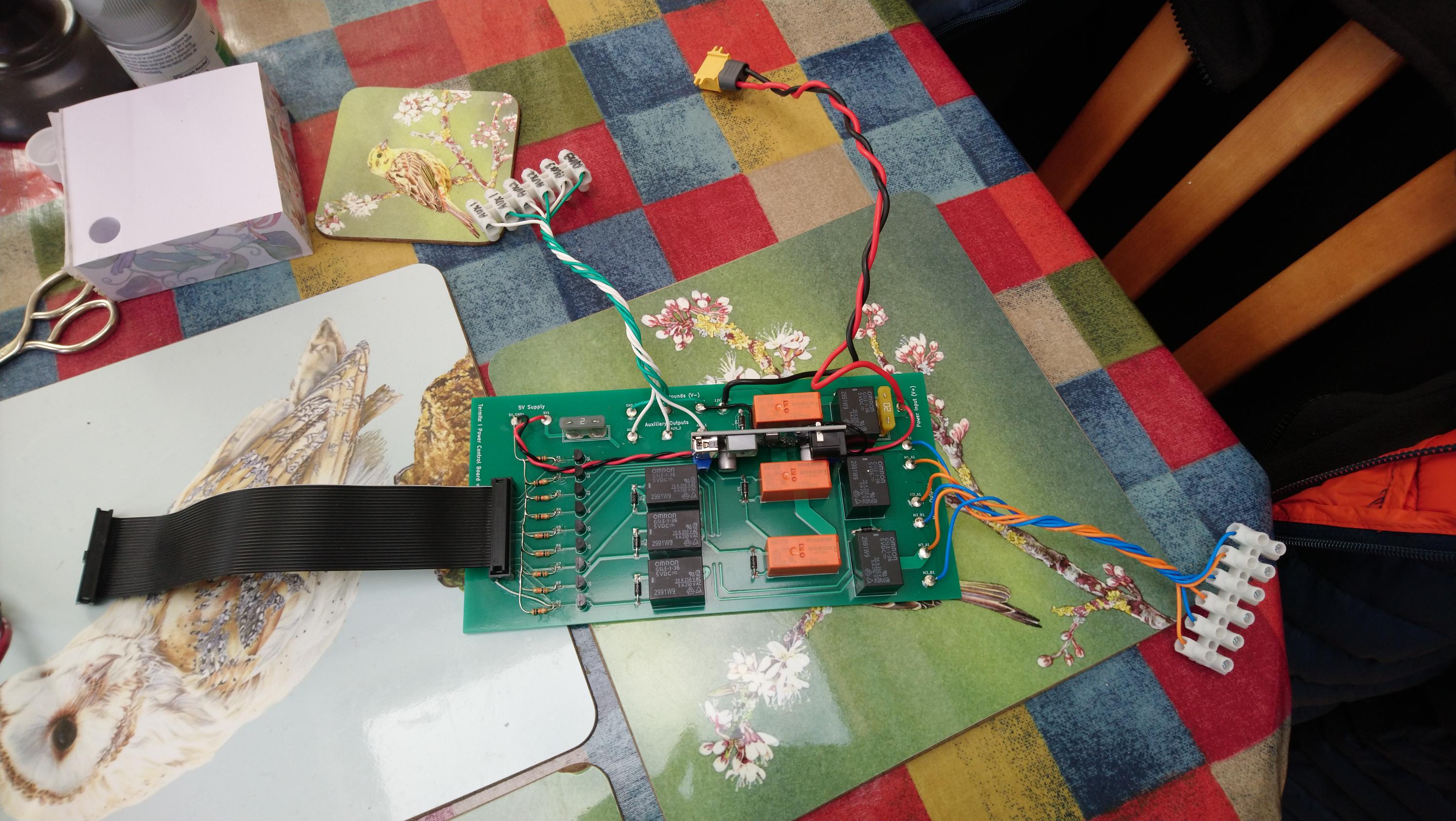

Here is the Power control PCB that I designed. I am using relays for control, with 3 reversible thruster channels, and 3 non-reversible AUX channels for lights and other accessories. The relays have 5VDC coils, powered by the 5V power supply. The raspberry pi is also powered by the 5V supply.

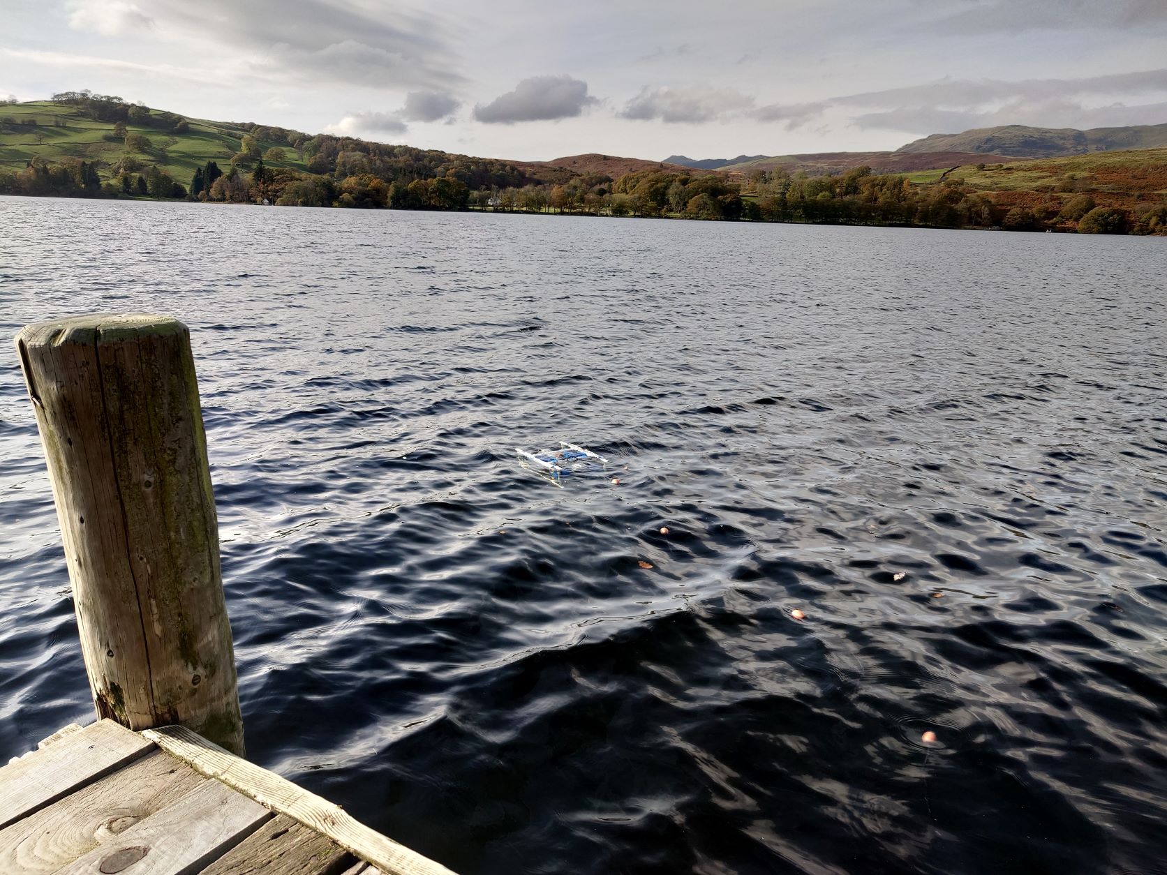

I did my first successful open water dive today, no issues!
I recorded a short video with a screen capture program. It's not the best quality because of the compression but you should get the idea:

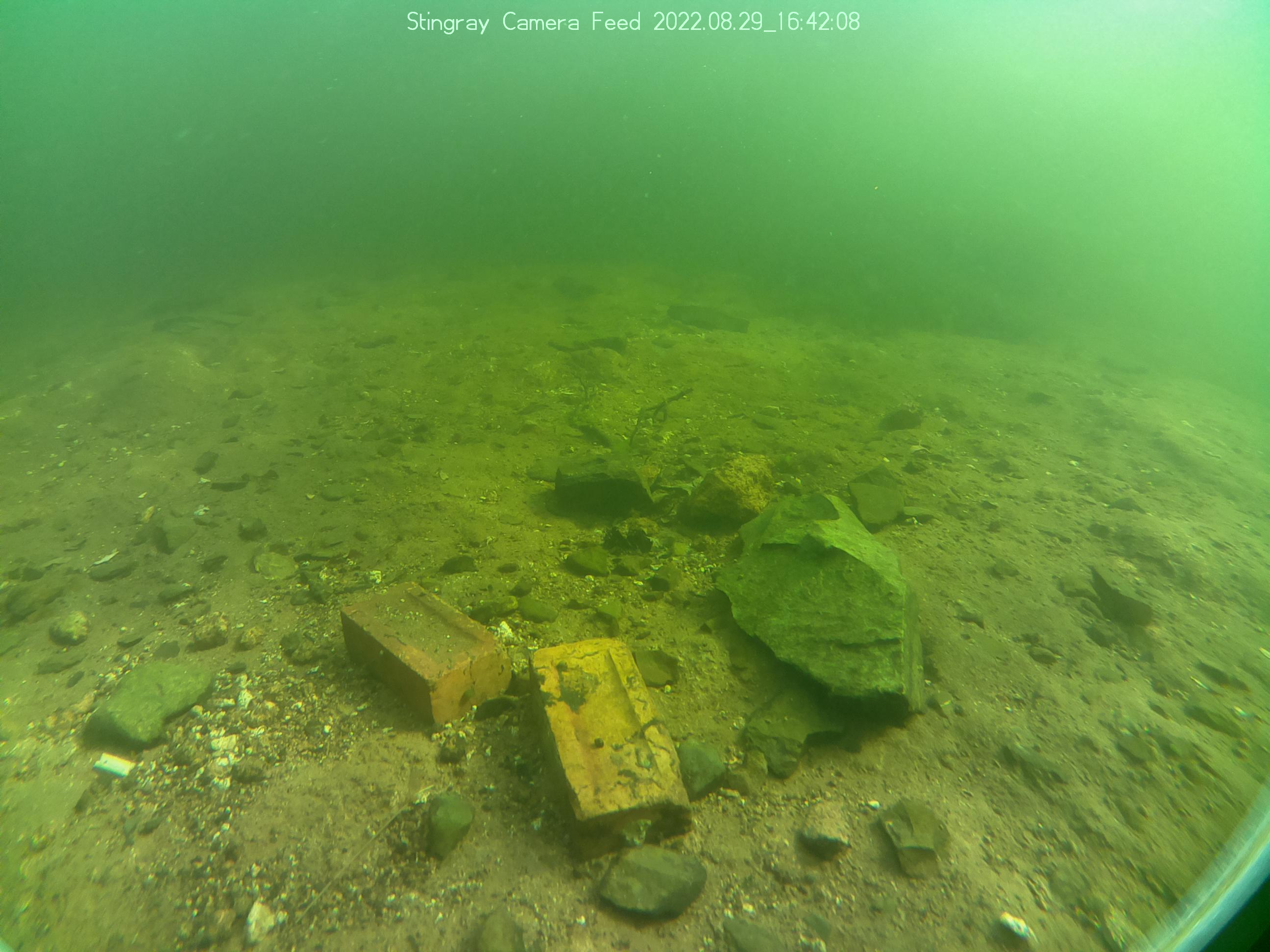

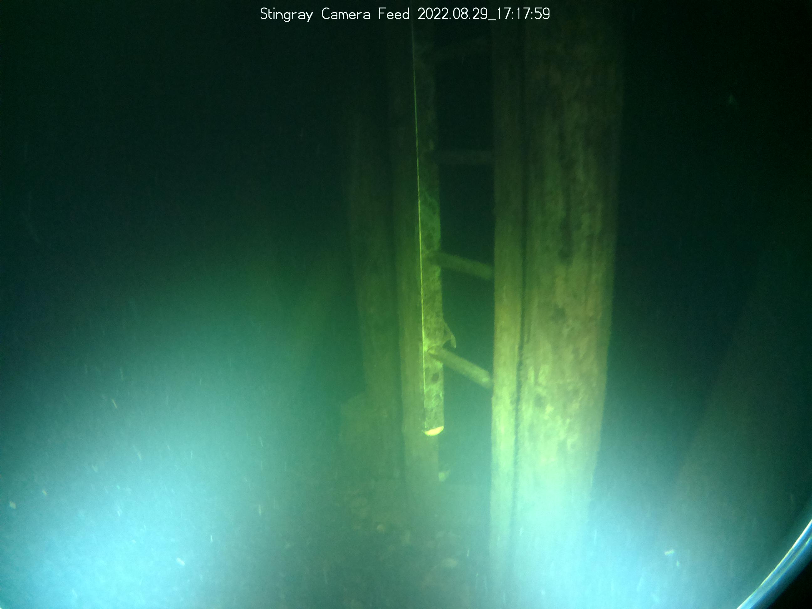

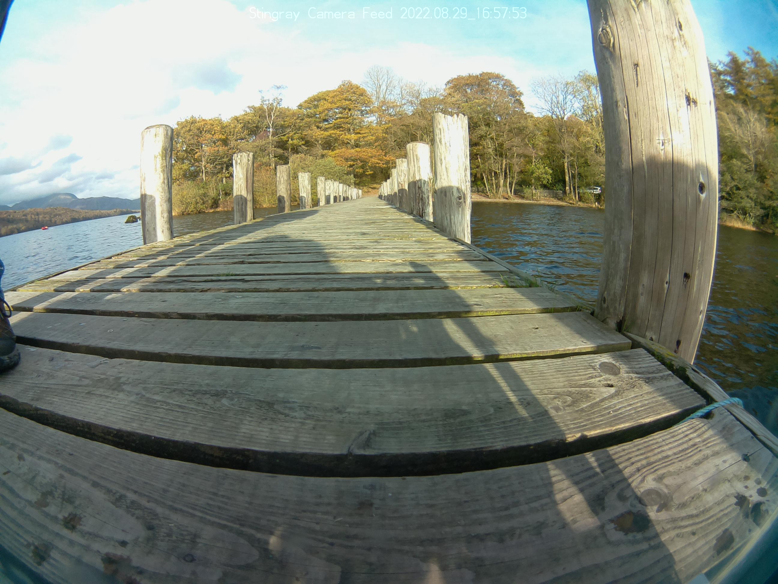

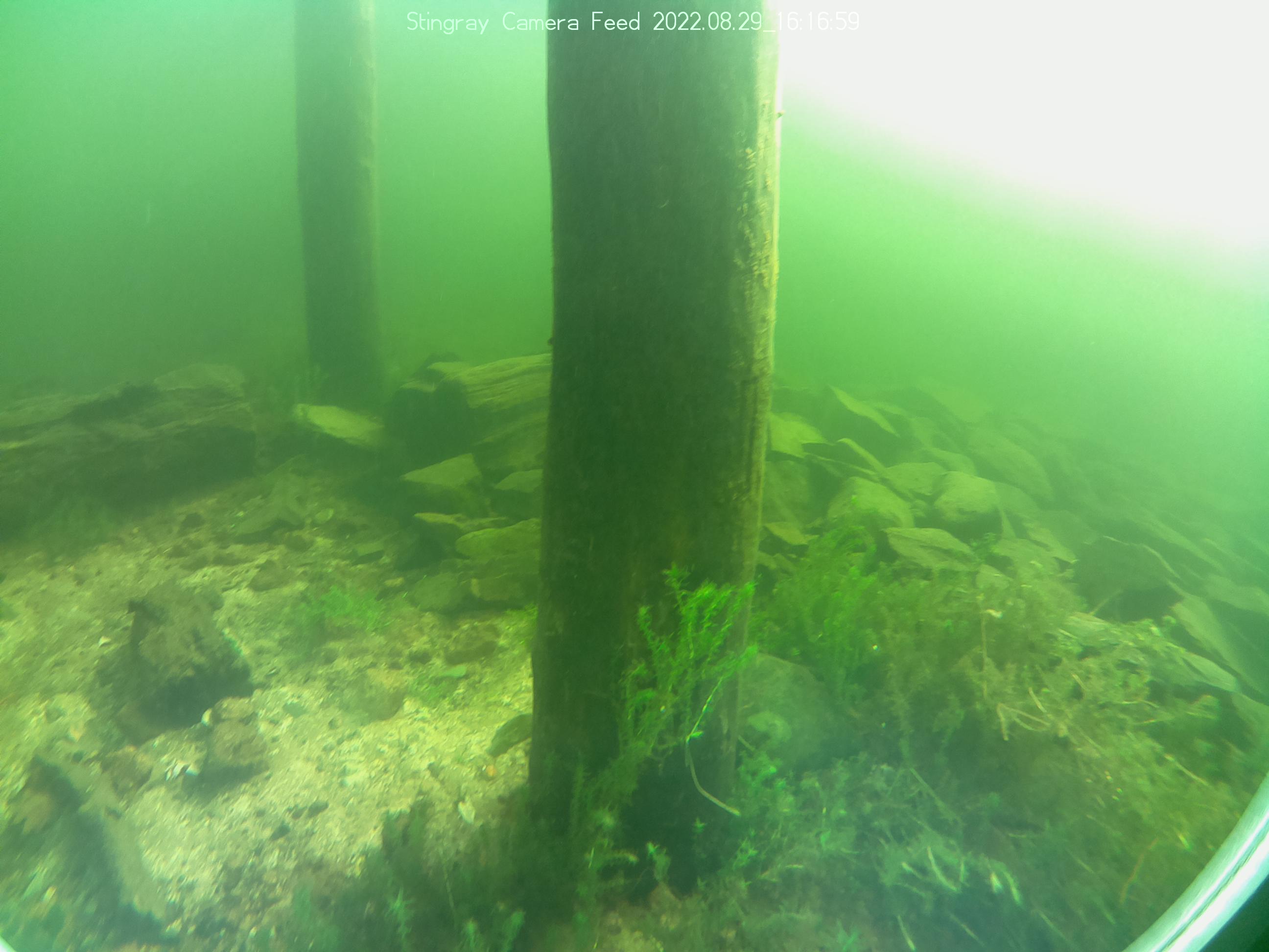

I also captured some photos with the ROV. These were taken and stored on the Raspberry pi and retrieved later. I'm really happy with the quality of them!
On the Pier
On the Pier
Bricks!
Bricks!
Pier supports
Pier supports

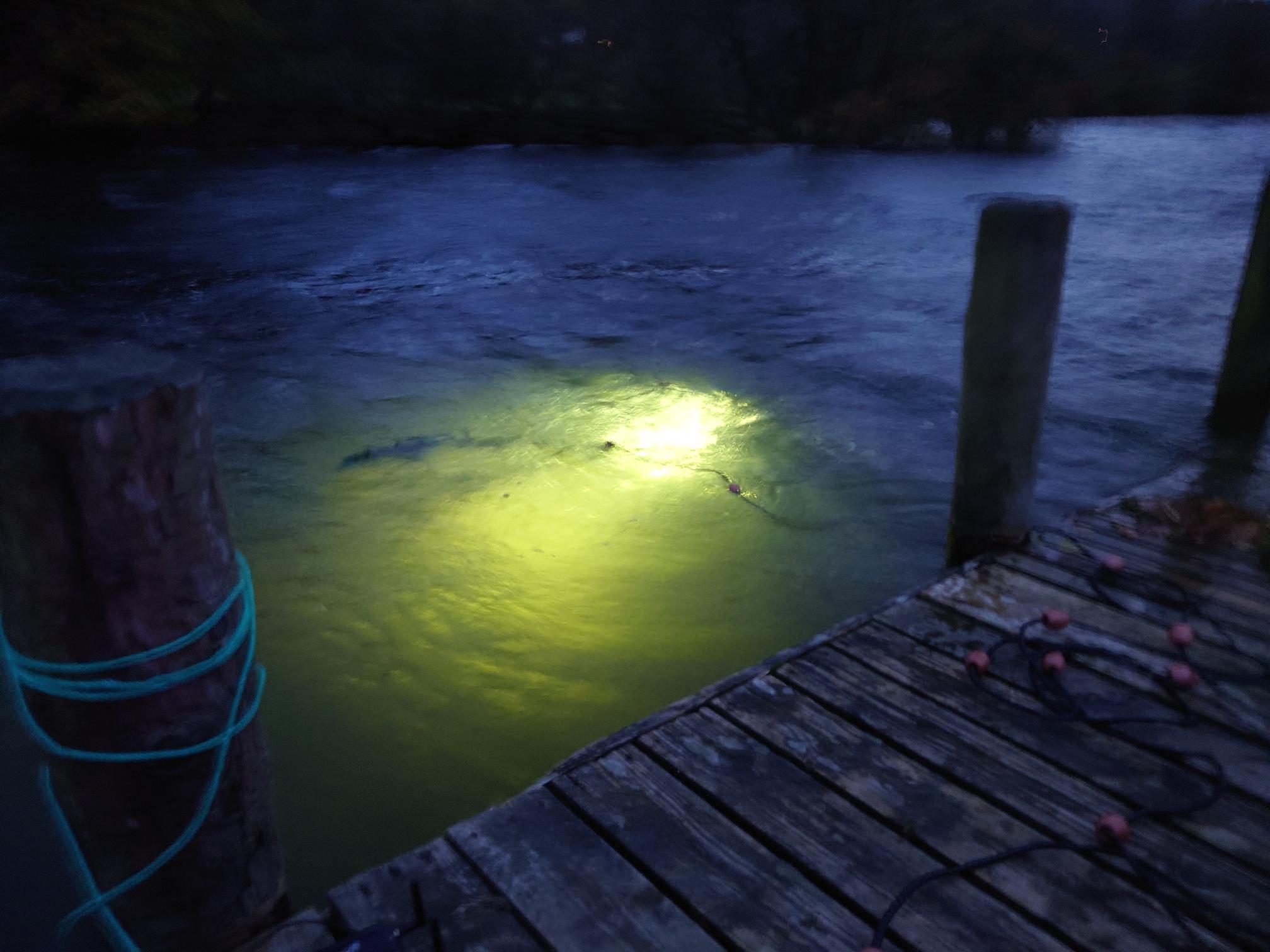

Thanks! I'm really pleased with it, especially considering it's my first ROV (no doubt there will be more in the future!). I've done a quick test in the dark with it to test out the lighting, and it works well! I've had a few tip-offs of where there might be some interesting stuff to look at, including a flooded quarry local to me, which has mining equipment and the odd car in it. I'll gradually do more challenging dives to build up my experience piloting it, and also find any issues with the ROV.
I've also started designing various tools to go on the front, which I intend to be quick-swappable by means of a 3D printed adapter.
Some backscatter from the lights due to the dirt in the water, but they provide good illumination! The water at this pier seemed worse quality than at the location of my first dive. There was lots of loose weed, but luckily the prop guards prevented any tangles!
