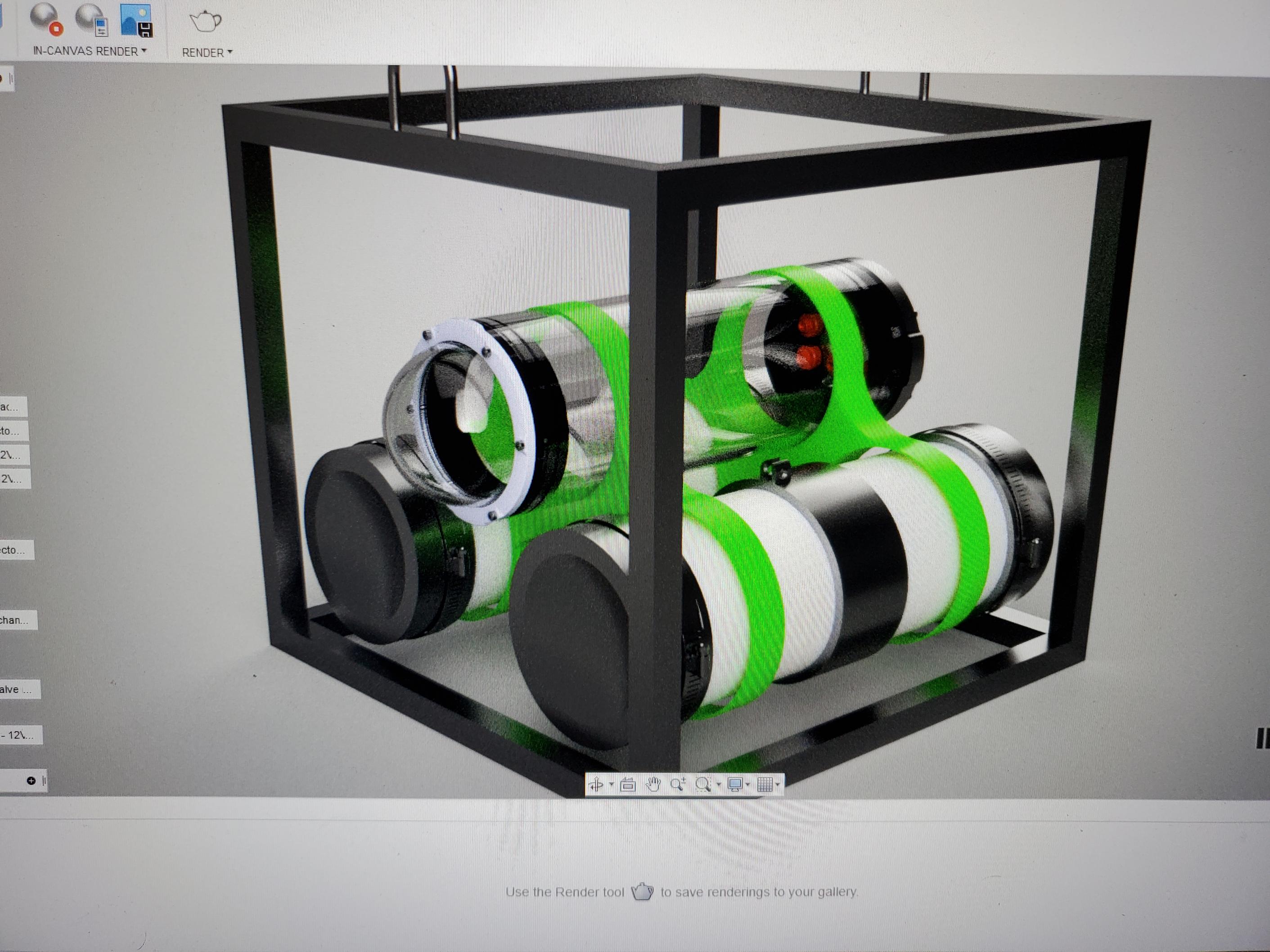

Can you draw a picture of what you're trying to do. And maybe take a few pictures of what you've done so far. I've been thinking about a variable ballast system also.

Ian MacKenzie wrote:Can you draw a picture of what you're trying to do. And maybe take a few pictures of what you've done so far. I've been thinking about a variable ballast system also.
This is the design im working with. The two outer tanks are the ballast tanks. Pvc which I will have to rethink if I want to use the high pressure system as it would require a pump capable of 73.5psi to force the water inside, and pvc is not recommended for applications where air pressure is applied...
