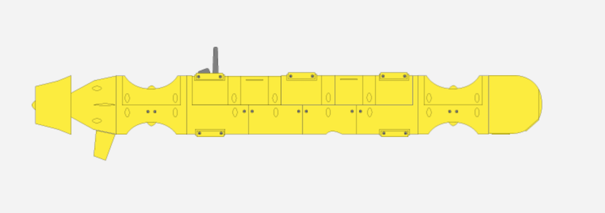

I am planning to make a Amethyst AUV Platform (https://beobachtung3d.com/) this summer.
This should be the final result:

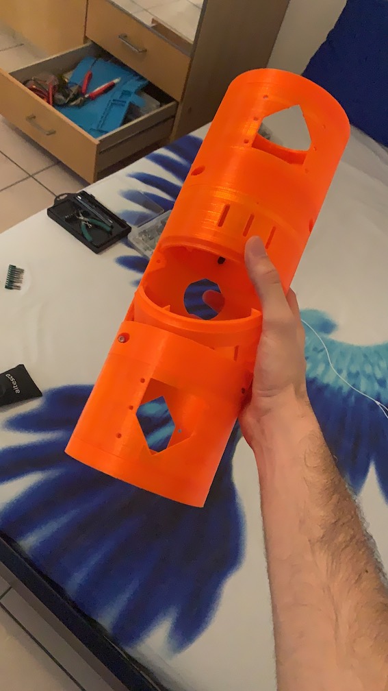

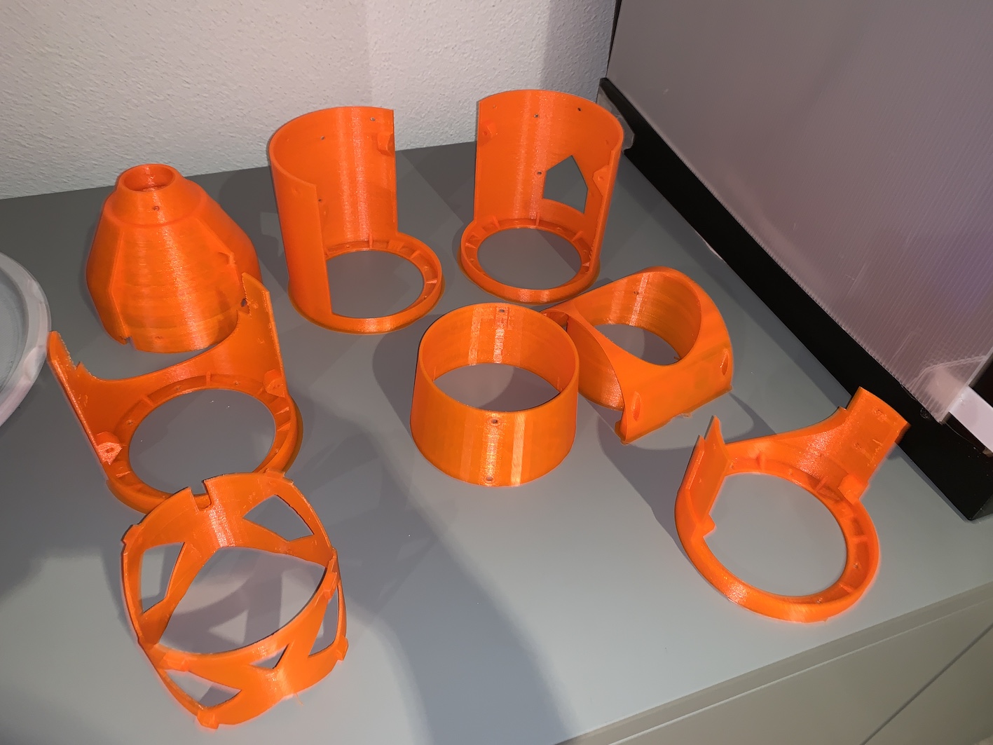

Here are the pieces I have printed so far...
I already want to ask you something... Do you think a plexiglass pipe with the two caps 3D printed is a good idea (the DIY way) or is it better to buy an already made and tested enclosure? The enclosure I have found and that seems really good is by blue robotics (this one: https://bluerobotics.com/store/watertig ... e3-asm-r1/) what do you think? Have you had experience with their products? Do you know better companys maybe in europe (I live in Italy).

Re: U-DRONE Amethyst AUV Platform
Posted: Jun 17th, 2020, 7:02 pm
In the quick tests I did 3D printed caps (even printed at 100% infill) will not be waterproof at depth. I would go with a ready made enclosure like you linked especially if you have some money wrapped up in the electronics.

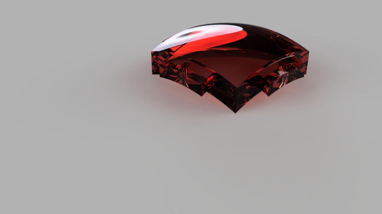

I made the 3D model of the front part. It has a detachable front so that I can insert a camera lens in it if i need or a probe such as a current flow probe.
Any thoughts?
Posted: Jul 3rd, 2020, 2:44 am
by fryslan76
Beautiful shape, only I think that the watertightness leaves something to desire. I think that you can achieve a better succes with swaping the whole dome if required. Because a flat surface is "easy" to make waterproof.
