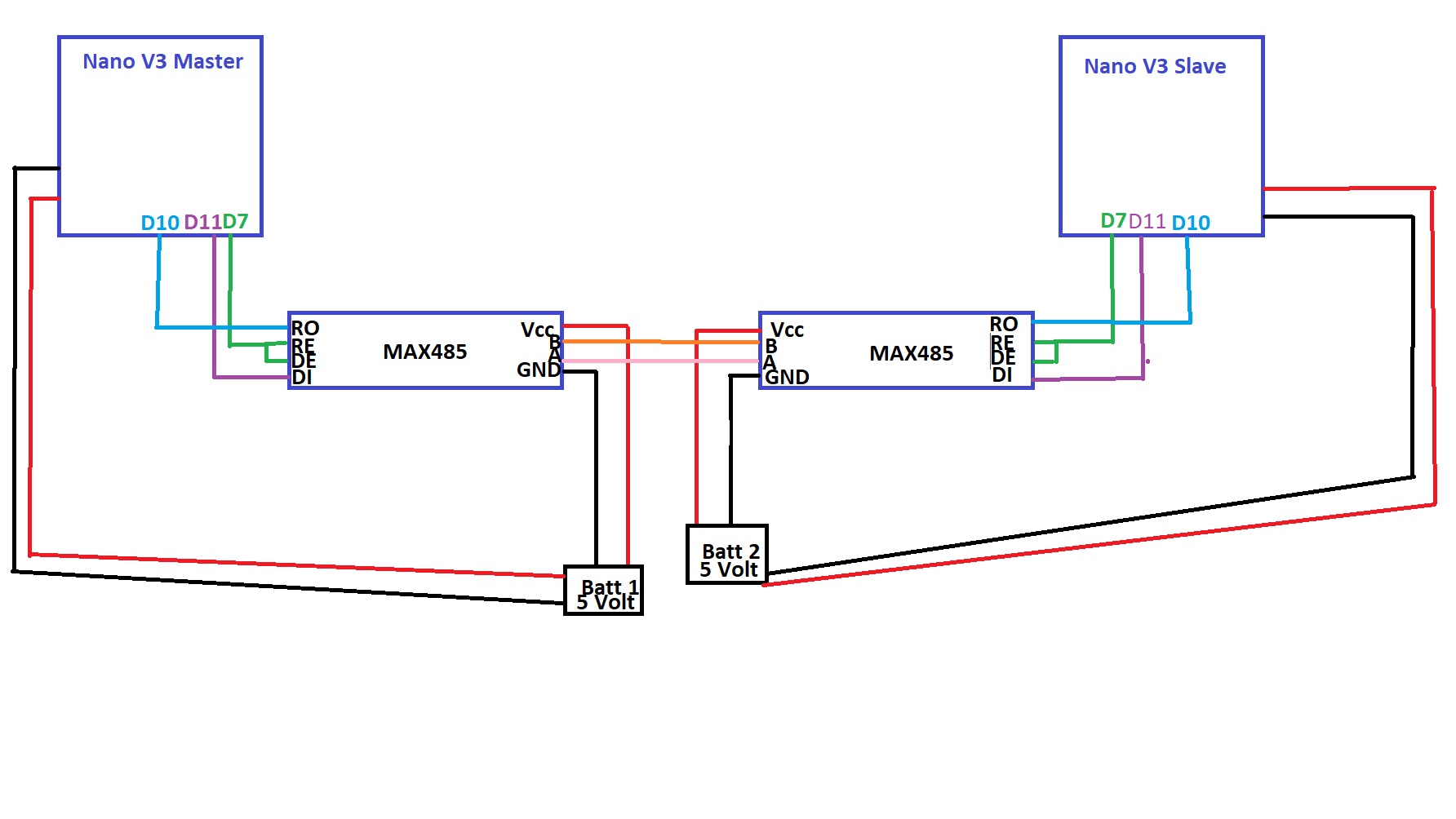

I uplode a scheme from my test wiring. I dont use Resistors and the Cable lentght is just 5 cm for testing.
Did I made anything wrong on the wiring?

Thanks for the link. :D
My Half Duplex Wiring is exactly like in the link.
However, there is one think what makes me crazy. If I connect Arduino with my Computer and open the Serial Monitor. The Connection works Fine.
As son I remove the USB I have the same issue.

I also try this example out
https://naylampmechatronics.com/blog/37 ... duino.html
And it works fine. Servo is driving exactly the analog input of the master.
I'm not sure what example I have to use for the thusters.
I see here many examples.
The http://www.techmonkeybusiness.com/rov-c ... ition.html sems to be the best, but he doesnt use the MAX485 and I would like to have a stable connection arround 100 meters. :o
