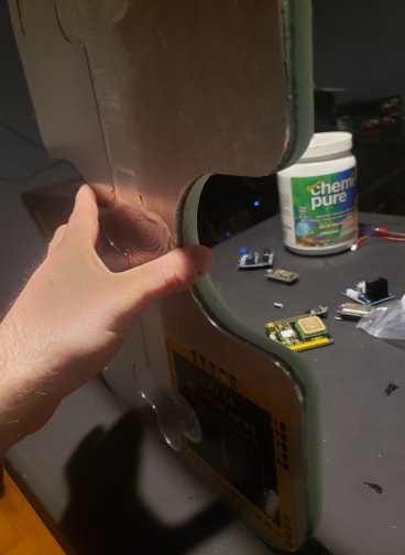

- First float, after cutting it I didnt think it was going to work.

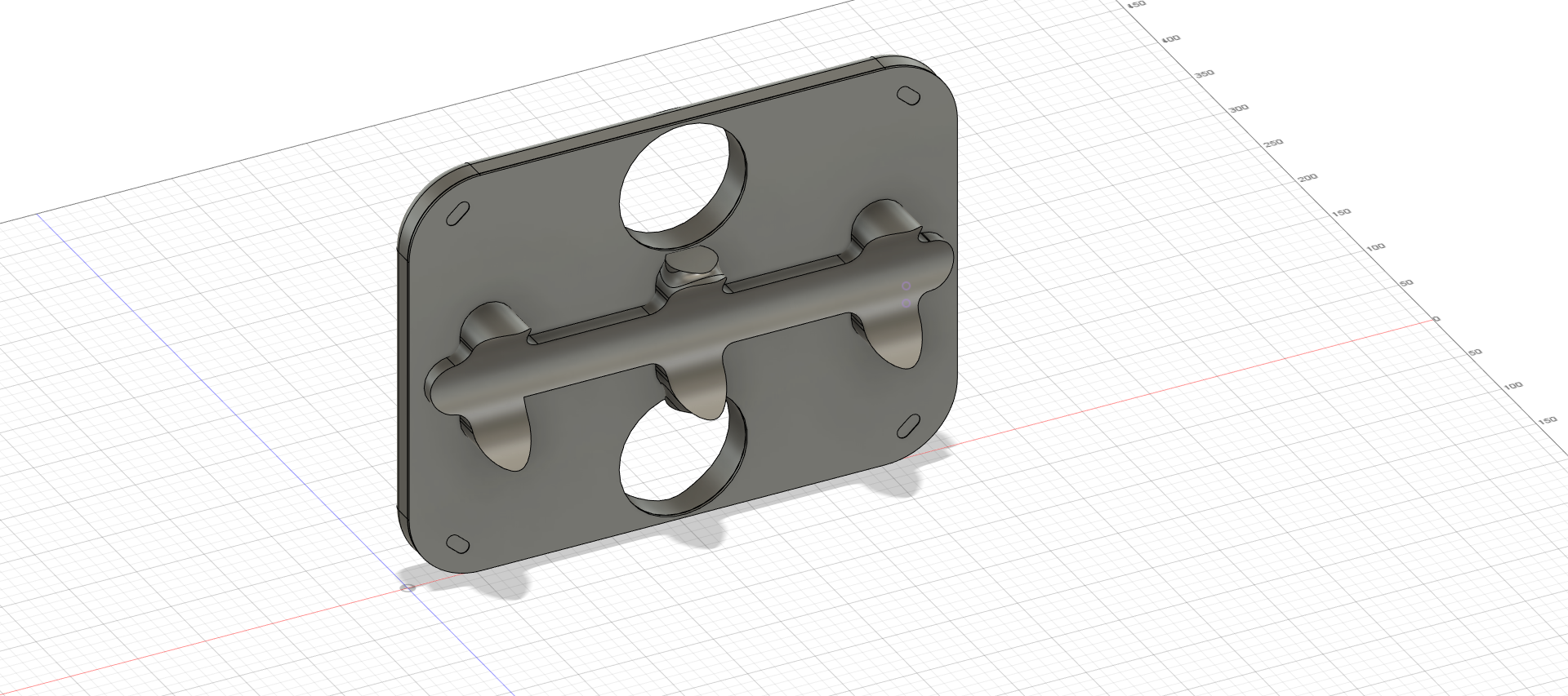

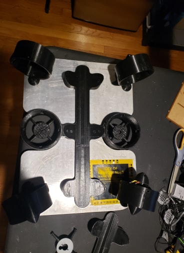

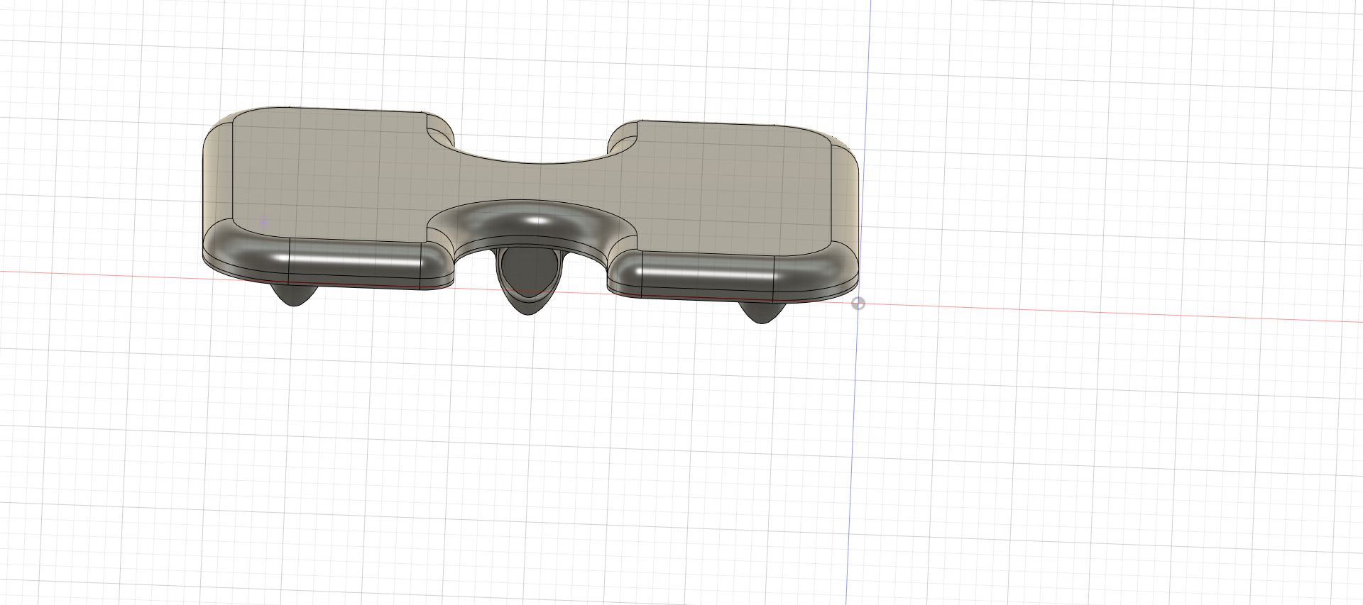

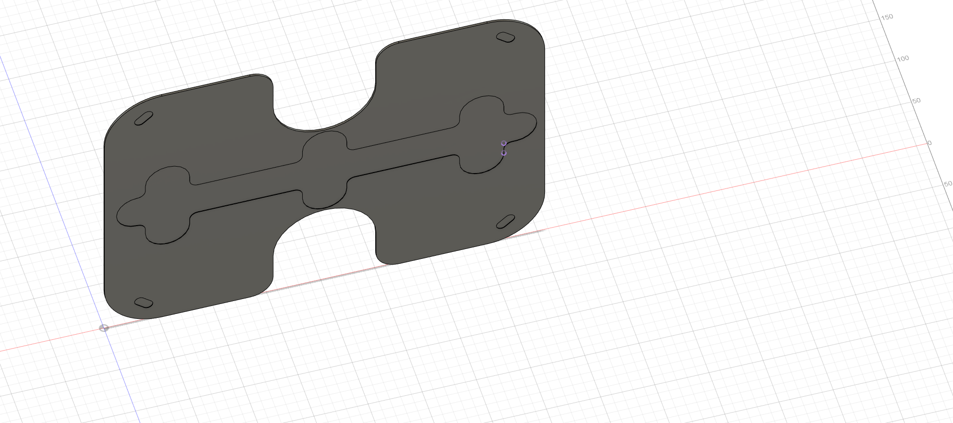

- This plate is what everything mounts too. its going to be CNC'ed out of a 2mm Aluminum street sign.
- ROV2 v1plate.png (310.23 KiB) Viewed 13409 times

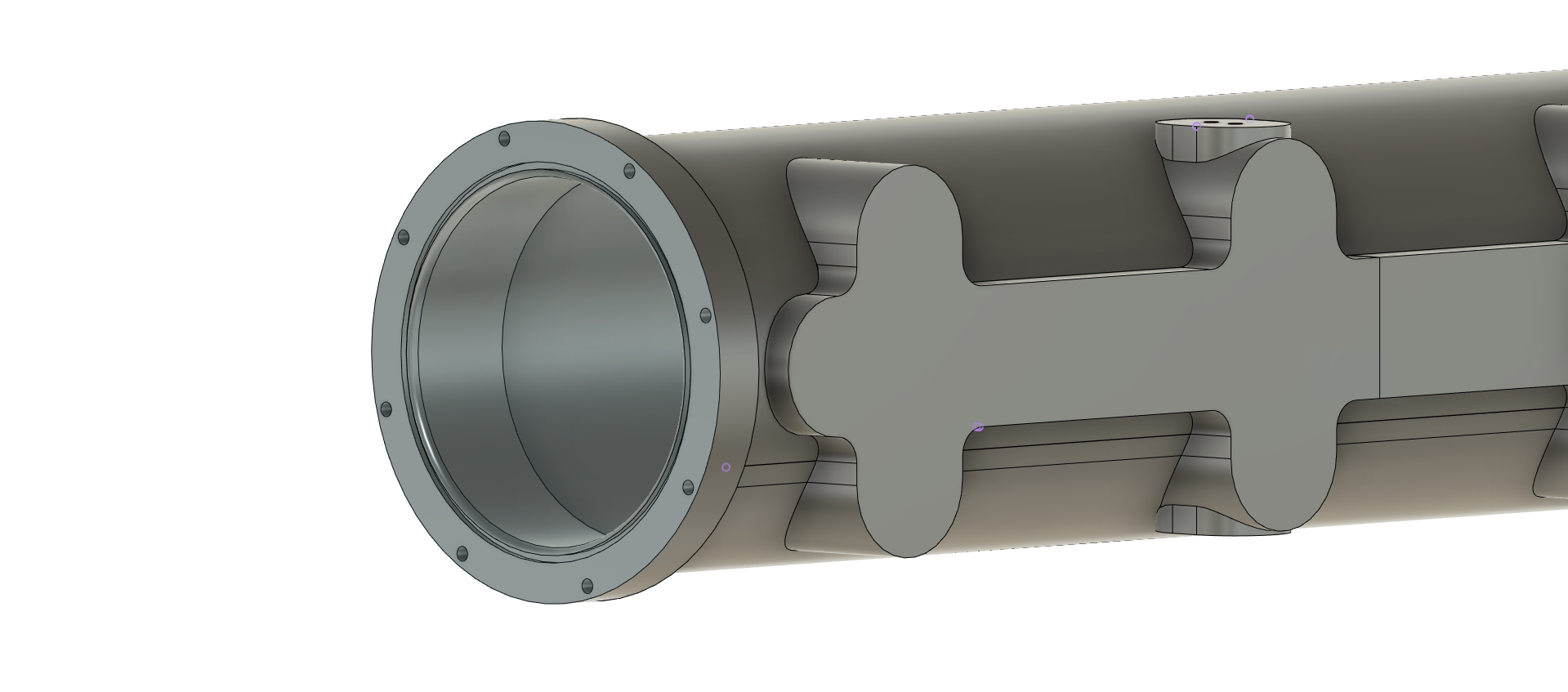

- This is what I plan on having done the next few days to mount the thrusters to until I can get around to finding 4 inch pipe I want to use.
- ROV2 v1all.png (269.08 KiB) Viewed 13409 times

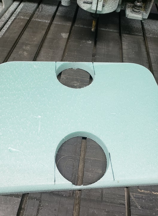

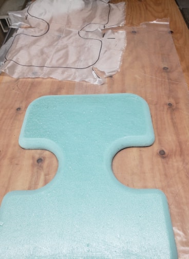

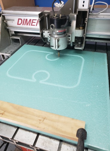

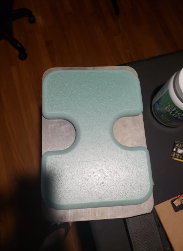

First CNC of the foam.
- ROV_Type__1578340949_55052.jpg (42.85 KiB) Viewed 13407 times

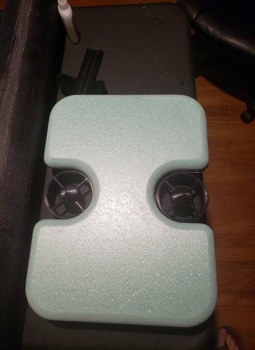

- Better idea
- Better Idea.jpg (66.61 KiB) Viewed 13407 times
- first cut
- First cut.jpg (40.73 KiB) Viewed 13407 times

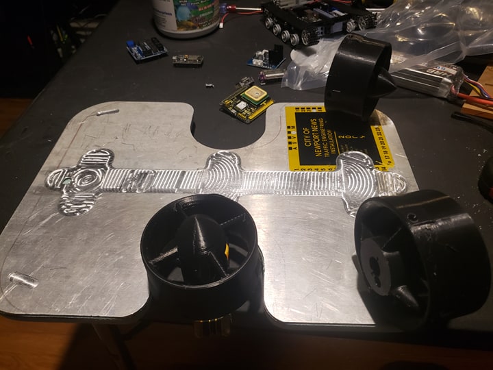

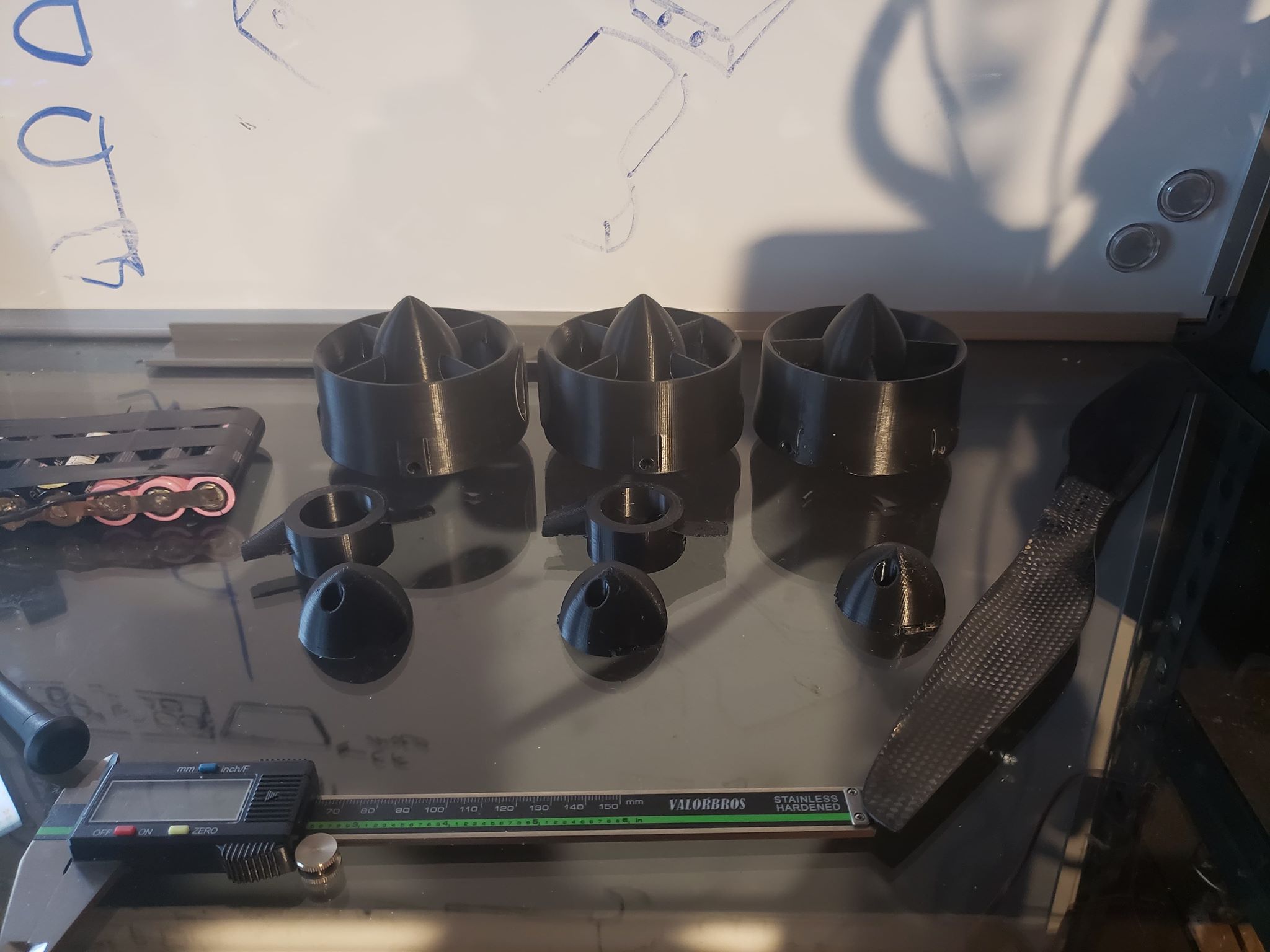

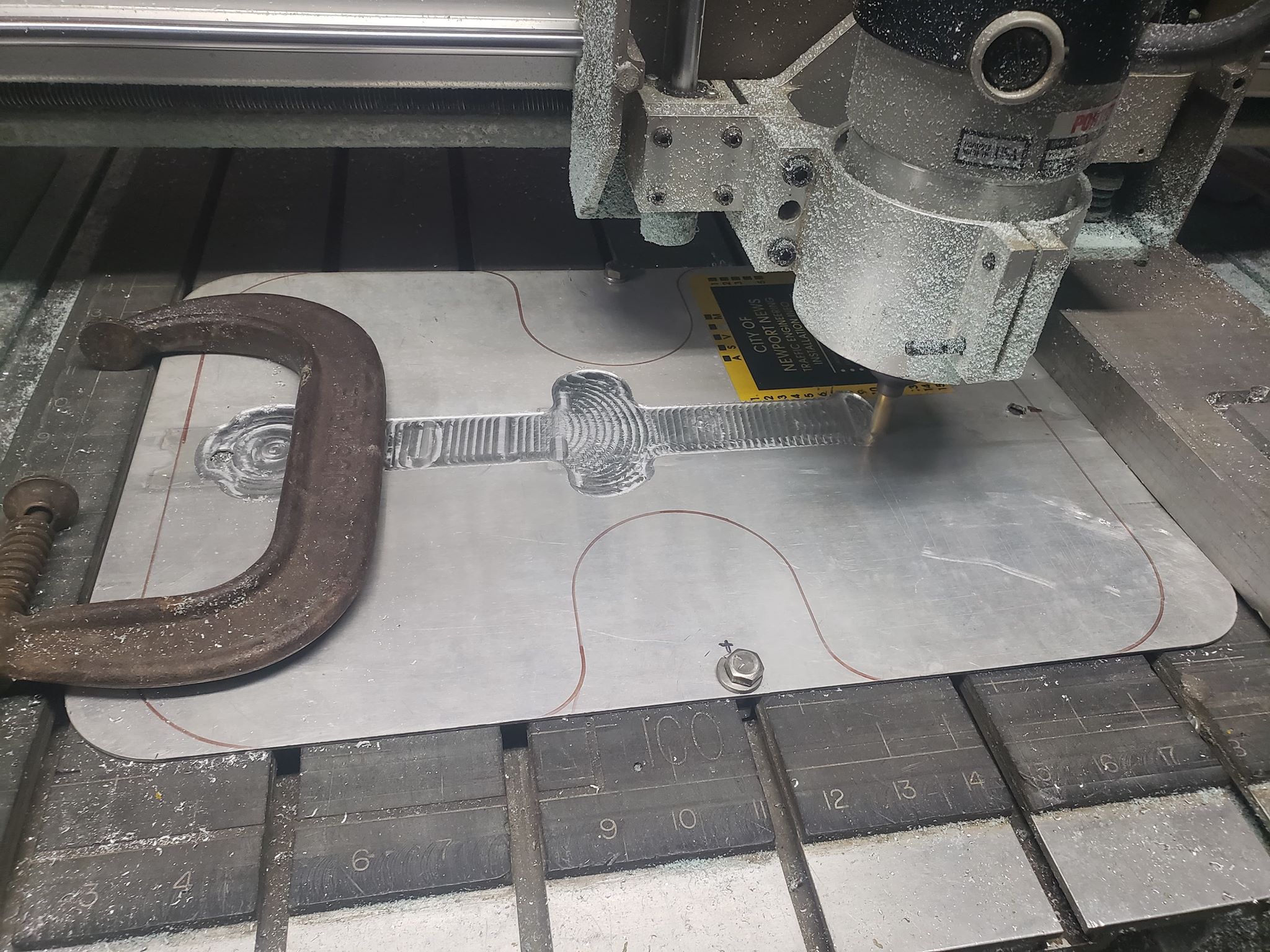

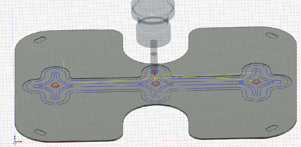

Current work for today is to get main aluminum plate that everything mounts to machined. In the mean time my 3D printer has been mindlessly running for over 40 hours to print out the thrusters, I should have all 3 of my printers up and running but that's a hassle. The main focus is the aluminum plate. I tried to machine it yesterday but my CNC didn’t like the Gcode for some reason. The foam milled out perfectly earlier in the day.

- 3 Down 3 to go
- Thrusters.jpg (205.49 KiB) Viewed 13397 times

Update for today: After struggling for a couple of hours I figured out my CAM processor sometimes makes the right Gcode for my CNC controller. I am still learning how to run CNC machines, I own 3, one I completely updated the electronics from the 90’s and got it running 100% this week. The aluminum sign I picked up from a scrap shop a few weeks ago for cheap along with about 30lbs of aluminum scrap. The sign wasn’t perfectly flat so the center finish isn’t too perfect but I couldn’t be happier with it. I want Scout to look professional which for me is a new way about inventing stuff for me, I build things to work but they don’t always look pretty so I’m challenging myself with this task not with this but future Drones/UAVs/ Planes Ect.. So I have been thinking about what am I going to use as a body to house electronics I really don’t want to use PVC or acrylic, Aluminum is nice but I wanted to make this unique so I’m going to use a 4 inch piece of Carbon fibre tube that I made a while back for a long range UAV. Here are the pictures of today's adventures the only reason why you guys actually click on pages.

- Made a few mistakes Milling but I am quite happy that I actually got this thing to come out without having to pull out another street sign to destroy.
- plate wasnt quite flat.jpg (521.53 KiB) Viewed 13391 times

Not much planed for today. I practiced cutting out a PCB board for power distribution. 5 out of six thrusters printed the last one is on the printer now. I may do a little CAD work today for the electronics tray. But I’m waiting for my largest printer to get done so I can print the rail system. I’m planning on reinforcing the 4 inch Carbon fiber tube with about 4 more layers tomorrow and covering the foam float in epoxy to seal it to get it ready to be wrapped in carbon fiber and vacuumed bagged.
- some what starting to look like an ROV
- ROV2 plate v1.png (388.87 KiB) Viewed 13357 times

1. Your avatar pic (m249's or m240's?) makes me think of Burt Gummer arguing with his wife Heather on the roof about which gun is better, and therefore worth carrying with them. (Tremors) "Should we take the .300 Win Mag or the .22-250?"
2. Is that syntactic foam or just regular blue extruded polystyrene? Cause XPS will crush under pressure.
3. I'd go with aluminum pipe for both strength and heat dissipation, as well as ease of welding. You can get a carbon-fiber vinyl wrap if you want to make it look 'pretty'. Carbon-fiber is gonna be hard to mount stuff to...easily.

2.I’m pretty sure its just extruded foam, I did have some concerns with it imploding on itself or being crushed so I’m going to coat it in epoxy to give it a layer of water proofing then a few 1 Oz coats of of glass cloth and then a final sheet of Carbon fiber vacuumed bagged over it. Hopefully that works if not it will have a tether to pull it from its watery grave lol “learning experiences”

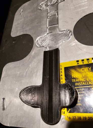

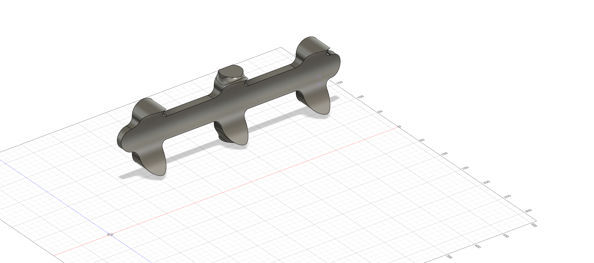

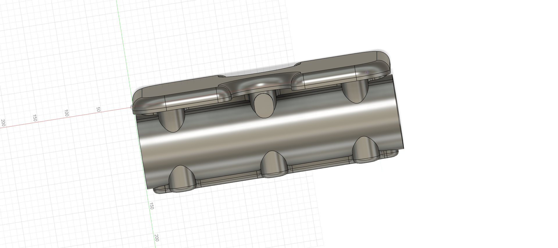

Worked on a couple of different parts for scout today. I CAD’ed up a flange that I tired to CNC out of MDF (particle board) so I could ram up a sand cast and pour a aluminum one but I need to re do the CAM for it the feeds and speeds were way to high. So I moved on to another couple of projects, I started to print out the rail system to hold the tube and vertical thrusters, however I should have been smart enough to realize that that the perfect tolerances that CAM software gives me doesn't transfer over to a 3d printer too well so I had to resize the rail and reprint it for it to fit into the slot I machined into the aluminum plate. While that has been printing I have started to pull out electronics and build thrusters. In the mean time I have not found any viable (cheapish) 30 amp forward/reverse RC car brushless ESC’s for this build, so I’m having my Nerd friend Rion design a PCB set up and write some code for it. I will get as far as I can for now but I may need to order some more motors, disposable cups, paint brushes, and some vacuum bag material all for the Carbon fiber/ Glass lay up process. I did find out that using a soldering iron to smooth out and anneal 3D prints works amazingly, I did it on the thruster props to smooth them up and it ended up making them a little stiffer too

- scout flange.png (339.49 KiB) Viewed 13323 times
- flange.png (192.39 KiB) Viewed 13323 times

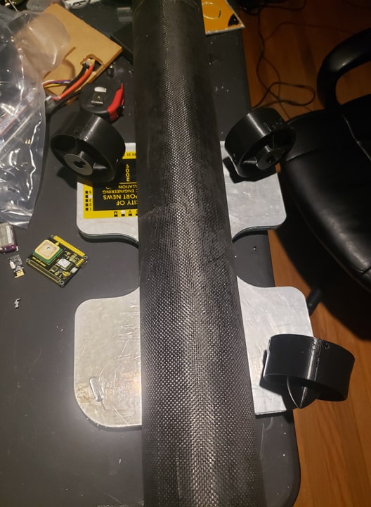

Not bad for 5 days of work.
- tube.jpg (38.62 KiB) Viewed 13303 times
- thrusters installed.jpg (37.49 KiB) Viewed 13303 times
- thusters install.jpg (30.41 KiB) Viewed 13303 times
