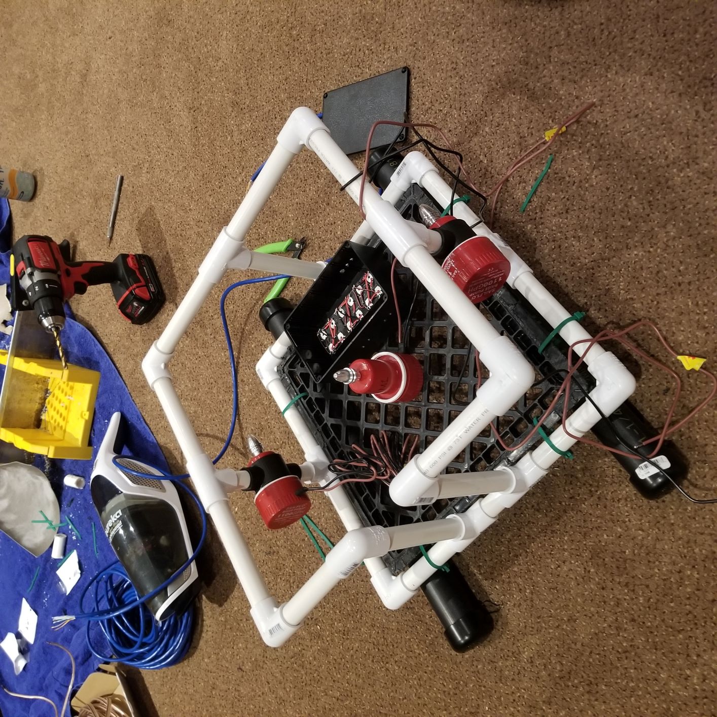

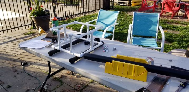

So I had a project to do for school and I decided to build an ROV. I ended up finding this website and went ahead and followed the information provided about the Seafox to make it happen. So it's only right if I share what I've done and the building process :)
first cuts.jpg (69 KiB) Viewed 10639 times

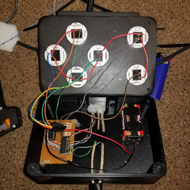

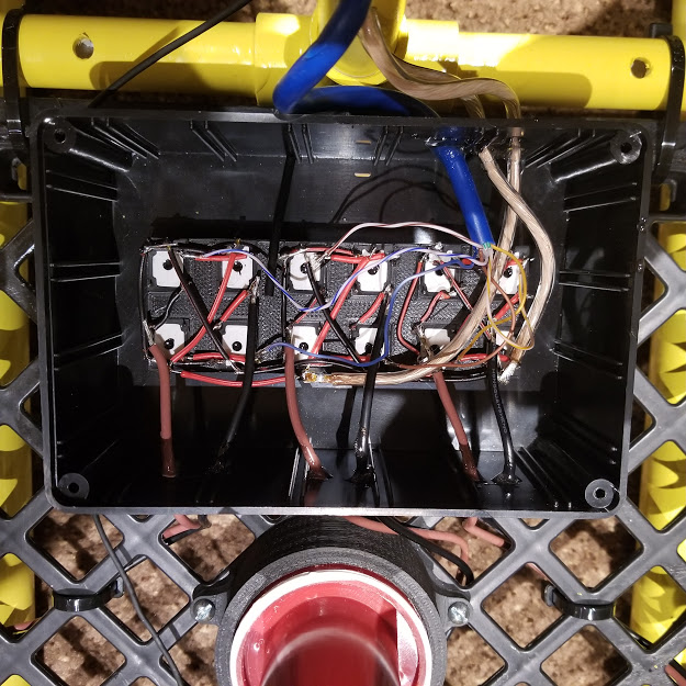

contorllloer circuit.jpg (172.2 KiB) Viewed 10639 times

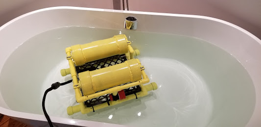

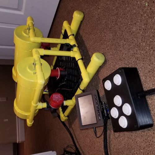

Testing has been limited however cause of lakes being frozen, so I had to make due with what I had to test!
rouv bath.jpg (31.87 KiB) Viewed 10639 times
So far it seems to be working pretty good, but my floats are oversized so I got to fix this problem. So now I am looking forward to warmer weather to explore the unknown depths of the lake near my house!

I could use some explanation as to what the IC's on the breadboard do.
The floats are fine, just add more weight until it is just slightly positively buoyant. Then when you get near the bottom, you'll have to run your vertical thrusters to keep you there. Water jetting upwards will disturb much less silt than water jetting downwards.
I see your floats are bolted through the frame...make sure there are holes in the top and bottom of the frame, so it can flood during immersion, so the buoyancy doesn't change slowly as water seeps into the hollow frame.
You might put the vertical thrusters on a PWM controller, so you could set a certain level of thrust and leave it there.

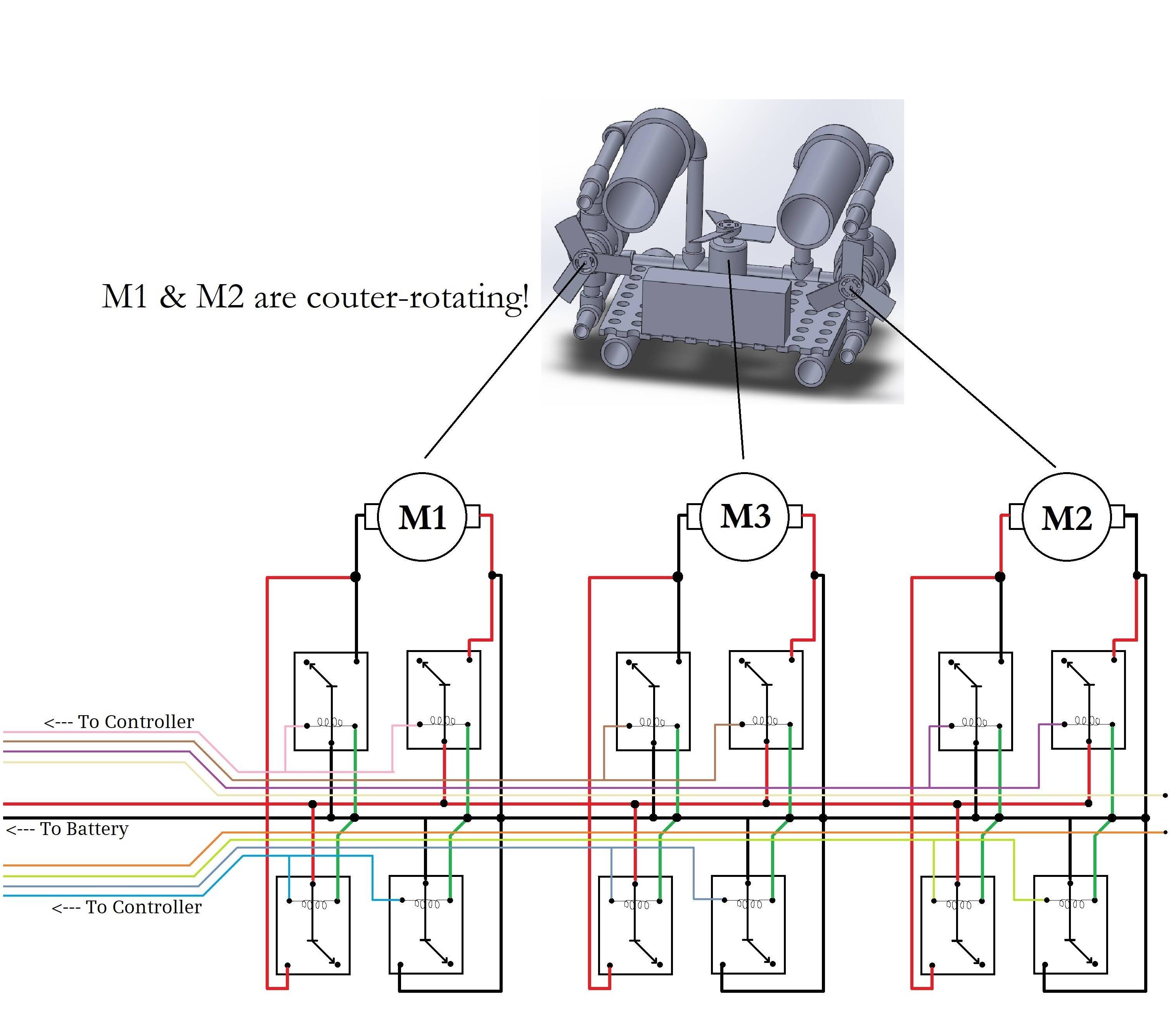

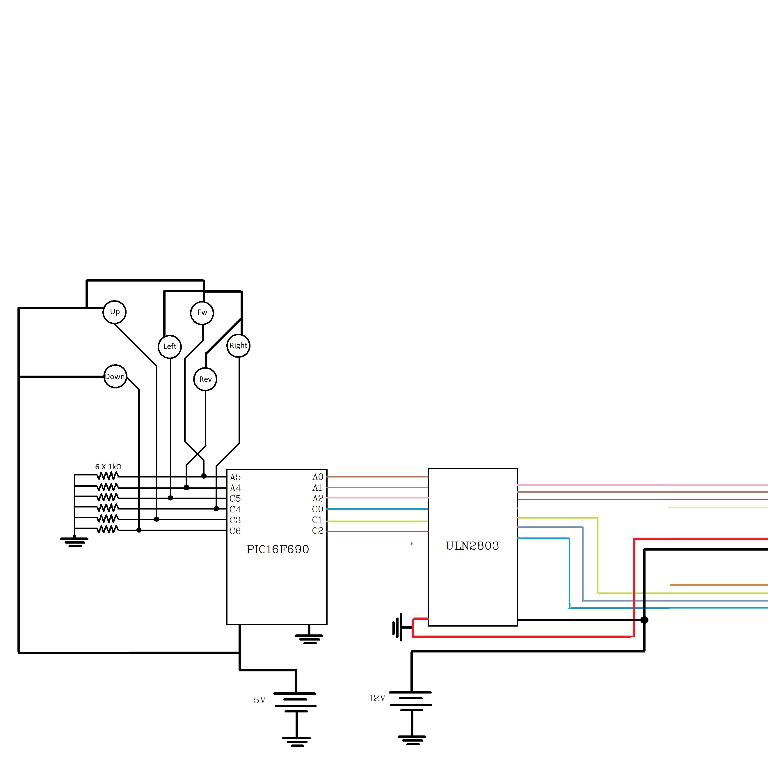

Thanks for the information! I'll look into adding these things as I continue to test my ROV. And about your questions, the IC's consist of a PIC16F690 microcontroller and an ULN2803A Darlington transistor chip, the PIC takes the button presses and fires the coils of the relays which control the motors. I'll attach a schematic of the whole system.
And for the ice, I wasn't too sure if the cold could impact the ROV negatively. Also right now the ice is not thick enough, maybe in a few weeks I'll give it a try.
And I just worked out how to attach photos properly!
Control Schematic pt 1.jpg (318.48 KiB) Viewed 10642 times
Control Schematic pt 2.jpg (453.09 KiB) Viewed 10639 times

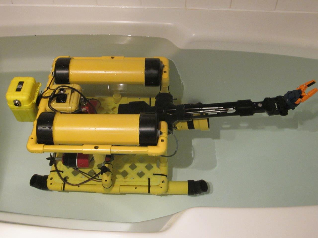

Nice! The ICs are a great idea. I did my first test in a bathtub too.
ROV bouyancy test 010.jpg (96.12 KiB) Viewed 10588 times
