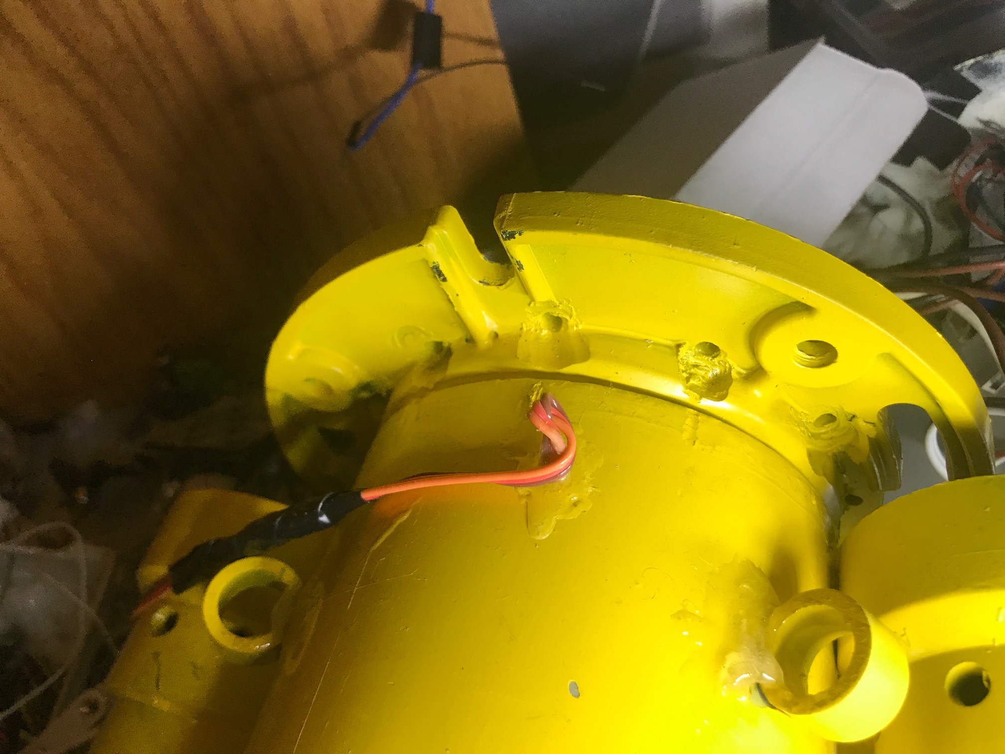

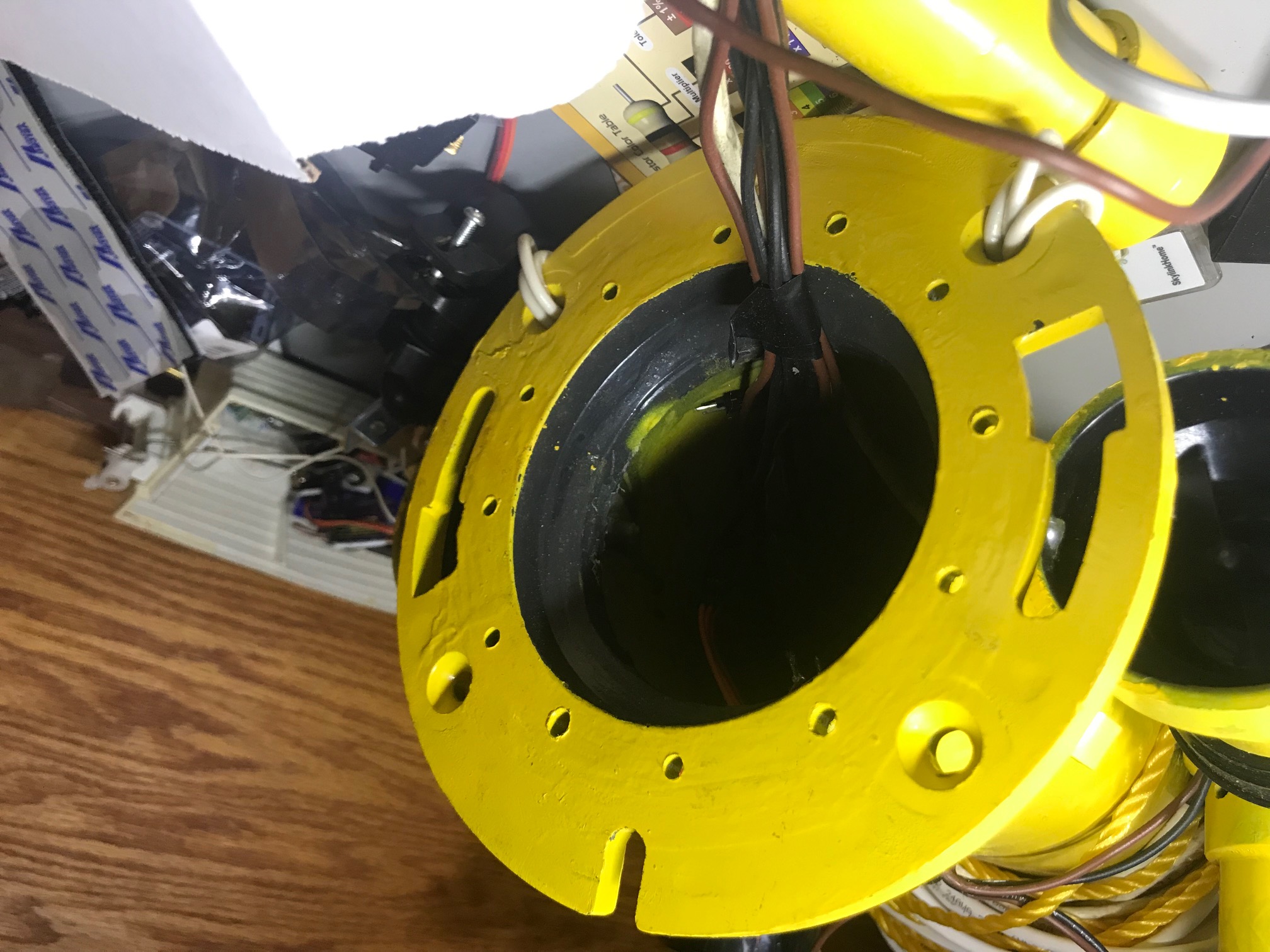

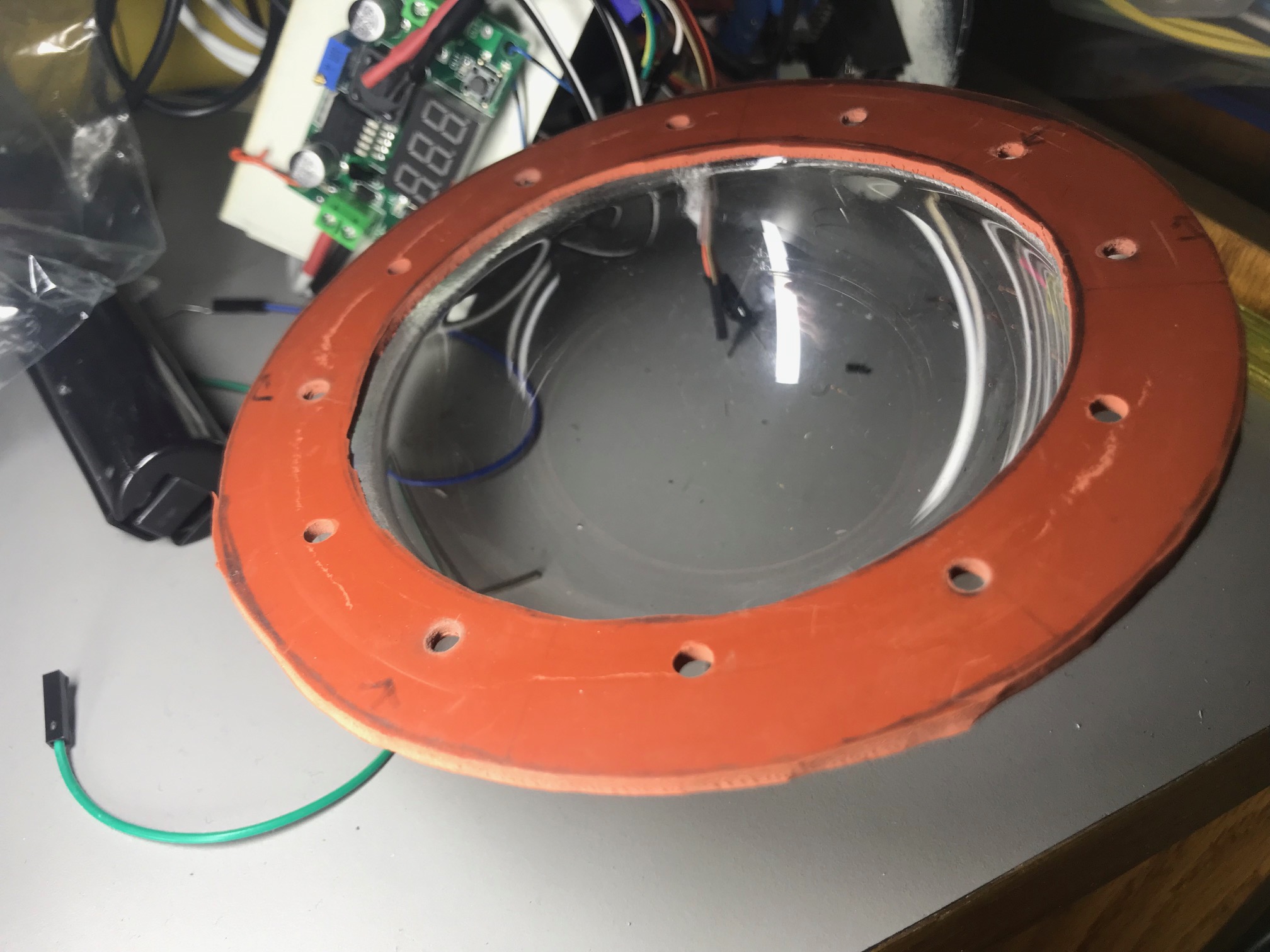

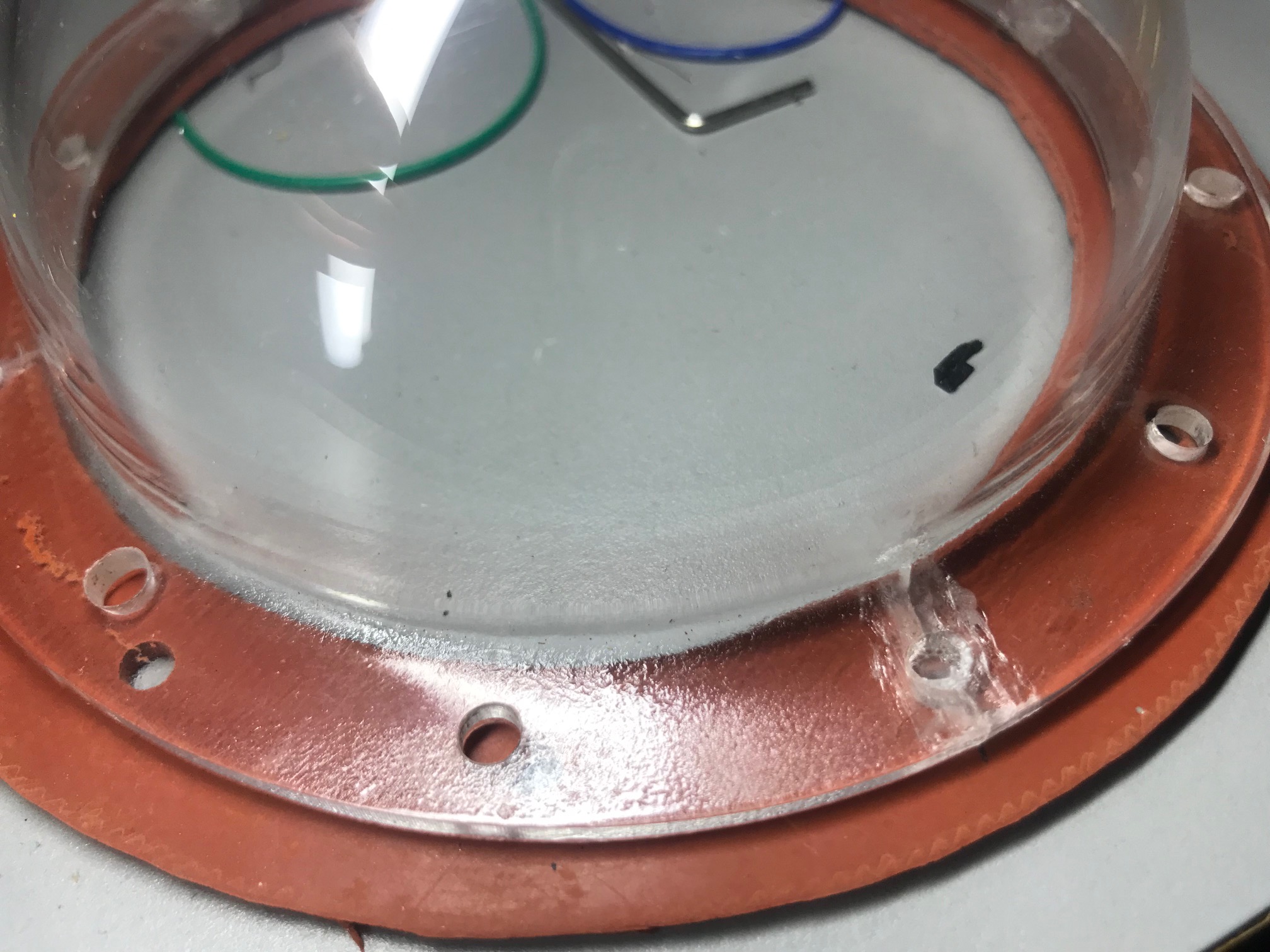

My ROV hull is made from PVC plumbing parts. A large, 4" PVC tube for the main structure. I used a toilet flange on the end where the lens cap is to be fastened. I made a custom-cut rubber gasket that would go between the toilet flange and the acrylic lens cap. I drilled additional holes in the acrylic lens cap so I could have more places to tighten the lens cap with bolts and screws (to ensure leaks won't occur). I realize that I shouldn't over-tighten the lens cap, and I tried not to. But a couple of hairline cracks started forming on the acrylic lens on the newly drilled holes when I tried assembling (probably due to tension on the new holes from the bolts). I tried gluing the cracks with special acrylic glue (that "melts" the acrylic back together), but I have my doubts that will be good enough to water-proof my ROV down to ~70 foot depths (freshwater).
Additional note: The bolts that I used for fastening the lens cap to the toilet flange are not perfectly straight. A few of the bolts are at slight angles. This is worrisome, since this means the pressure of the bolt head will not be uniform around the acrylic holes. Furthermore, slight flexing of the acrylic dome base is noticed when I tighten the bolts a little. Either the acrylic lens cap is too thin to be used in this manner, or I am over-tightening the bolts. But I don't think I over-tightened.
Would really appreciate hearing the communities input. I'm open to other ideas, but I think these are my options:
1) Push ahead with this strategy. Either using the existing dome lens cap or maybe replace with a new one.
2) Ditch the acrylic lens cap, and opt instead for a thicker (between 1/8" to 1/4"), flat, piece of clear acrylic (for the lens cover). <-- This is my favorite option at the moment
3) Buy a really large metal or PVC washer to place around the lens cap. Drill holes in it for my bolts. This way, the head of the bolts won't create uneven pressure points on the acrylic lens. <-- This might be good to use with option 2 as well.
4) find some sort of C-shaped clamps than would hold the lens onto the toilet flange (pinching it closed, without using bolts). But I couldn't find anything suitable like this.
Thanks in advance for your thoughts.

- This is the custom-cut rubber washer I designed
- IMG_9279.jpg (457.36 KiB) Viewed 50089 times
- Lens cap. Note the cracks where I drilled the new holes. I tried "gluing" it back together with a special acrylic glue.
- IMG_9281.jpg (526.79 KiB) Viewed 50089 times

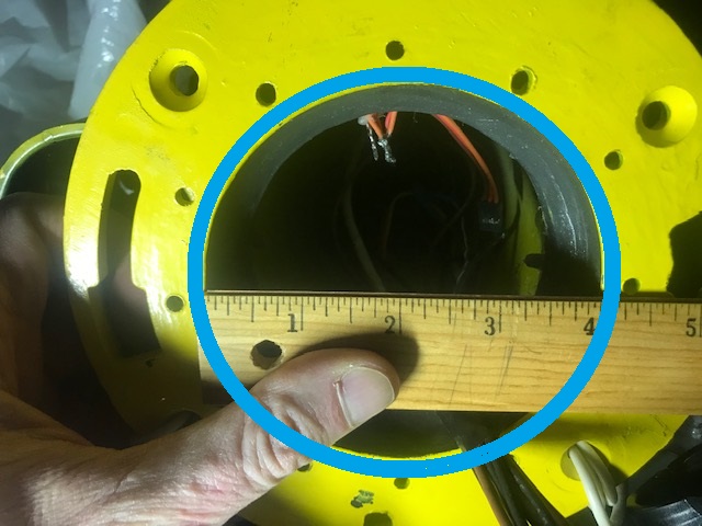

If I got an O-Ring of that material, it would *just* fit between the screws and the opening, please refer to my attached picture. But I wonder if a round 1/4" gasket will be sufficient...a sheet of the material could make a better gasket, for sure.

You could... but as you plan to go to about 70 feet depth, the external pressure on the o-ring will be just over 2 atmospheres, or about 30psi above the that inside the hull. There's a good chance your o-ring would not withstand that and it would just pop inside the hull. You could add a lip just inside the hull to stop the o-ring slipping in, or even better, get a groove machined into the flange to take the o-ring.
If you don't machine a groove you also risk breaking the dome by over tightening the bolts. The best and probably easiest solution is to buy a small sheet of fluorosilicone and cut a gasket.
*Edit* I t looks like you don't have room to machine a groove so that leaves adding a lip or making a gasket.
