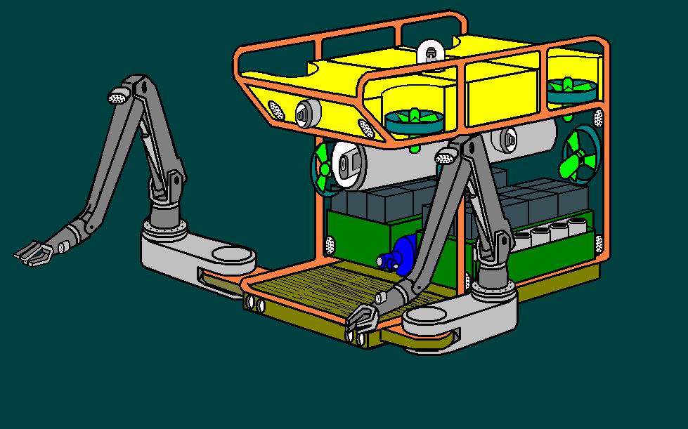

Since i don't have anything in the water yet, and this section seems to have had recent activity, i'm going to post my parts list and design illustrations below. Keep in mind this is for a 60" long x 40" wide x 42" high small work-class rov. 6-dof with (2) 10-dof manipulators. 8 onboard cameras. (8) 400KV brushless thrusters. 235Ah FLA battery pack at 18VDC. Adjustable bouyancy. 8" dia, 48" long 3/8" wall aluminum pipe for the WTC. 8" dia 1/2" wall acrylic hemisphere for the main 78x zoom camera. Pan/tilt on the front, top, and rear cams. Live viewing of all 8 cameras at once. 32 sample/tool containers. 22k+ lumens of LED's.

- Best Features - New.JPG (91.28 KiB) Viewed 7744 times

Your design appears well thought out and doable. Good luck on scrounging for parts.
My ROV project is about half done, but progressing slowly because I keep thinking of better ways to do things, such as using magnetic coupling for gripper motors.
I have acquired various components from Blue Robotics have been very happy with their quality, fair pricing, and prompt service. Using their thrusters has saved me a lot of stress from trying to make my own. Same with the end caps, hull penetration hardware, and potting kit.

I'm looking to design a 7 function manipulator for my next ROV. I was thinking mini hydraulic rams. I'd like to see your ideas/sketches. Maybe collaborate. I'm going to 3D print whatever I design. it'll probably be about half the size of what you're going for.
Re: Hello from Illinois (soon back to Arkansas)
For ROV's of this size I'm more of a fan of linear actuators over hydraulic rams. Easier to control an electric motor than the flow of hydraulic fluid. Cheap too, especially if you build your own linear actuators out of cordless drills and threaded rod. Inside a bicycle innertube flooded with mineral oil?
I don't have a 3D printer but I'd like the Creality CR10-S4, 40cm3 print area and $570.
Since i have a welder I'll probably build my manipulators out of aluminum. I'm not sure 3D-printed parts will stand the stress applied by linear actuators.
On the hydraulic side of things, I've seen some fine control systems out there, namely SteelWrist. They just showcase their products, but as a knowledgeable man (read: mad scientist) i can tell they're using servo-controlled proportional hydraulic valves. https://www.youtube.com/watch?v=MAkn_6Osmco&t=797s
I've seen some small-scale stuff done with high-end scale construction equipment. But it's commissioned by the company that builds the full-size equipment, then awarded to top-dollar clients, mainly. https://www.youtube.com/watch?v=2D2ocn4NAQg
As to building a small ROV, remember, the larger/heavier you make your ROV, the more stable it'll be. It's a combination of how far the buoyancy is from the ballast, and Newton's 1st law.
Sure, i'd love to collaborate. That's why we're members of this forum, right? I'd be glad to help.
