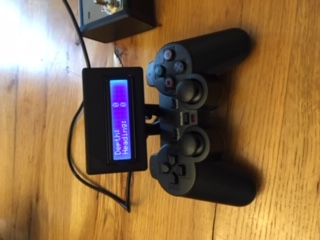

PS2 controller with screen top side

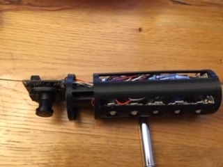

arduino electronics payload with tilt ip camera

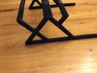

shots of mock up frame

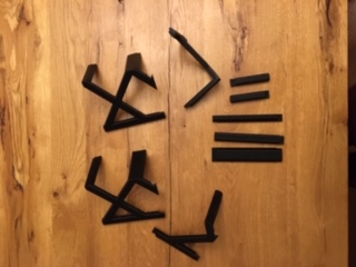

after 32 hours or printing

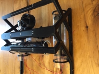

this is the almost finished.....

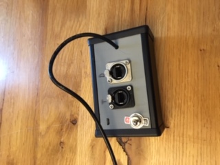

top side battery for the controller/arduino also we can pass along Ethernet data for a laptop to see the ip camera.
Im waiting for one for connector to come in so i can plug and unplug the controller.
