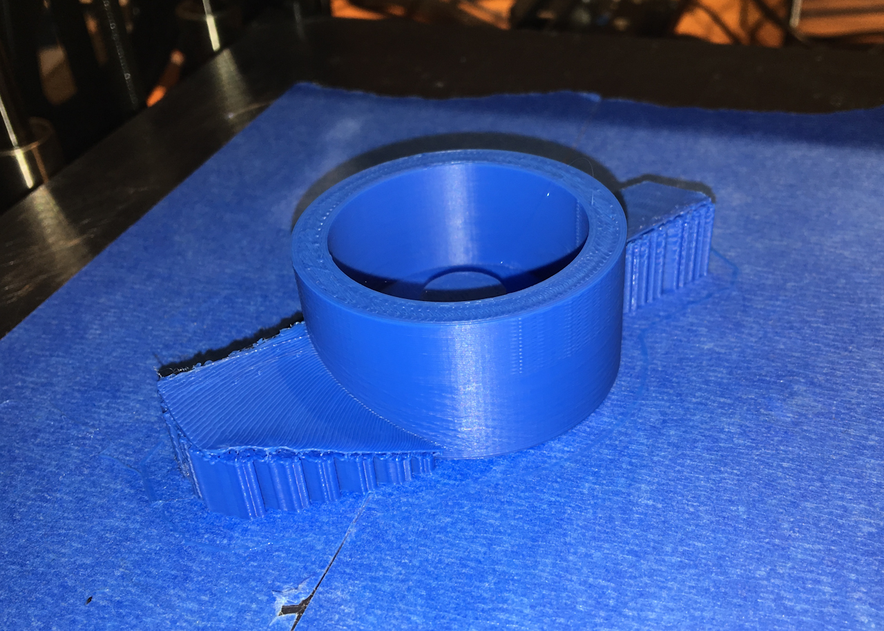

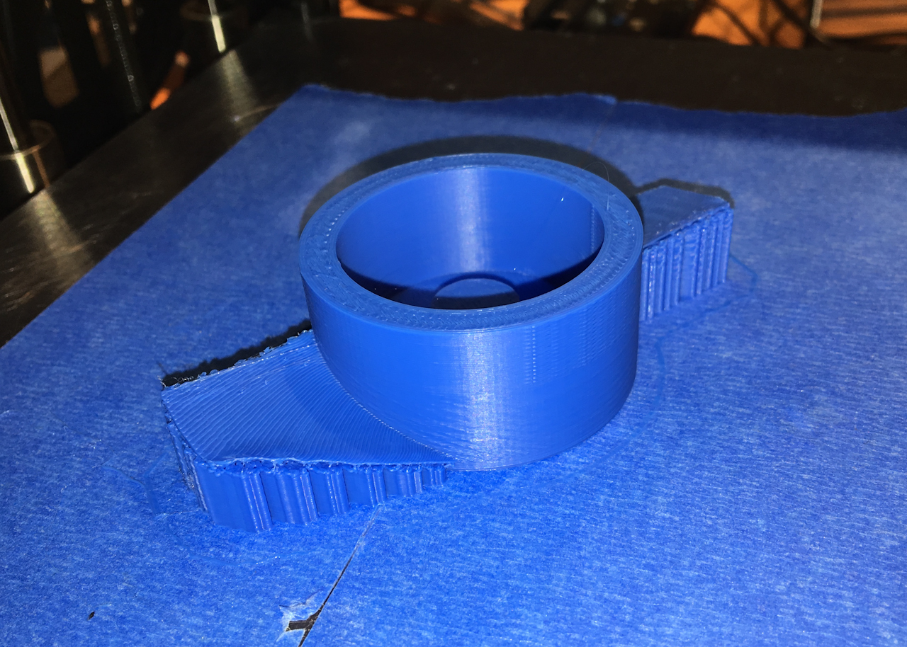

Got the first piece printed up, this is the mount for the actual bilge pump.
It's a little rough but being a prototype I use some cheap Chinese filament and just used some generic print settings because I have never calibrated this stuff yet. I printed it pretty fast with a high layer height and with only 10% infill so there's no way it will be water proof but this is just for proof of concept so it doesn't matter.
The good news it the pump slides right in without any sanding as I made the tolerances greater in this design.
For the prop I just hollowed out the rear section and added a riser in the center for the shaft. I will be secured to the shaft with a 6/32" set screw for the testing.
Next to the printer it goes....

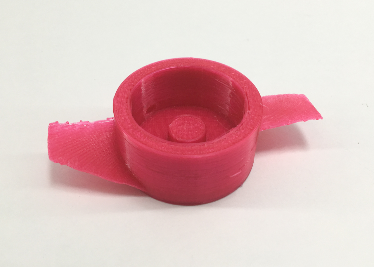

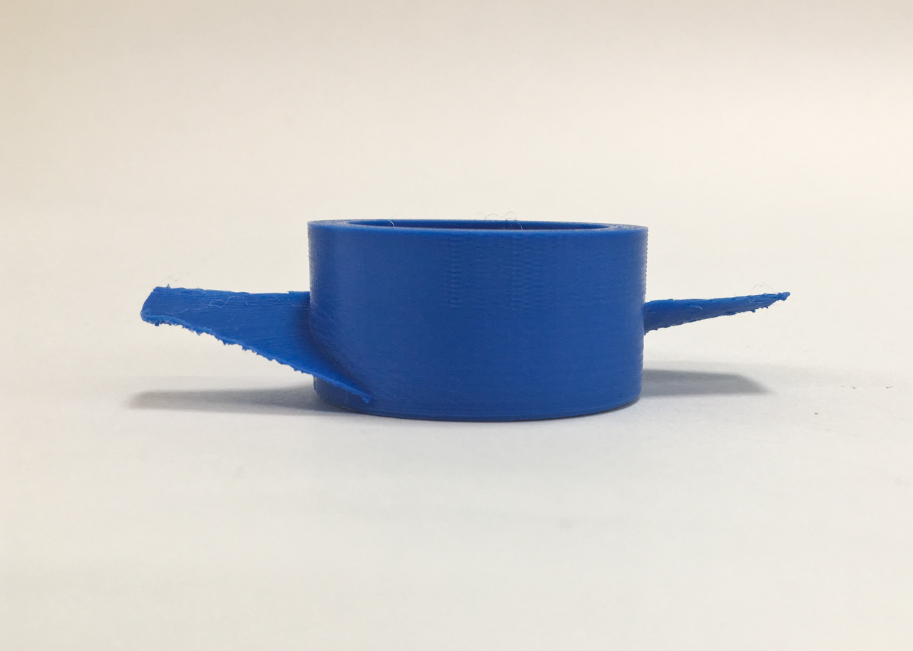

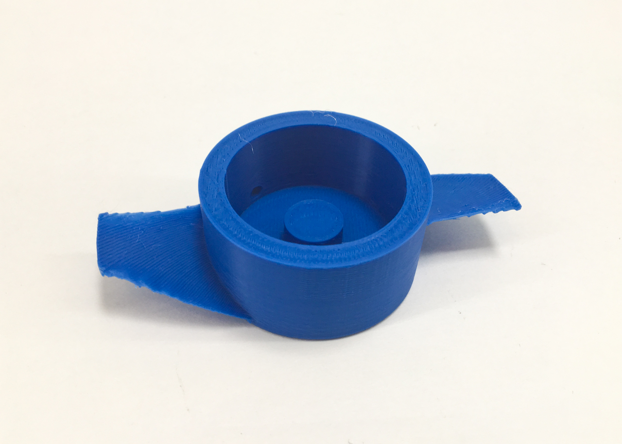

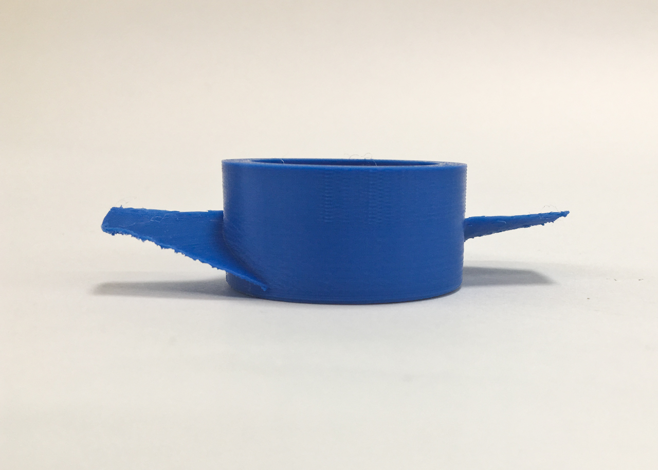

I gave the prop a try with the same crappy filament and ran into some issues. (I had a feeling printing this would not that easy or straight forward becuase of the angles of the blades)
The blades are so thin that the edges are tending to warp when printed in PLA. (Things would probably be a lot easier with a duel nozzle printer that could print with water soluble supports.)
I could probably heat the edges up and bend them back to the correct positions if I wanted to but I thought I'd try a different material. (PLA isn't the best choice for outside items anyway.)

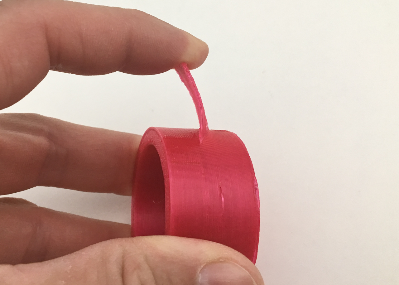

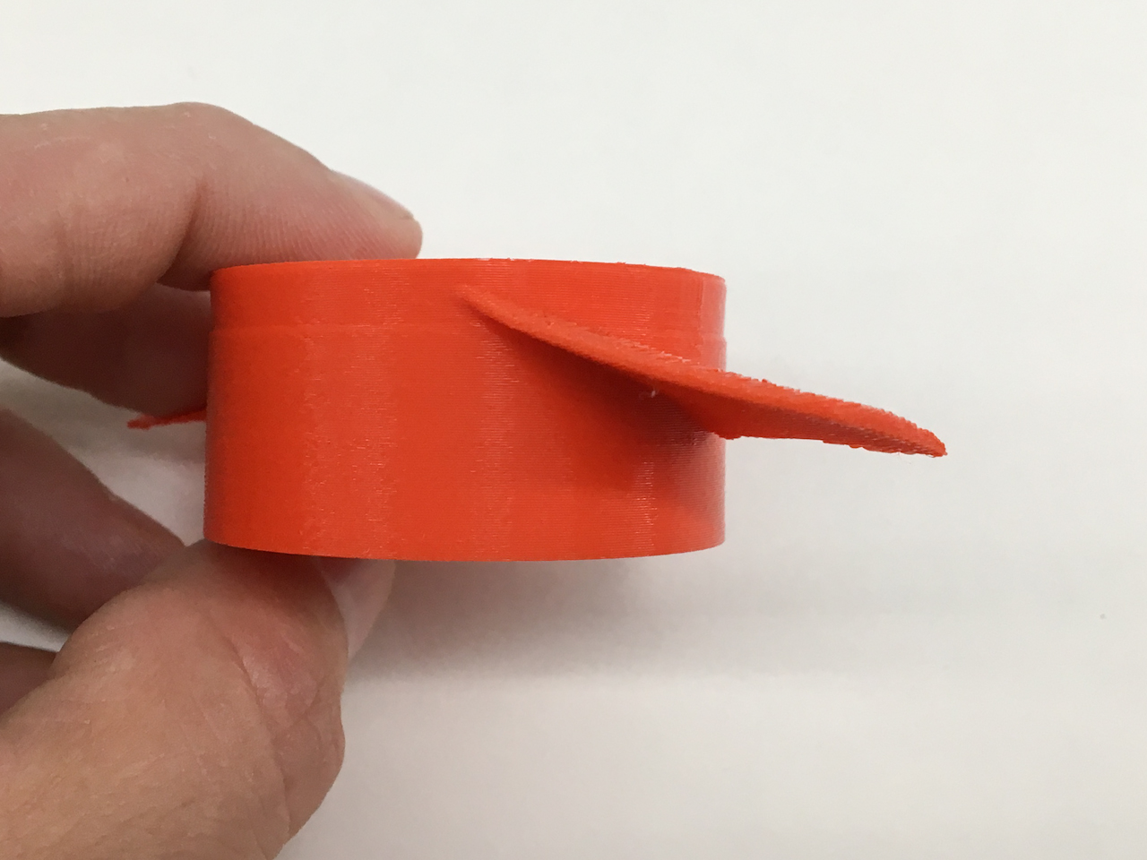

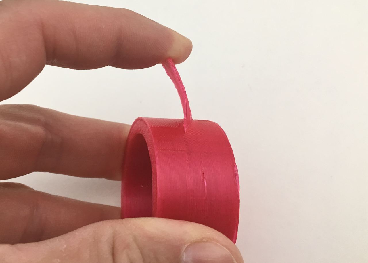

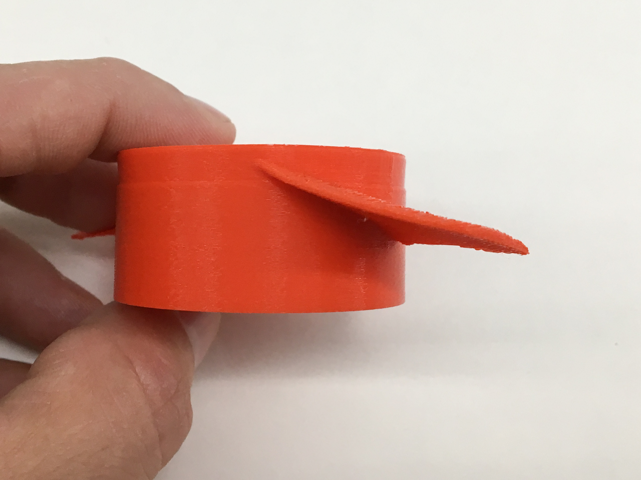

I next tried to print a prop in PETG and while it came out a lot better....
... the blades are way too flexible.

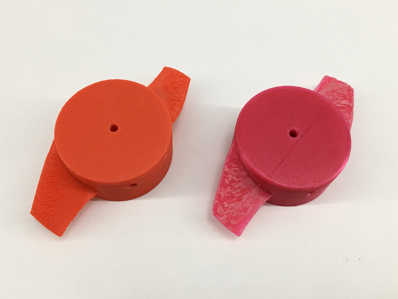

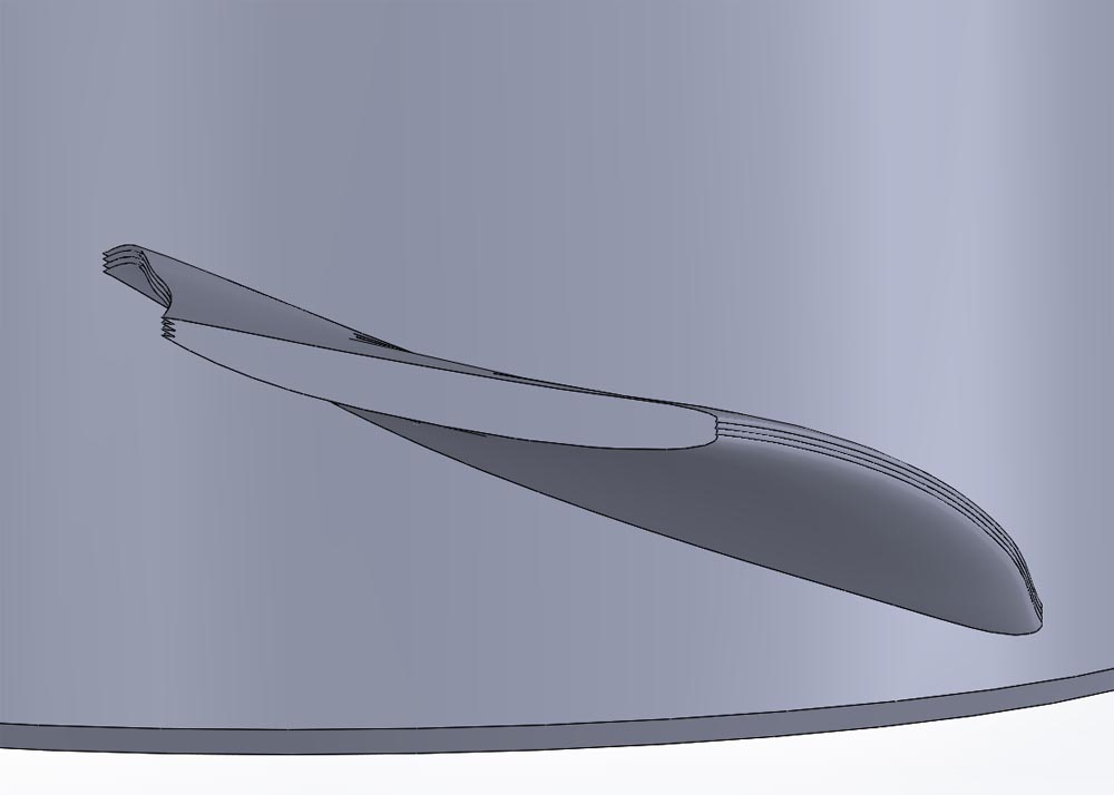

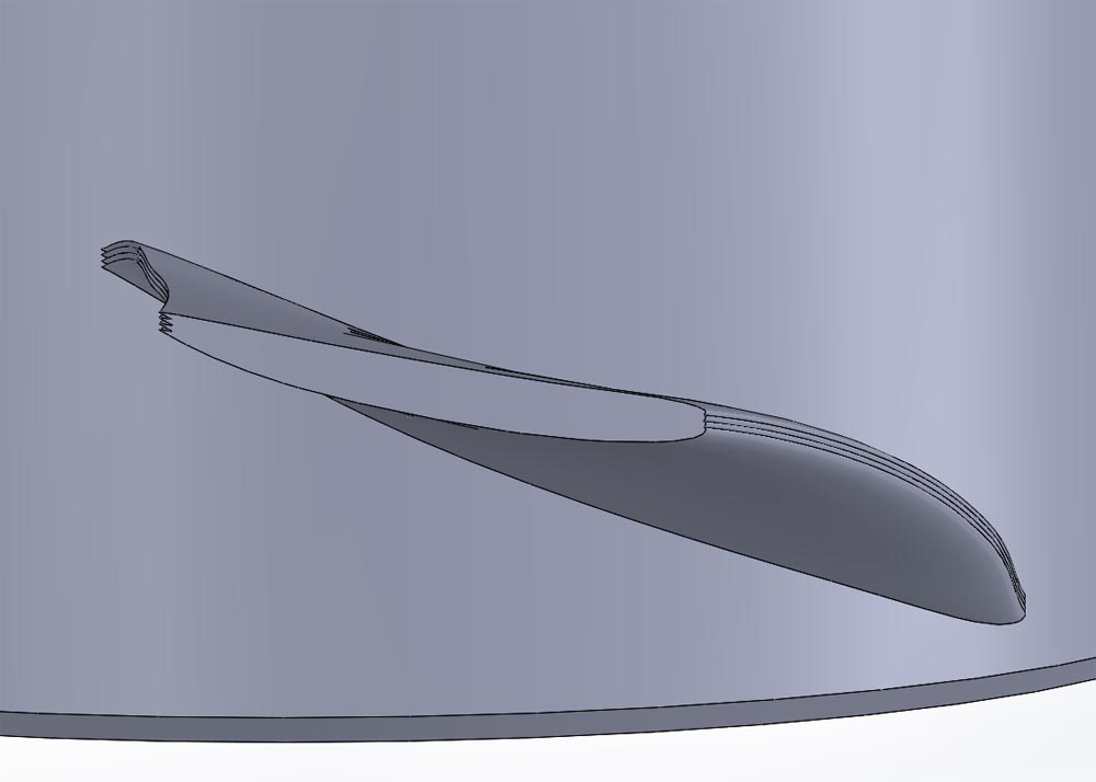

At this point I decided to make the blades thicker and see if that would help with the printing. I really don't have the CAD skills to redesign the angles on these blades so for now I basically just stacked several copies of them to make them thicker. The weird edge details will be ignored by the slicing software because they are so thin.
I printed this thicker version in both PLA and PETG and they came out a lot better. (In these pictures I rough sanded the PETG one but not the PLA one yet.)
I don't know if it will affect the thrust out put of the prop but it definitely came out better being thicker.
The PETG one is still a bit flexible so I'm going to test it first with the PLA version.

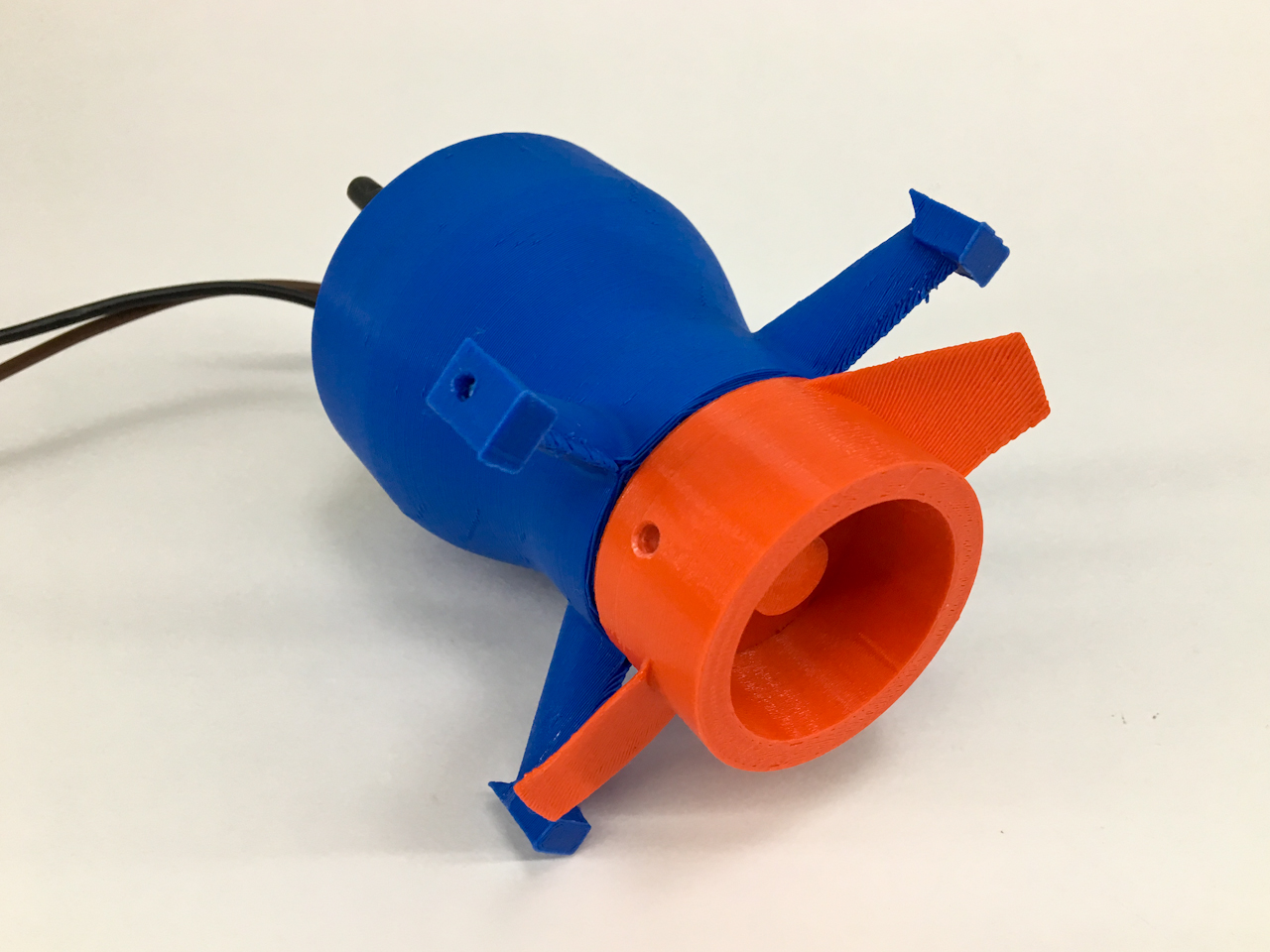

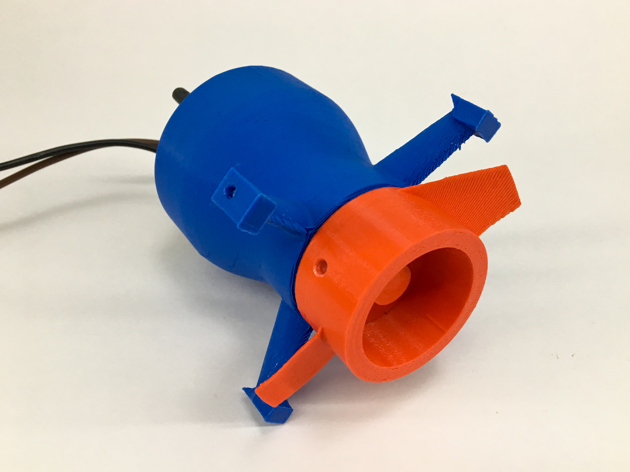

A few finished pictures before the testing process.

I didn't take any more pictures of the meters during testing or get any real accurate numbers because the results were a little disappointing.
Roughly.... this setup put out about 2lbs of thrust but at about 8-9 amps in forward. (reverse was about 1lbs at 5-6 amps I think :?) I thought about also trying the 3 blade prop off the T200 but that would probably only increase the amp draw.
Overall it might work as a budget thruster if you have a 3D Printer... I know people are printing the stock versions modified to fit other Brushless motors but this might also be a option for those people just looking for a basic on/off control of a brushed motor. My only concern is the amp draw might be a little to much for these pumps in the long run.
Anyway It was a fun project to try though I'll have to make sure it's ok to share these modified Blue Robotics Files before I post them.
