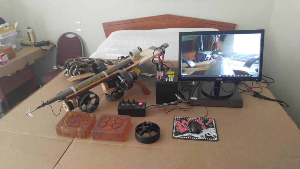

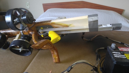

Hey guys, I need a waterproof solenoid that has about 1.0" throw to push the trigger brackets. I have lots of room to mount the solenoid to the frame. I designed the motor blades housing and made a mold as the picture shows. Let me know if you need one. The frame was made out of Bamboo. Cool Stuff! the ROV works well but as you can see need to change out the Speaker Wire for something better. Any ideas? Thinking about Sprinkler wire. The camera is a Home depot security system. Any better ideas for a camera? Would like to have it hooked up to a Laptop.

That's pretty crazy looking
but very cool..... I'm guessing lionfish hunter?
Just quick off the top of my head for the trigger... instead of a solenoid how about a cam attached to a geared motor so when the motor spins the cam pushes the trigger back? I did something similar on a duel mounted paintball guns a long time ago and it worked well.
