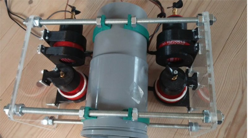

Top view of ROV
Top view of ROV

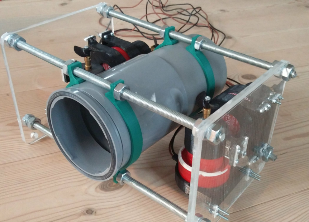

Isometric view of the robot
Back View
Back View

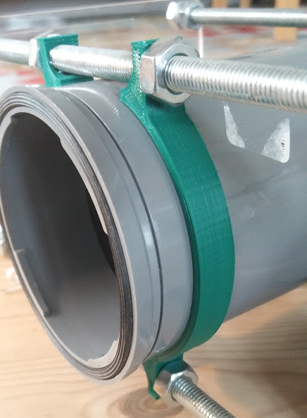

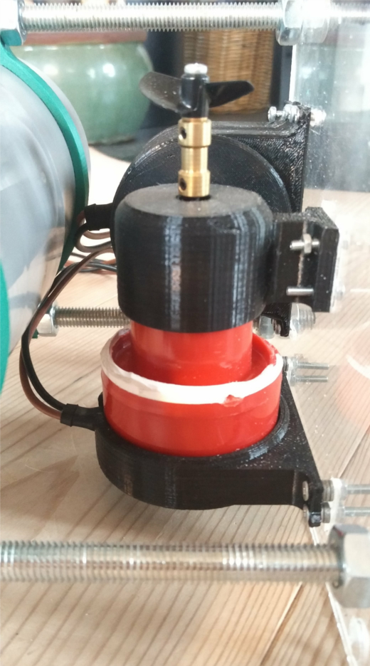

As you can see it has lasercut plexiglass side panels where the bilge pumps are mounted, and a hull in the middle where all the electronics are stored. The ROV has 4 bilge pumps, with the two vertical ones for up/down movement and the other two for forward/backwards and turning. The two vertical ones is probably overkill, but I couldn't find a way to position them with an imbalance of weight. All the green and black parts are 3d printed, so those are the parts that hold the motors and the hull in place. There are 10mm stainless steel rods that connect the whole thing together, I chose to do it like this so it could be modified easily.

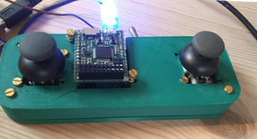

This is the controller for the ROV it's 3d printed, the PyBoard is clearly visible on the top, the two joysticks control movement and the switch lights.
Live video is provided to the surface through a USB webcam in the robot, this USB signal is passed through a 30M Ethernet cable and converted back to USB on the surface, there is no power increase or anything, you just plug it in and amazingly it works!

Closeup view of the 3D printed hull holders
Closeup view of 3D printed bilge pumps motor holders

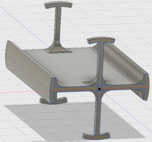

Hopefully the PVC pipes can hold the pressure. They dare not made for pressure from outside.

Yes, I hadn't thought about that but you're probably right, what I think I might do to counteract the outside pressure is 3D print something along the lines of this:
It will sit inside the hull and hopefully the 3D printed parts will support the pressure...? It will also serve as the "tray" to mount the electronics on. But I have no idea if this is a good solution. Any thoughts?

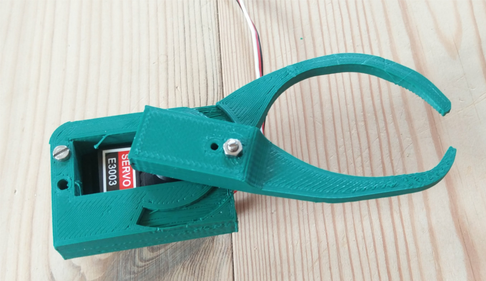

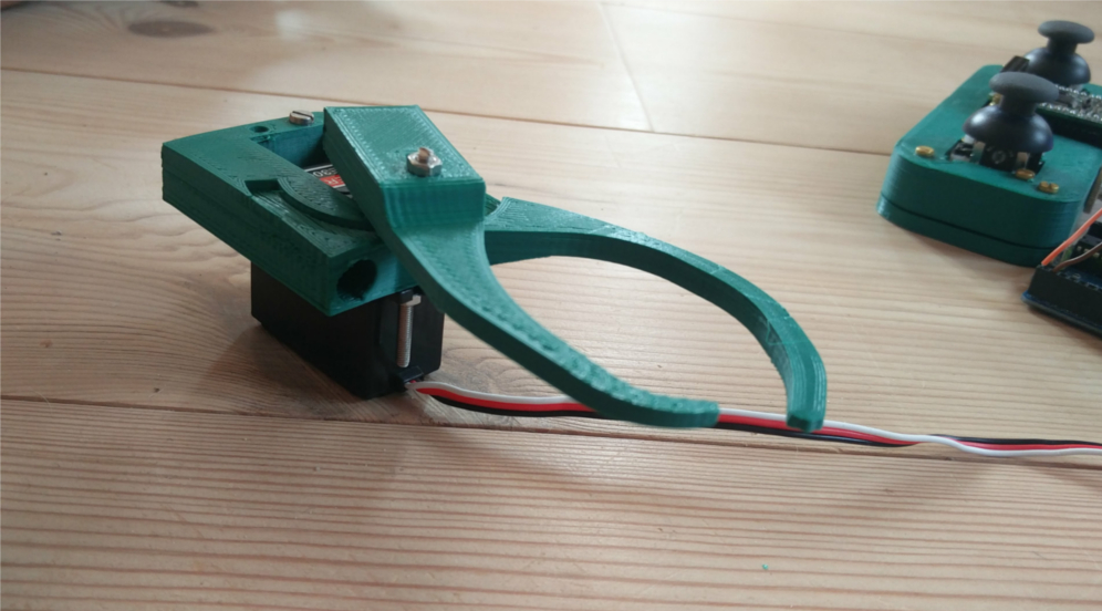

I've also made progress with the grabber, I bought a "waterproof" servo motor off aliexpress, I have no idea how waterproof it really is but it cost around 9 euros, and free shipping, so it's not the biggest loss if it breaks. I designed (with fusion 360) and 3D printed a sort of frame for the servo motor and the arm that doesn't move to sit in, and an arm that moves on top of servo motor. Everything's held in place with some M3 screws and nuts and here's a video of it in action! In the video the PyBoard is getting the value of the resistance of the potentiometer (the x axis one in this case) in the joystick, and depending if it's higher or lower then a certain value, i.e not in the middle, it sends the character 'U' or 'D' to the arduino which then movies the servo clockwise/anticlockwise respectively by 5 degrees.
And some photos
The idea is for an 8mm rod to go through the hole on the servomotors frame, and nuts to secure it in place and then I'll 3D print some parts to go attach the 8mm rod to the bottom of the ROV once I find a place where it doesn't obscure the footage too much but where you can still see what it's supposed to be grabbing! The grabber is actually surprisingly strong, and can easily carry a large screwdriver.
-Mantfish <><

I think you'll be fine with the pipe down to 30m no problem. water pressure is only 43psi at that depth.

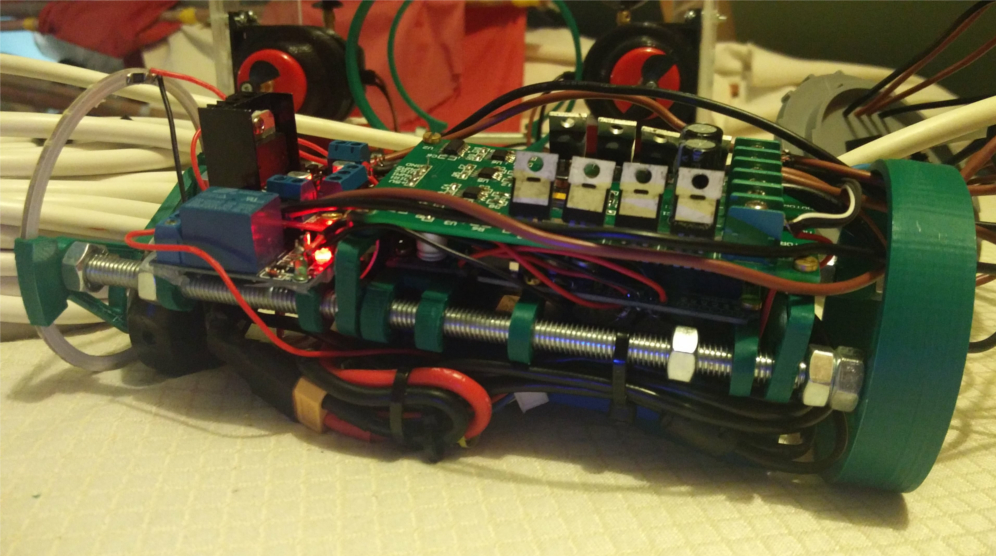

Since the previous post I've been working hard on the inside of the ROV

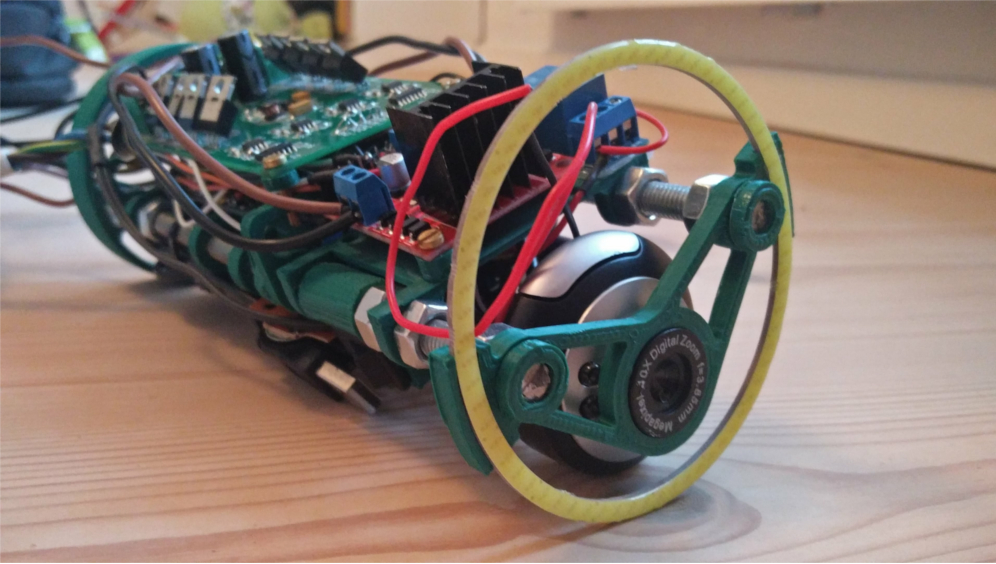

So far it looks like this, the led ring is a 12V LED car headlight circle, which is really bright and was very cheap, underneath it is the webcam. These are mounted on two 8mm steel rods that run from a circular base to the end, the idea is that all the electronics are mounted on these, and these rods are glued onto the back piece of the ROV which can be removed, so as maintenance and recharging the battery is easier!

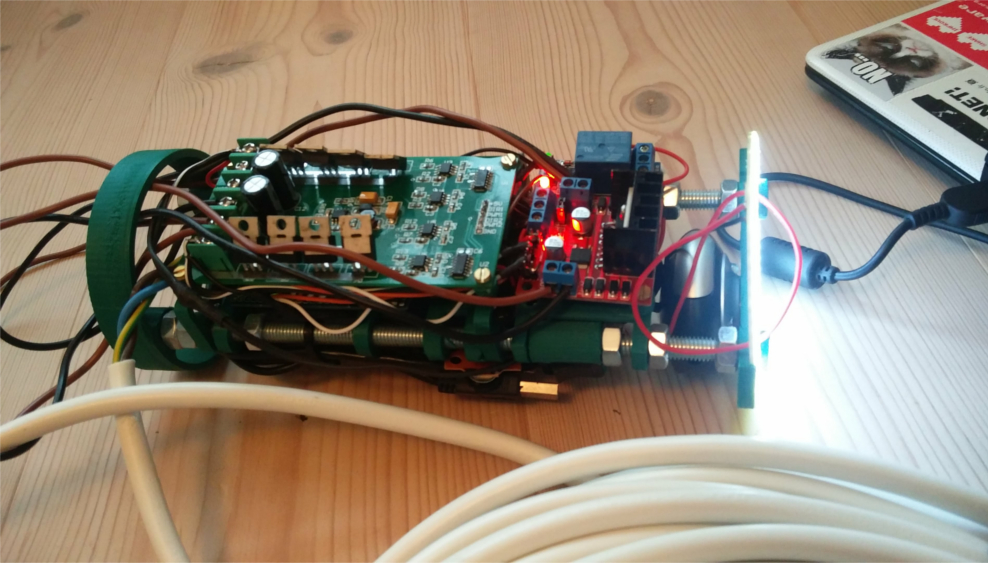

Here's a top and side view of the inside, the big green circuit board on the top is one of the motor controllers, underneath it is a voltage regulator and the Arduino, underneath it is the battery. Up front the second motor controller and a relay for the LED ring and the master on/off switch. This switch also means that I don't have to unplug the battery every time I want to recharge it, as all I have to do is turn off the switch and connect the charging station to the female port that I soldered on the side of the switch that the battery is soldered on to. I did this as in my experience you need to exert considerable force to disconnect the battery and it's port, and I didn't want to risk destroying the solder joins. The rather long USB wire of the webcam that has to be converted to Ethernet is wrapped around the battery and the entire thing does fit inside the hull, although it is tight!
Everything is working as it should and I'll soon post more!
-MantFish <><

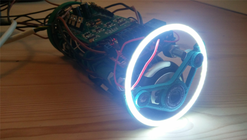

It's finally gone into the bath (and had a paint job)! Here's a video of it, everything is working well, I need to change some things though, the LED ring at the moment over saturates the webcam's image. I also need to come up with a nice solution to how to secure the float, as the float in the video isn't the final one, and how to store the bilge pump wires. So once again advice is appreciated!
Waterproofing surprisingly hard, I did what Steve suggests on his page with epoxying and so far it is working well, for around the acrylic in the front I used silicon.
Don't hesitate to ask for details!
