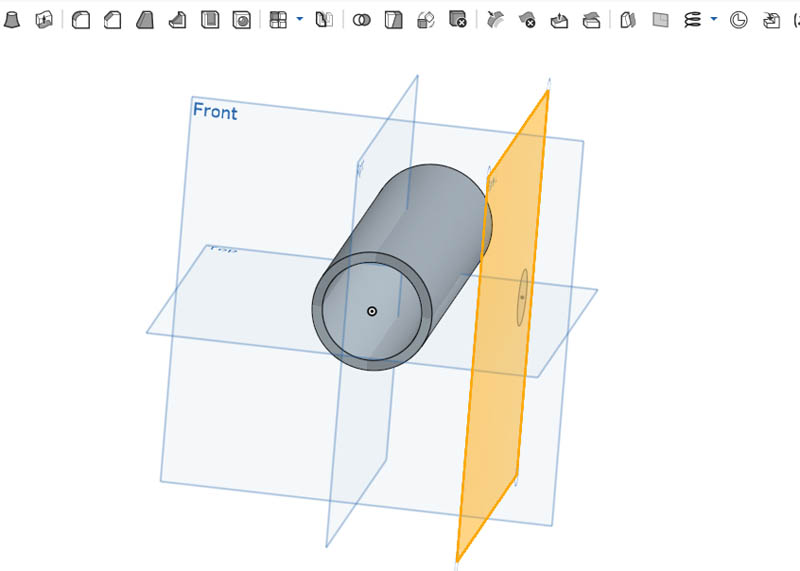

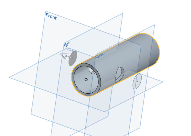

I've never used Sketchup but if it's like most CAD programs you can try creating an offsetting plane, then draw a sketch on that plane in relation to where you want the holes and then just extrude/remove. (terms might be different on Sketchup)
Something like this maybe.
Offset Plane to side + new sketch
Extrude/remove sketch to create hole.
You should be able to post the .skp file you just have to .zip it first.
