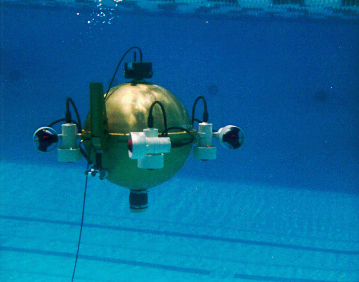

Image 1. Planned geometry/thruster layout
