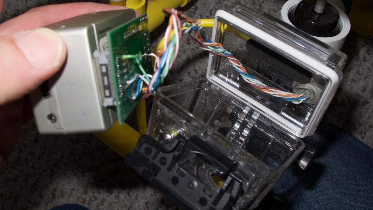

Hello HomeBuiltROVs,
I was wondering if anyone had any experience with working with GoPro camera cases that would
a. Waterproof the camera ends
b. Allow a way to mount the camera someway to the frame
Thank you! :D

Are you looking to go deeper than the included case the camera comes with or feed live video from the camera and need a way to seal the cable?
Re: GoPro: Waterproofing Solution
If you are looking to modify the existing case... i have seen a few examples of where they take the backpack door, and mounted a grommet in that. This allowed the 30pin connector to be connected, and extended outside the case to the control system.
Here is an example:
https://csumb.edu/eel/camera-system
breakout board in backpack space
gopro wetmount.jpg (95.77 KiB) Viewed 50176 times

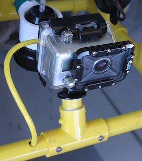

Final assembly!
Final assembly!
gopro wetmount2.jpg (15.6 KiB) Viewed 50176 times
Not my work personally... but I am a BIG fan of the idea!
